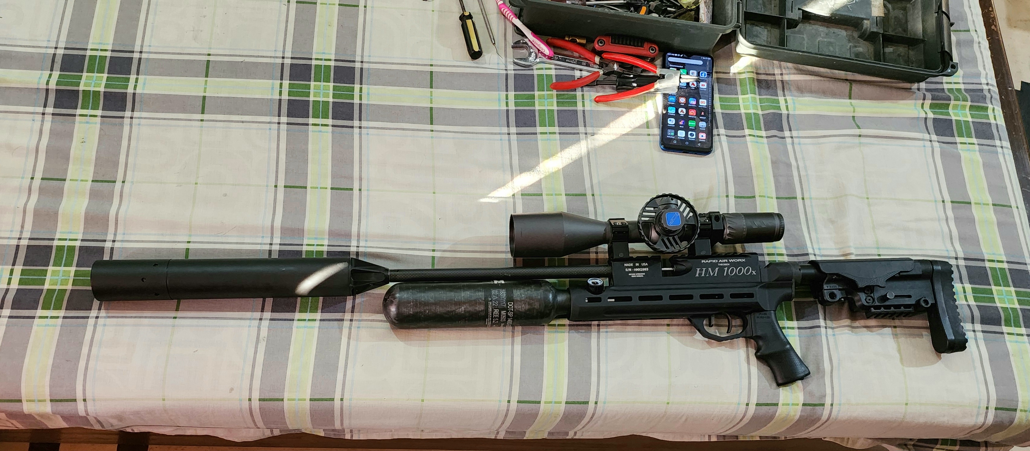

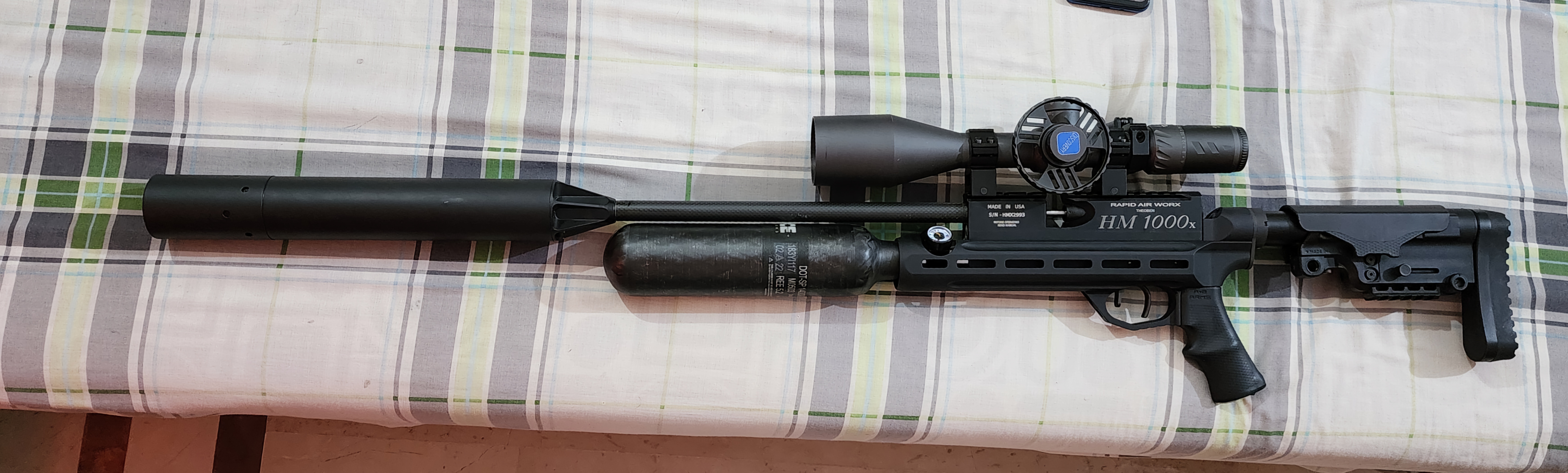

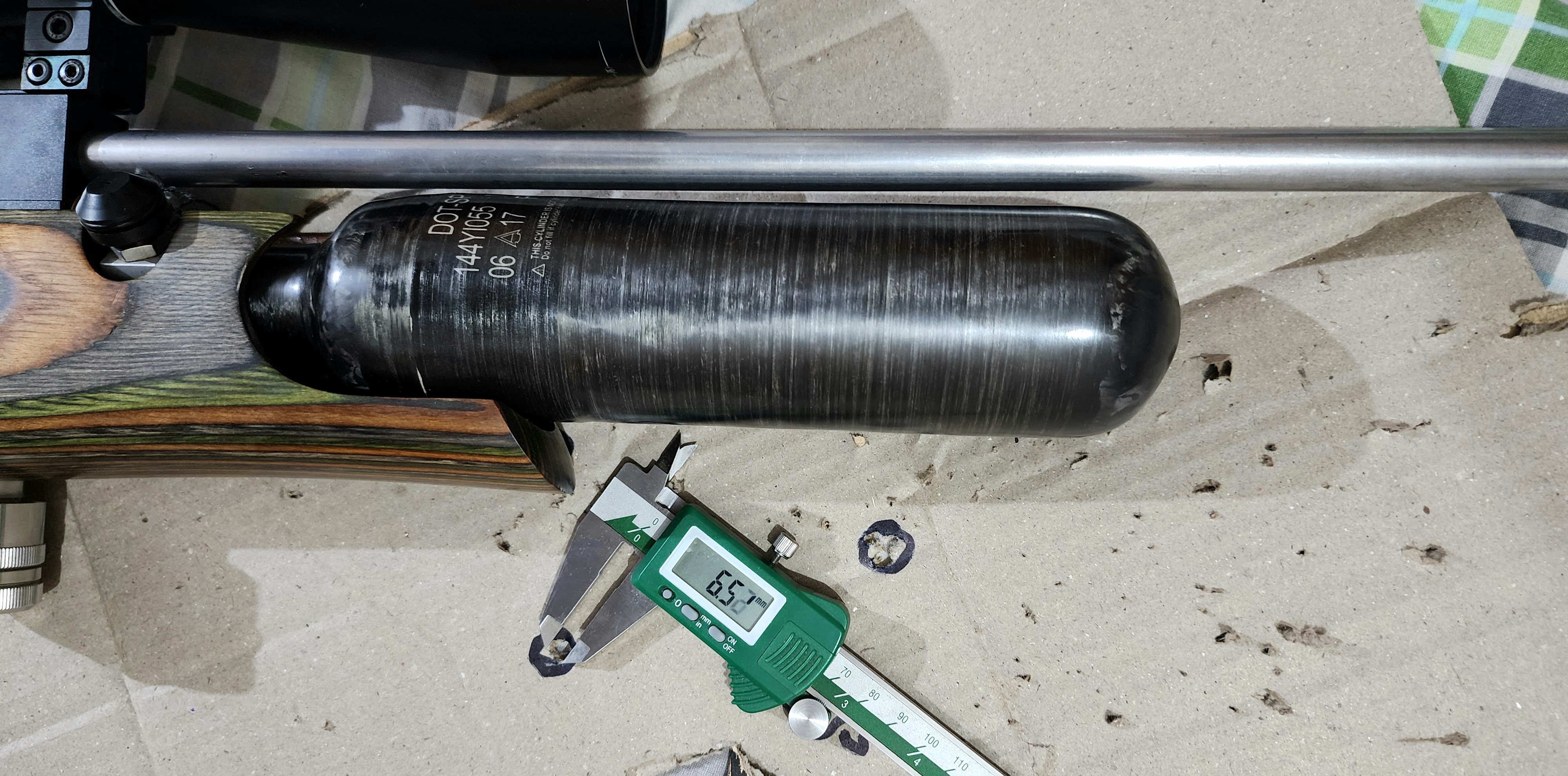

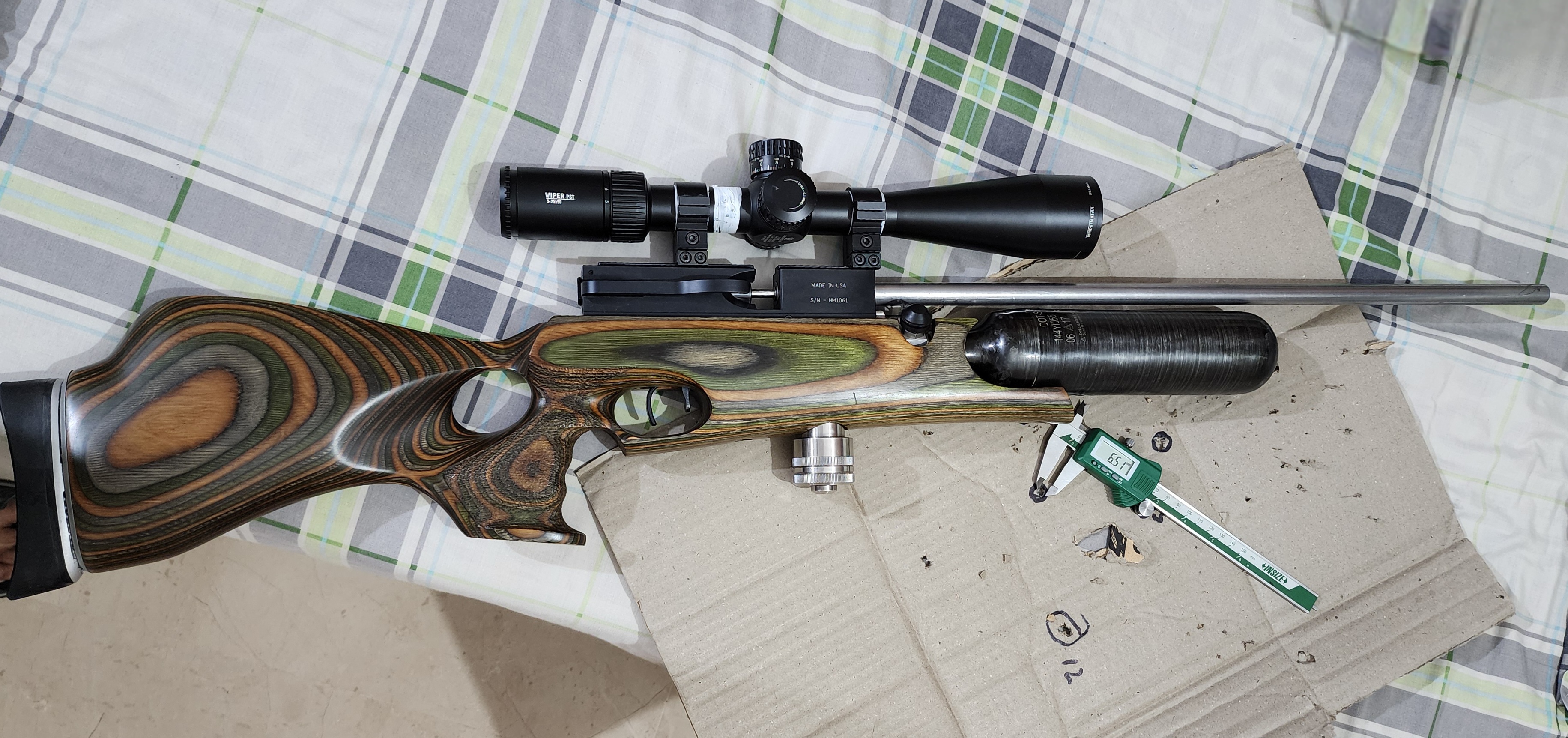

Finally, in order to achieve the required accuracy, the BSA hammer forged gradually choked barrel has been installed in the gun.
Initially I installed it in my RAW HM1000X for test purposes. Pics are here below.

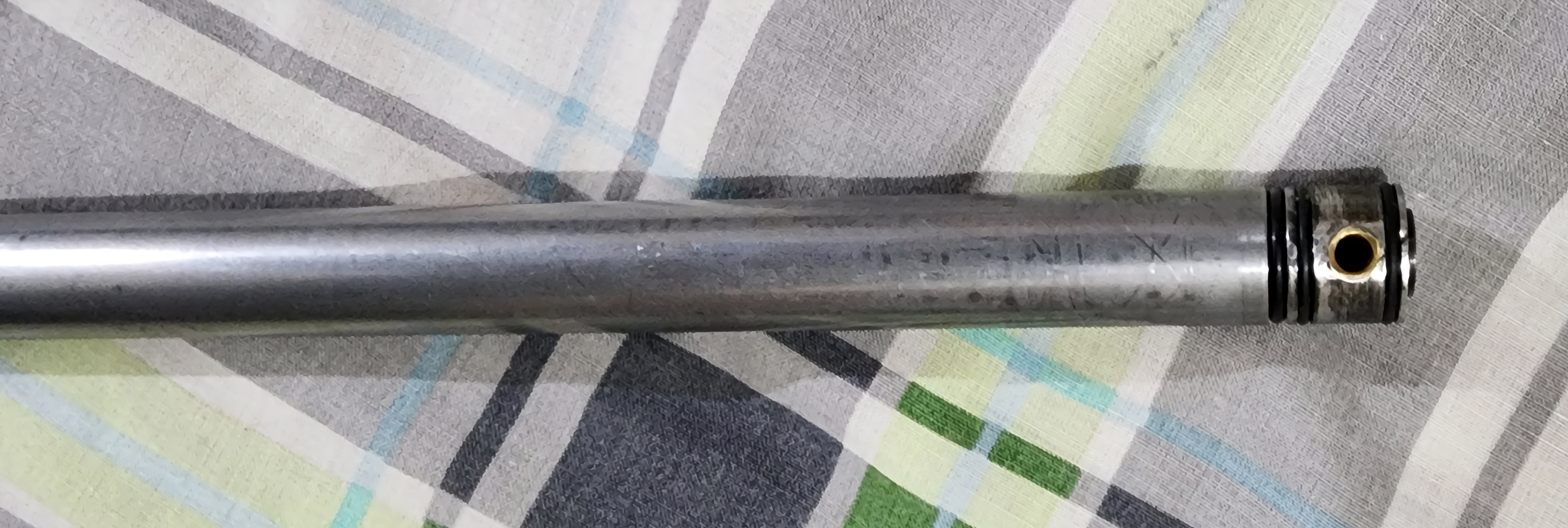

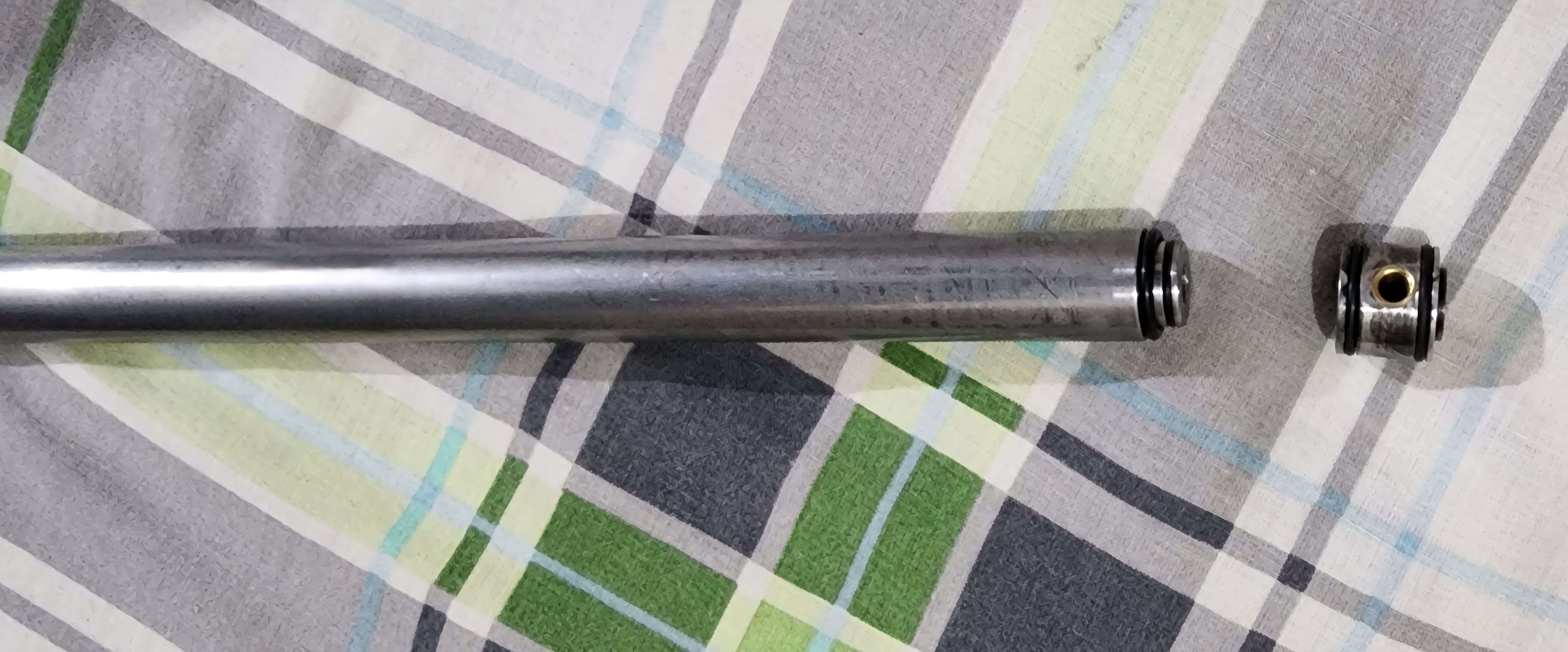

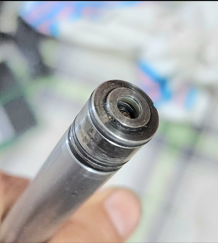

This system allows indexing of the barrel too.

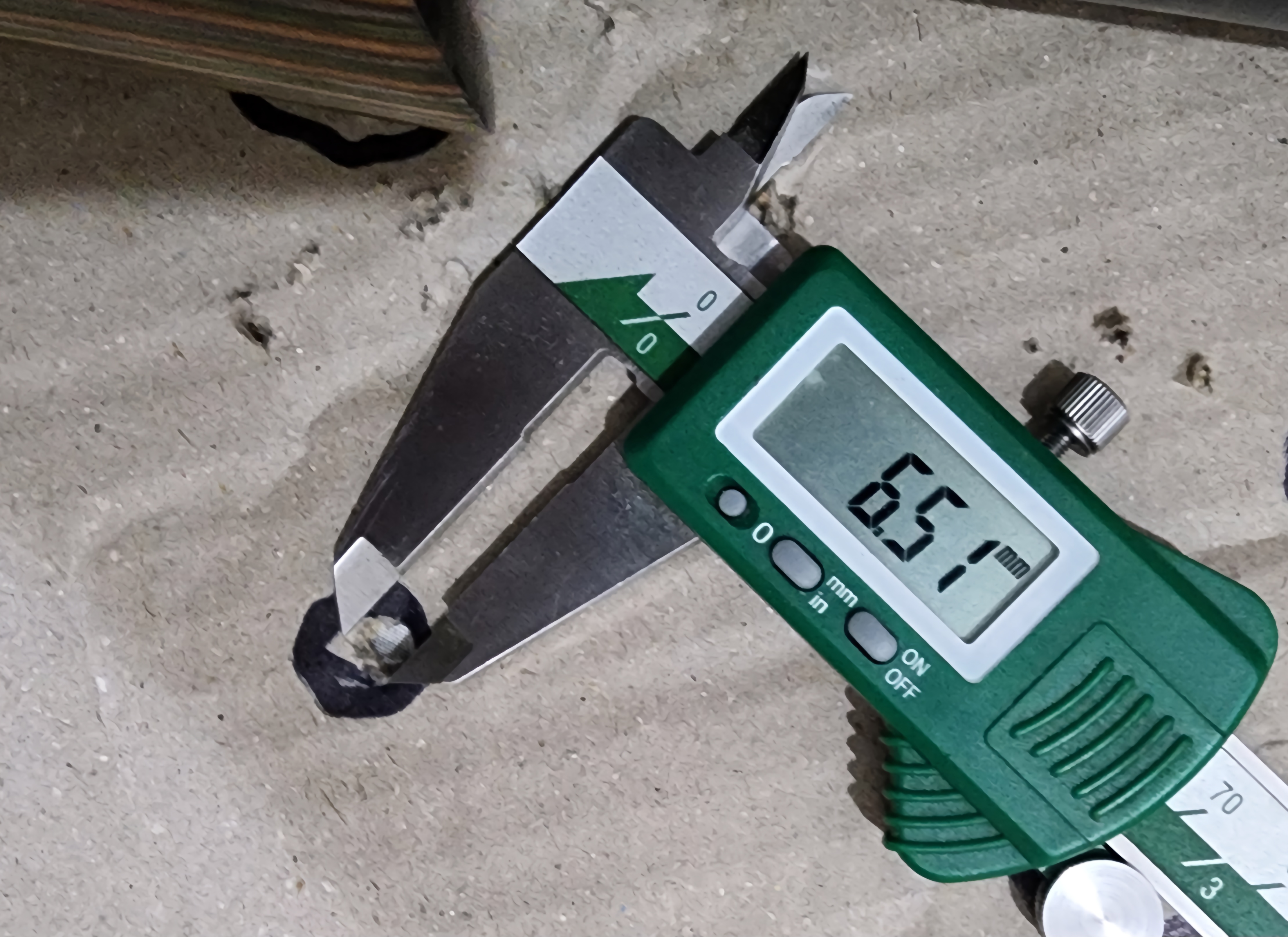

Following is the close up of 10 shots group at 24 yards at 950 fps using 18.13 grain JSB pellets. The outer dia of the group is around 6.51mm.

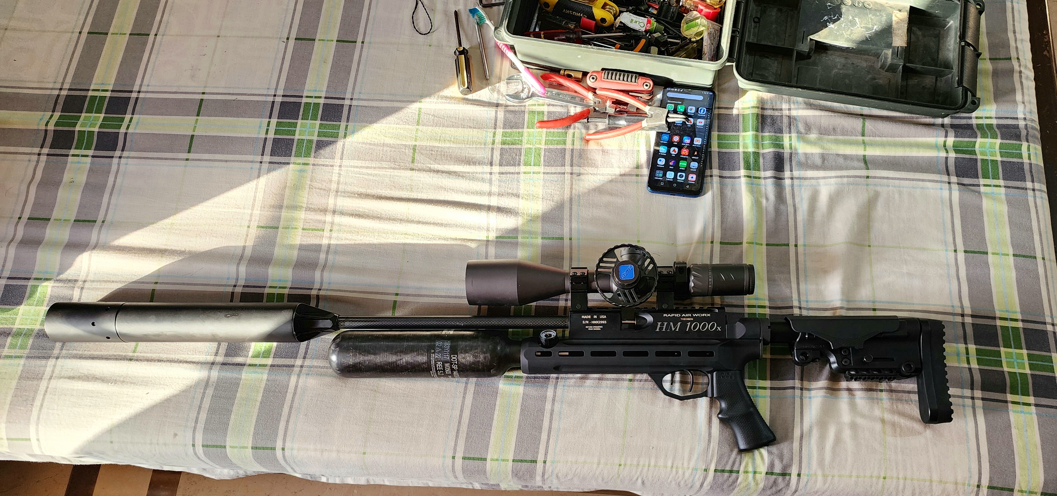

Following are more pics of the gun and also pics of indexable barrel system.
I have used O ring sealing system.
Long range accuracy shall be tested as we find a time slot.
