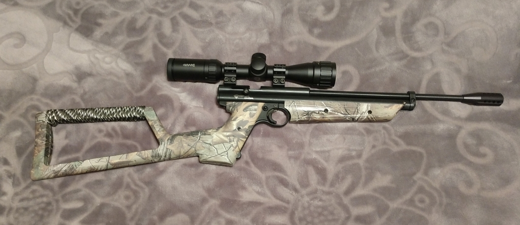

I have this little darling...
And I'd like to get it shooting closer to 11-12fpe. It is currently shooting at about 9.5 fpe (545fps with 14.3gr.) with 12 pumps.
Here is the catch though ....I don't wanna pump it more than 12 times. So is there anything I can do to boost velocity without having to add more pumps ?

I have a basically stock shorter barreled 1322 that actually shoots faster than this gun ....so that tells me that there IS a way.
