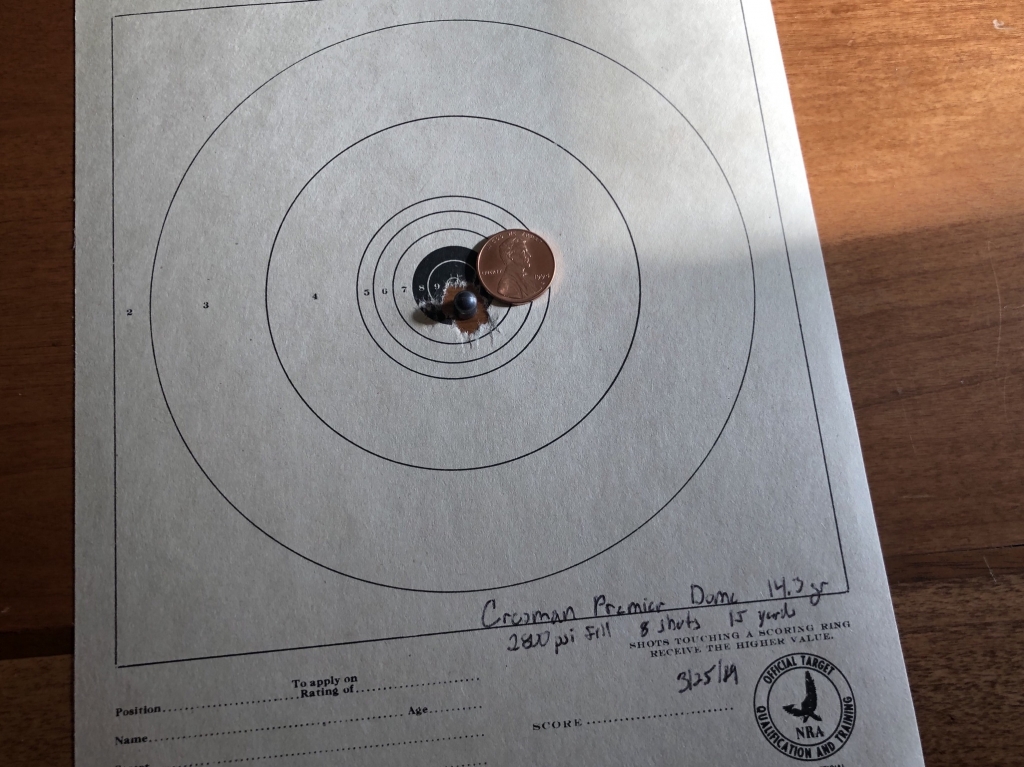

I just got a Prod a few months ago also. It’s my first and only pcp so far. I haven’t really had a lot of time to play around with it. Im just starting to learn the ins and outs of tuning a PCP. But I have noticed that my gun groups much better when I’m in that 2700-2800 psi range and under as well. I don’t do so well the the CPHPs. The Ultra Mags so much better for me. JSB 14.3 and 15.89 also do good, probably better and the 21 grain H&N Baracuda also did very well. I’m limited to only 15 yards in my backyard however.
With the Ultra mags my chronograph told me I was averaging 665 FPS for 14 fpe. This is my best group from last weekend. I’m sure others can do much better at 15 yards.

Nice! ImI in the same learning stage that you are, as this is my first PCP also. I knew right away that I wanted more FPE because the stock gun, although very accurate, wouldn't blow through a soup can at 30 yards. She'll blow through one filled with water at 60 yards now
