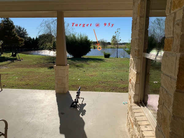

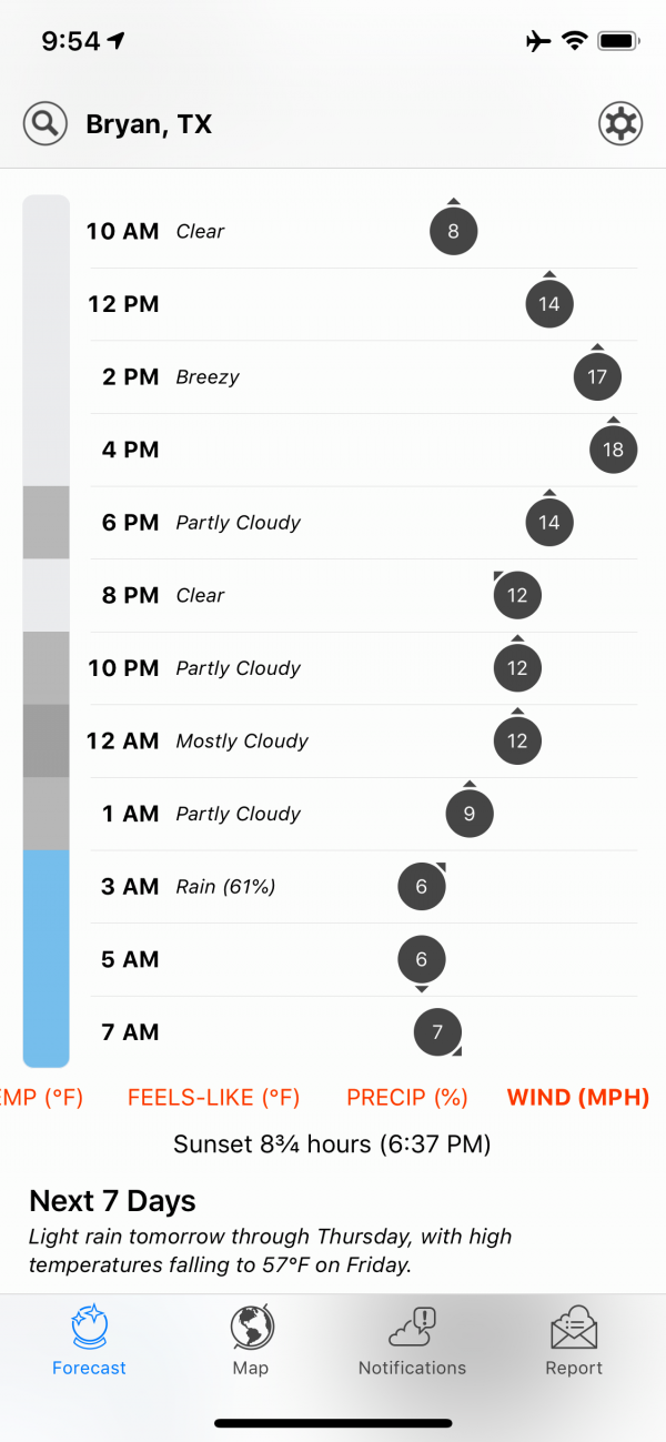

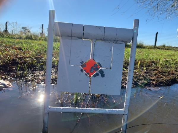

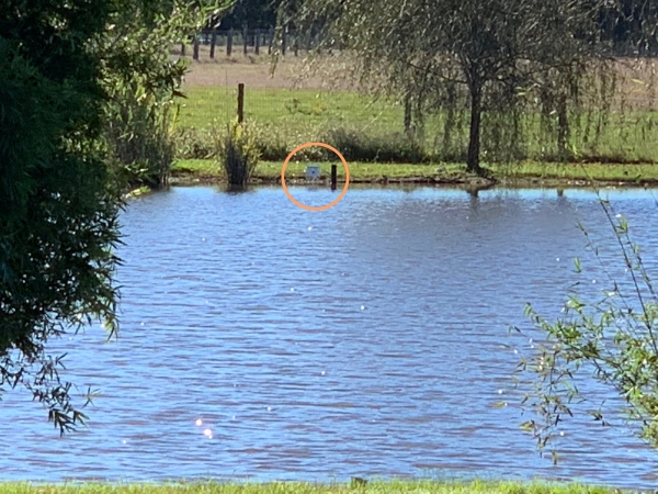

So after some thought - just about anyone can get online and say they shot whatever group on any day - here is the proof. I got up this morning and shot one magazine - 18 shots - at a freshly painted target, 95 yards on the other side of my pond. I took the first 4 shots to guage windage (group on left) and then set the next 12 in one group. Mind you, no bags, 6-12mph winds averaging to 8 mph (see screenshot of DarkSky). Whole group (including 4 warmup shots) is 2". And yes, I stood in 60 degree water to get that shot... you're welcome.
What this isn't saying is how great a shooter I am, it is saying how great a gun this can be when properly outfitted. Lots of guns can do this - but this one is mine! Again, thanks to all on this forum for helping me get this thing honed in so well!
