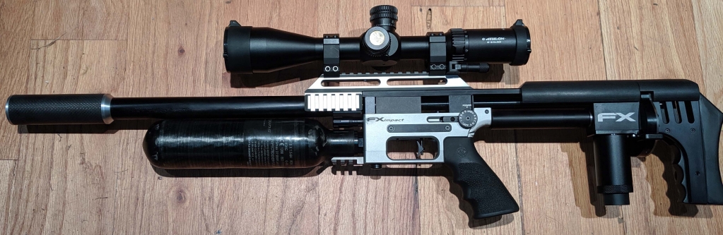

Nice lookin' Impact. I especially like the shroud and the LDC. Where did you acquire those?
Also, I had 2 of my Impacts modded for increased power, including the additional plenum yours features. I noticed on my modded Impacts that the original smaller grub screw that holds the pellet probe in place had been replaced with a larger grub screw.
Good luck with getting yours back online.

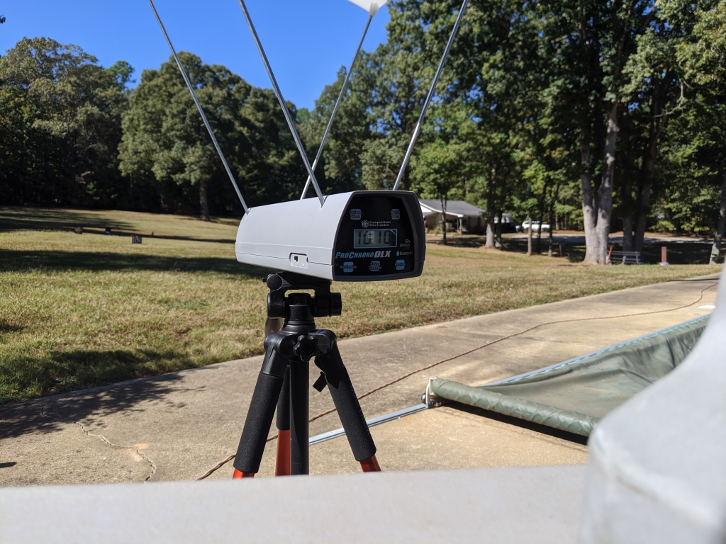

So I got my Impact parts today. Lined up the back of the probe hole (it's somewhat elongated) with the back of the hole in the barrel. Sharpied it. Put the gun back together and 'timed' the sharpie mark. Finished reassembly. Charged it up. Setup the chrony and loaded a mag.
1010fps from a .30 44.75gr JSB.
Second thru 5th were in the high 980s. So yea, it suffers a little from creep.
Decided to take the FX Tech's advise and turn it down some to be in the 930s. Power level 2 was right there.
