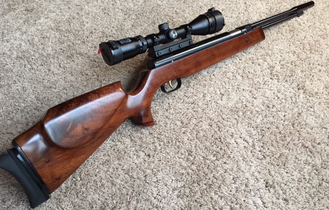

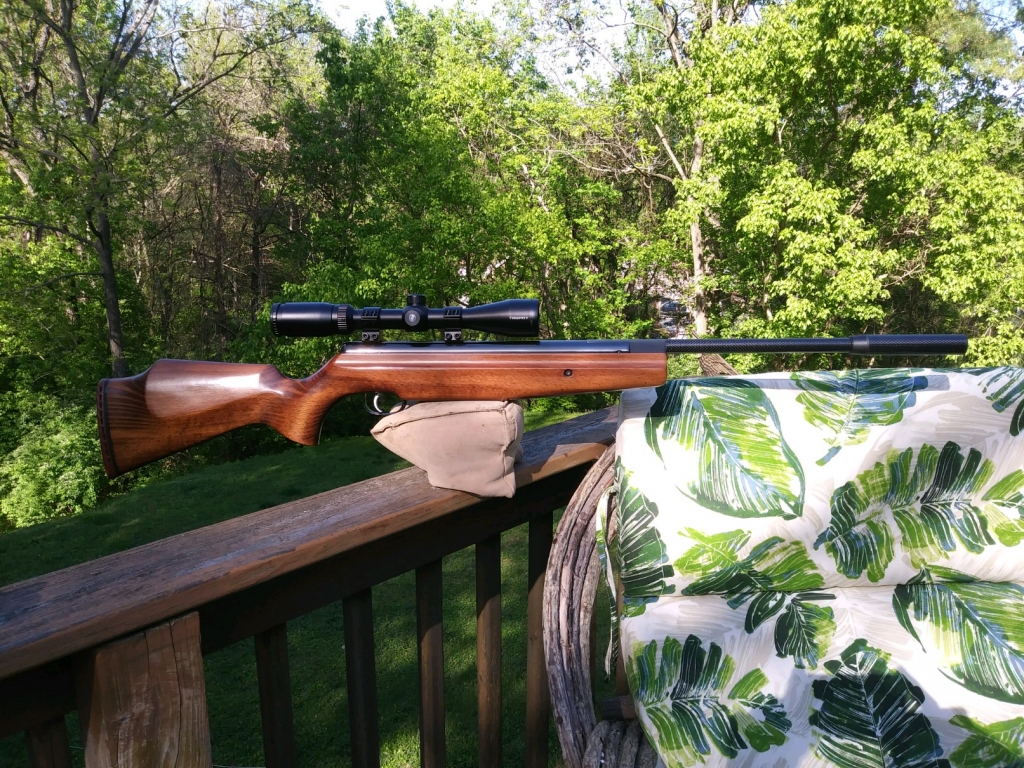

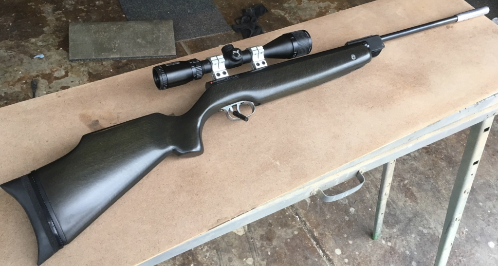

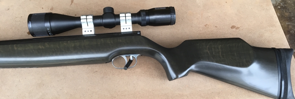

So, there has been a bit of chatter about the new jsb .20 caliber pellet recently released. I went through a 20 phase but lack of choices steered me away. I did, however, keep an R1 and R7 barrel in .20. Though I don’t think the new JSB 20 cal is a great springer pellet, it did get me thinking about the .20 platform again. Hankering for a new rifle but not finding anything I felt like shelling out the cake for, I decided to make some changes to current stock.

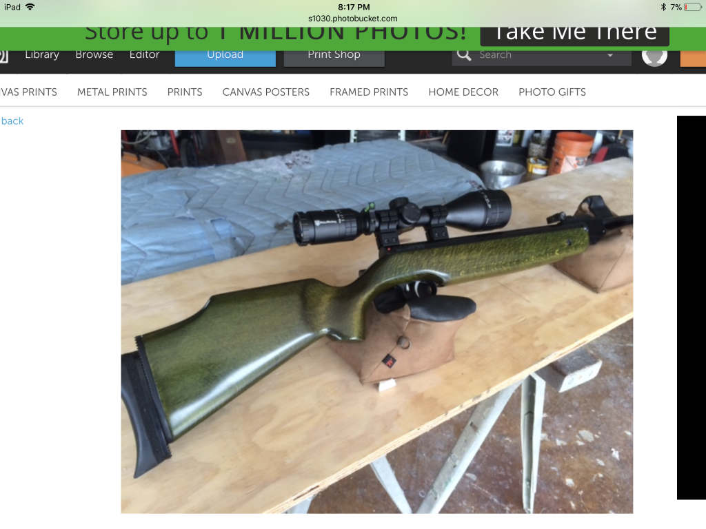

Years ago, I refinished my R9 with some deep penetrating green water based dye and clearing it with lacquer. Well, I didn’t give the dye long enough to dry thoroughly and within 6-9 months the lacquer cracked up. This provided the perfect candidate for redo of a redo, so to speak.
I stripped the ruined lacquer and knew the green dye would never be removed without copious amounts of sanding. I was okay with that because I was going for a different look (as I was with the choice of green dye)... I stained the beech stock black/brown over the green dye and finished with two part conversion varnish in satin sheen. I highlighted with silver accents and even polished the oem trigger guard to near chrome. I changed out the 177 barrel and used my R1 barrel in .20 cal. After a good scrub and polish with JB bore paste, the gun is quite accurate with H&N FTT at 760 ish FPS.
I reshaped the stock a bit and a few other goodies but I guess I just wanted to say that sometimes you can get that “new gun feeling” by just changing what you have already. Don’t get me wrong, I still love new guns...😎

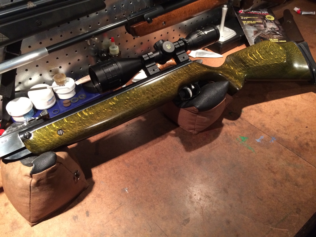

What it looked like after the first resto. The next two pics are from the the first refinish when the green water based dye was the only color used. It penetrates very deep and can be very hard to undo. You would have to aggressively sand the stock to get rid of the green.

Way to go T-man! It looks fantastic.

That looks awesome Brett! What a nice looking rig. That looks like a fun gun to plink with for sure. I like that you added finger grooves in the grip.

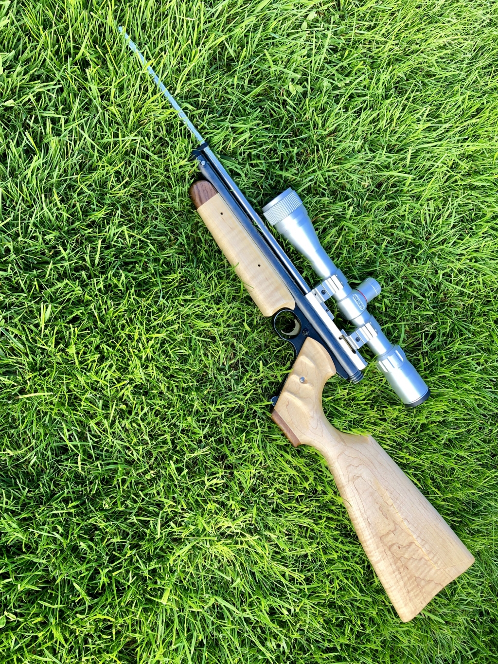

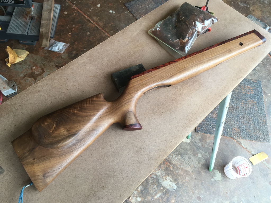

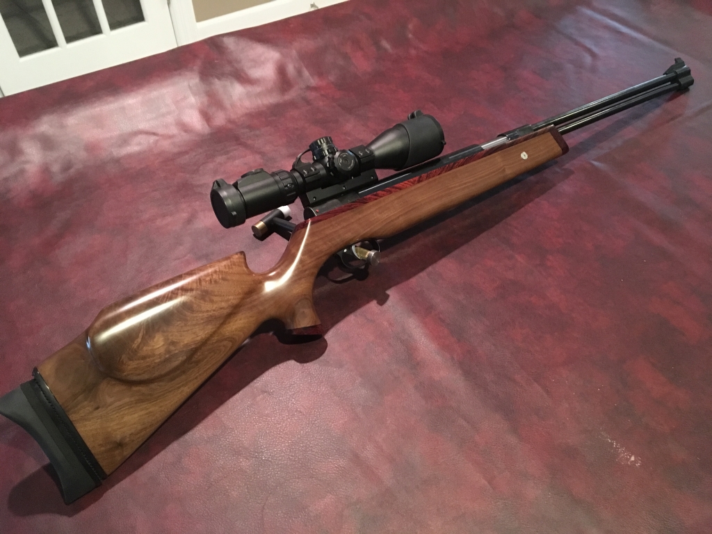

I just finished another redo of a stock I made a while back. It’s walnut with cocobolo highlights. When I originally made it, the forearm was too shallow and too much of the rifle stood out of the inletting. It’s bothered me ever since I made it and the stain I used was a bit too dark. I added more cocobolo to the top of the forearm and finished it in a natural color. For a little bit of amber color, I used shellac flakes that came from India (Long story). Shellac flakes are actually flakes of resin secreted by the Lac bug found in India and Thailand. You dissolve them in denatured alcohol and use it as finish. It’s not very durable so I just used it as sealer and some color and top coated with several coats of catalyzed lacquer.
I could really use a setback trigger for this Hw77, the reach is a bit long...my bad...
Thanks Tim! It is a good little plinker. 3-4 pumps @ 10-20 yards is just perfect. Those pellets aren’t going to be setting any speed records but those targets don’t know the difference. Ha ha!
ok, now what you have there.... both of those pictures look awesome! I would take either one. Maybe that’s a before and after? I do like the shiny finish... It’s almost too perfect looking. You do great work Tim!
Thanks Brett, the first pic is the finished product. The lighting and background are not good so it does distort the color a bit I need to steel your idea of taking a picture in the grass, that’s a great idea .
The second pic is the stock wiped down with paint thinner only just to have a look at the grain. It had just been sanded so the wood is as light as it could ever be. It had no finish at this point. The shellac added some color and with time the walnut darkens on its own. The color changes quite quickly especially when exposed to mild sunlight. Too much ultraviolet light and it can bleach the color out.
This is a pic of the old color and before adding wood to the top of the forearm;

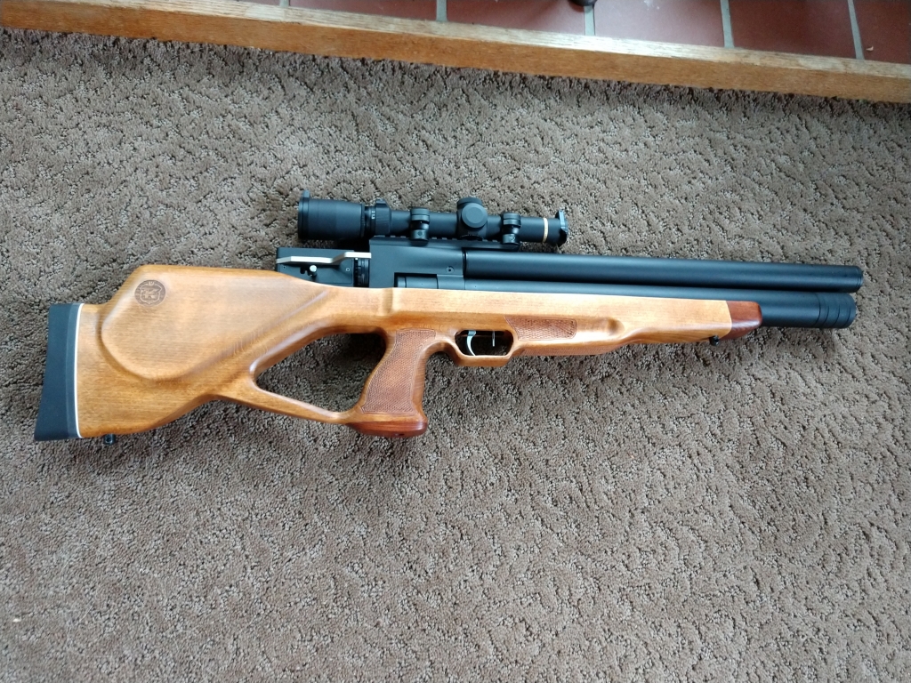

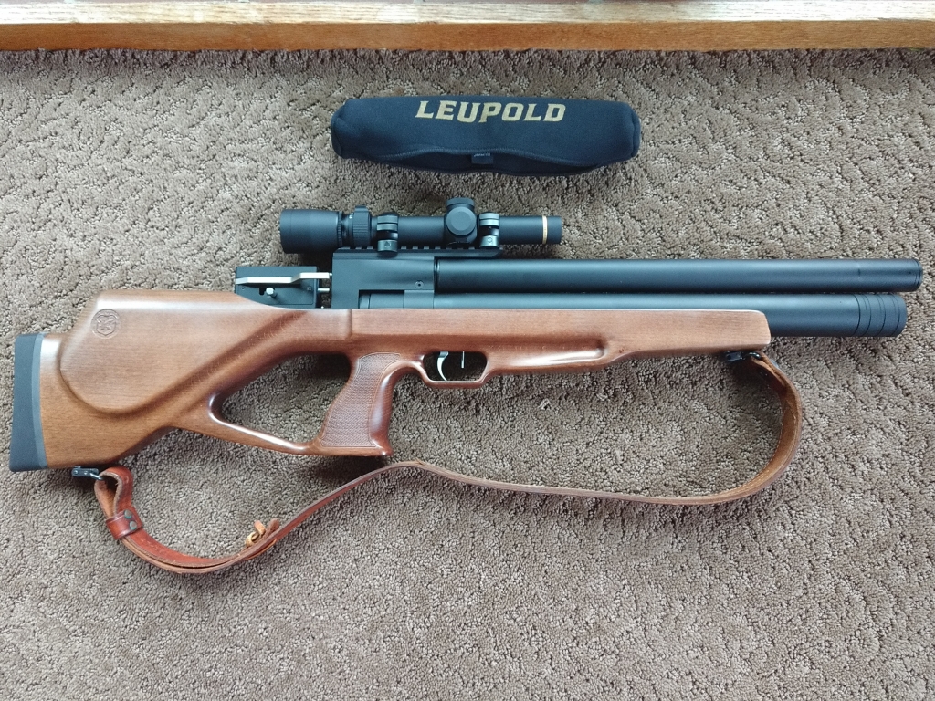

Well, looks like this post is right up my alley.I just completed a stock refinish on my Kalibrgun cricket mini carbine. I really like the style of the stock, but
never liked the factory mud colored stain.
So I sanded it down and added some rosewood decorative caps, stained it with a stain mix of 70/30% walnut & mahogany stain ,and added some checkering.
I like this look better to my eyes. And it does kinda feel like having a new gun, sorta.
After...and.... before
