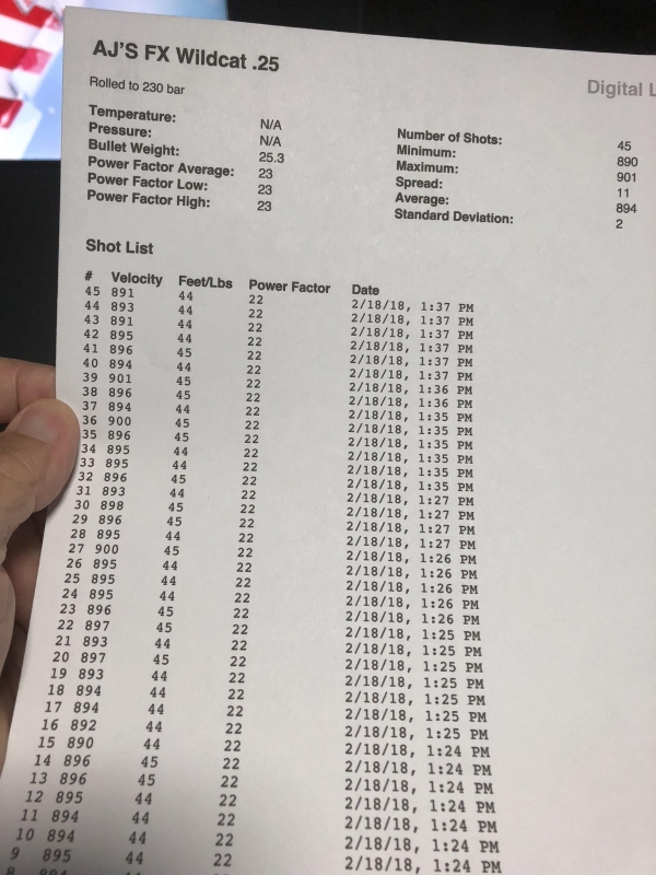

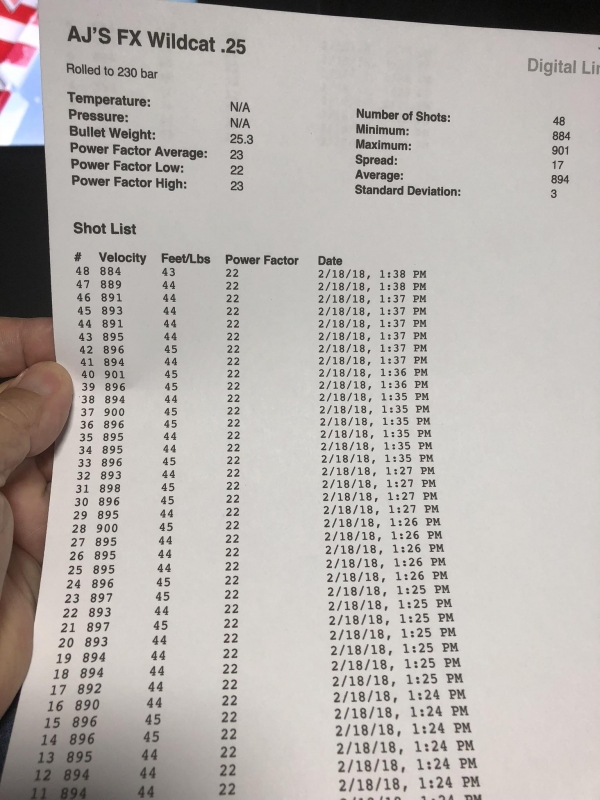

I have owned 2 Wildcats, a .25 cal and a .22. I’ve heard so much about the Huma reg that I too ordered one but haven’t installed it yet. Let me show you why. This is a 48 shot string I did after filling to 230 bar. I usually waste 3 shots to allow the gun to settle in before using the chrono. But this time I did not AND I shot until it started falling off the reg. Shot 47 was 889 and shot 48 was 884. Even counting these my spread was 17 and SD of 3. I then dropped my first shot along with the last 2. So look at the second picture first. I was hoping the 48 shot group would be at the top and the other at the bottom. You can see now I have a spread of 11 and SD of 2. Can the Huma be that much better? Also I shot 46 times before it started dropping off the reg. I also believe that if I were hunting iguanas that shot 47 & 48 would have hit its mark. That’s efficient!

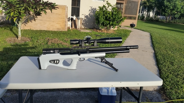

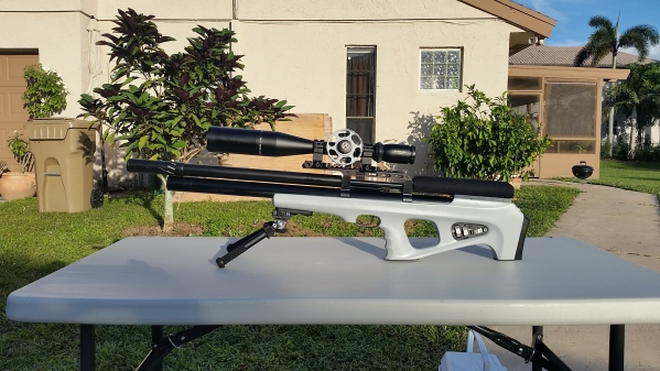

Here is couple pics of my Wildcat so you can see how the picatinny scope rail, Atlas bipod, and J.P. Brewer mag holder looks. You will also notice I sanded down the bottom of the pistol grip and butt stock so they sit flush and level to make her more stable and less tippy on the bench. I took over an inch off the bottom of the butt and 1/4" off the bottom of the pistol grip. Then I added a slim layer of rubber bicycle inner tube to the bottom of both the grip and stock to make them non-slip. I also added a piece of 5mm thick neoprene to the cheek rest to make it more comfortable and non-slip. In the summer that black cheek rest would get hotter than a firecracker in the Sun.This should give you a few ideas...
All the best, Chuck
