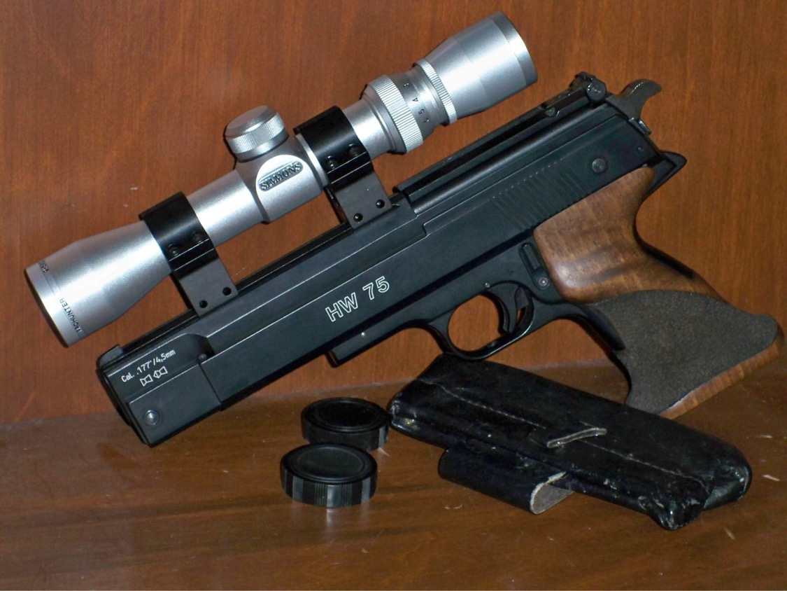

Love mine. If you want to put optics on it eaglevision has a 13mm to weaver adapter that works great. I put a mini reflex sight on mine.

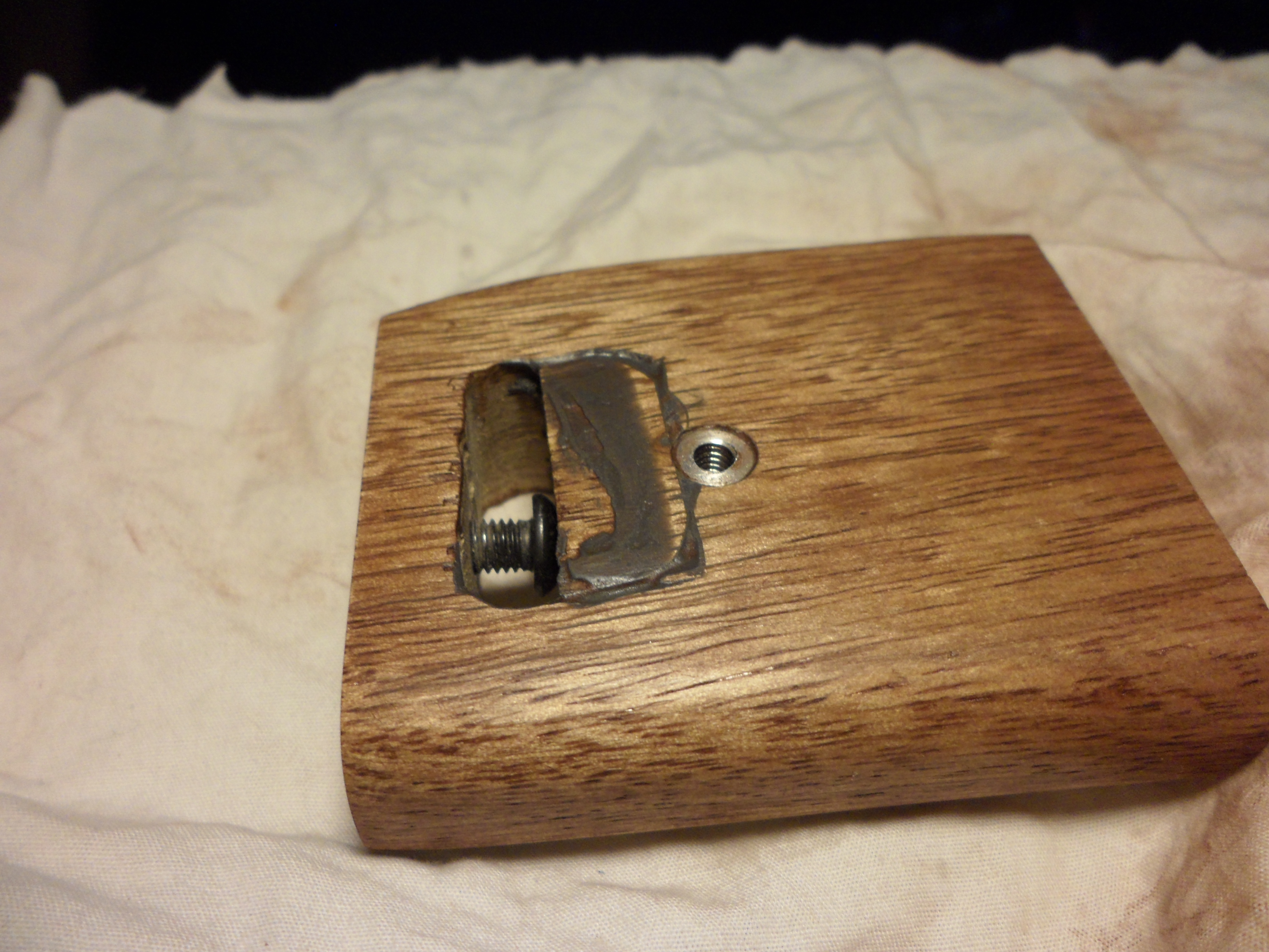

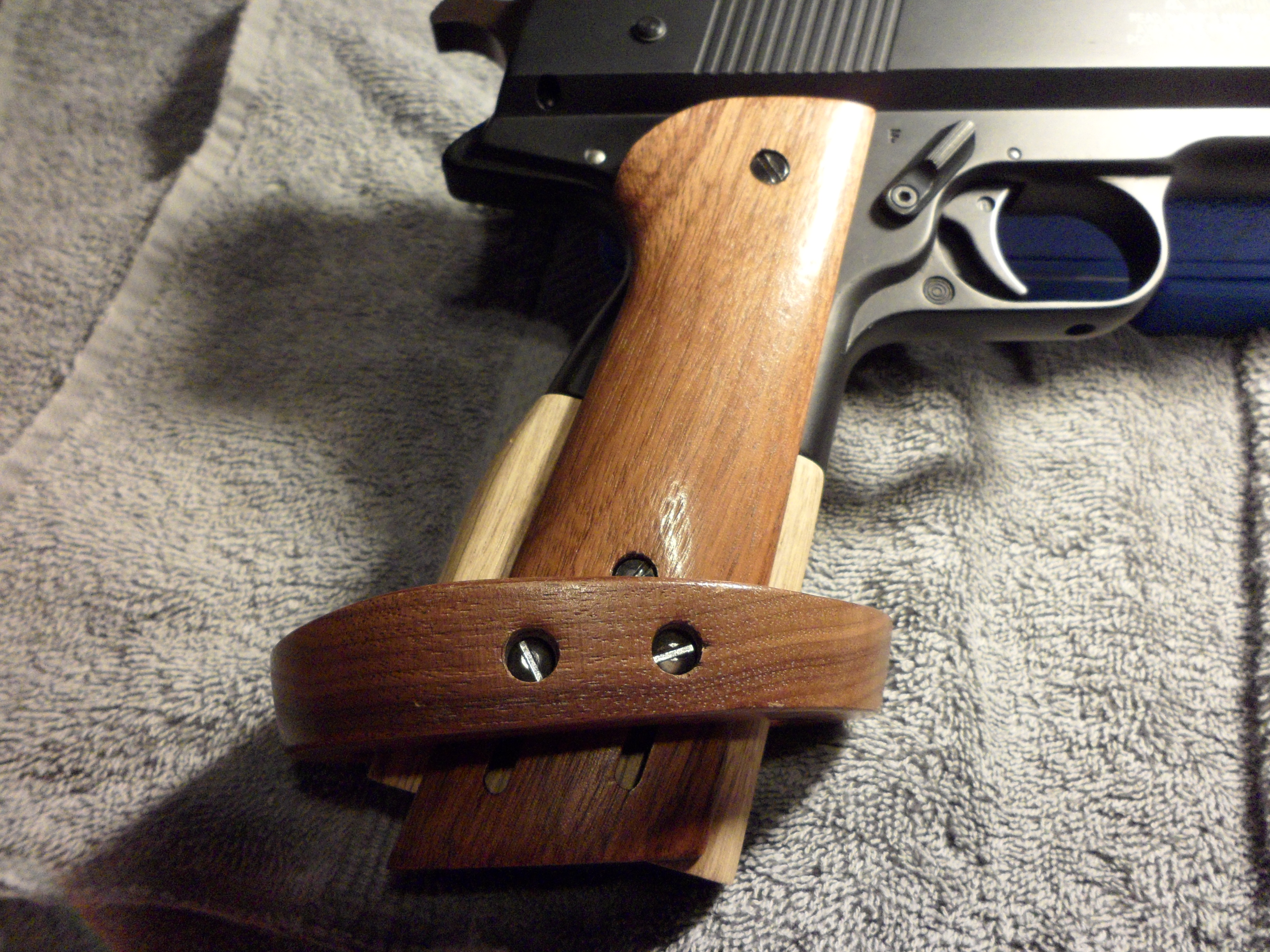

a month or so ago on a UK forum there was some talk could the half frame HW75 be made into a full frame and that was an interesting idea so myself and the poster started the project and i got a just on him because i had what i needed
so i made one out of wood
i left them long and proof of concept was over

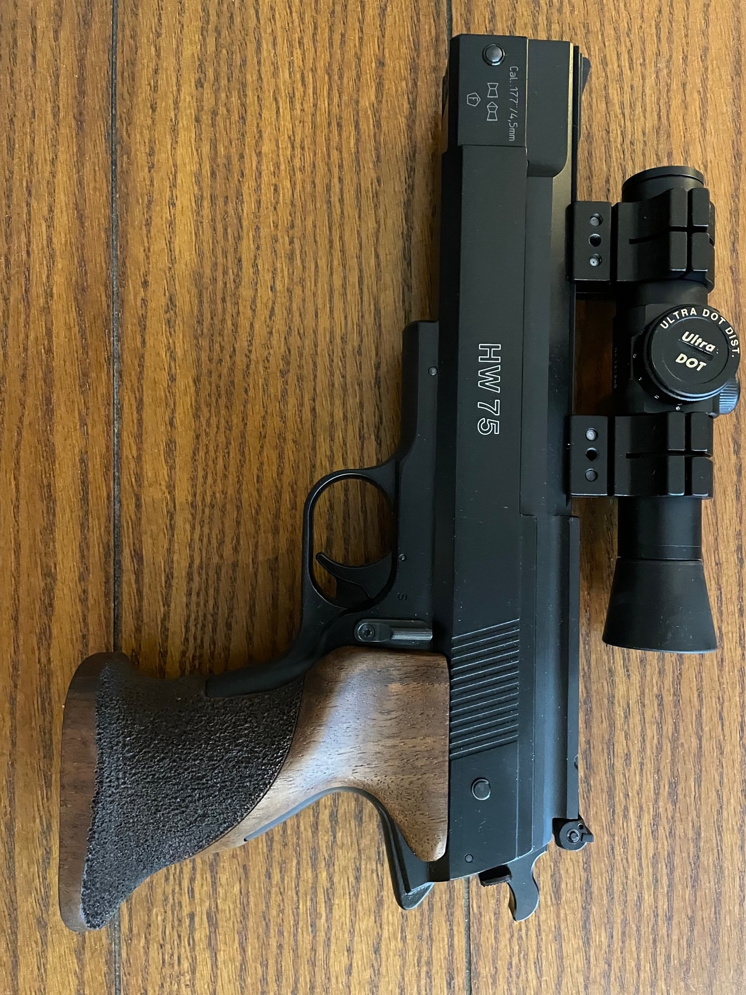

If I got the right link you can see I reported on it on the What Pistol Did You Shoot Today.
But I wasn't completely happy with the Burris Fast Fire so I put on an Ultra Dot and I like it much more.
Sure, it is big and heavy, but with the light trigger it just hangs on target as I break the shot. I love the design and craftsmanship of this pistol.
