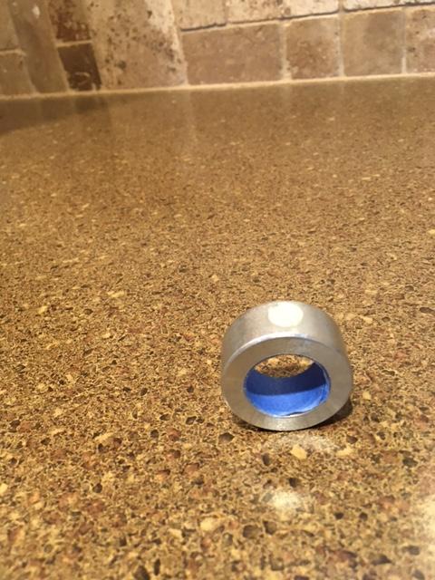

I made a tool for the SK19 .25 to make barrel re-alignment a no-brainer, but never got to test it before I sold the gun. I mic'd the od of the SK barrel with the shroud removed. I went to Ace Hardware and bought a shaft collar slightly larger than the od of the barrel. I lined the id of the shaft collar of with blue painters tape and replaced the metal set screw in the shaft collar with a nylon one, also from Ace Hardware.
To use, remove the shroud of the SK19, and BEFORE loosening the barrel, put the shaft collar over the barrel against the barrel mount, and tighten the nylon set screw. Remove the barrel and clean. When you are ready to re-assemble, just slide the barrel in carefully until the shaft collar is against the barrel mount, and it be right back where it was.

You can use a simpler method of a wrap of blue painters tape around the barrel,where the barrel meets the barrel clamp, before loosening it. When done cleaning just slide the barrel back until it’s right in front of the clamp, and the barrel will be back where it was. If one really wants to get technical, make a mark at 12 o’clock on the painters tape with a pen, and you can put that mark at 12 o’clock again so the barrel will be indexed to where it was, as well.
