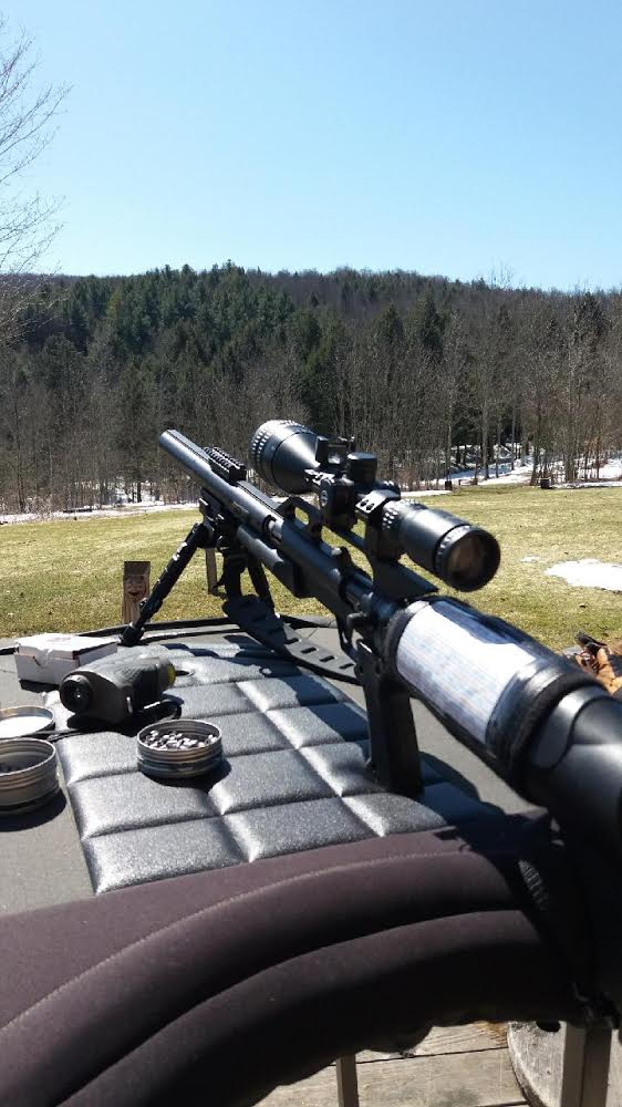

I have a different gun but the scope is set very high over the barrel also making close shots very difficult. I was thinking of puting a red dot scope on a 45 degree angle off the rail and sighting it in for the really close shots. But right now i just set my power to 4X and put targets evey 5 feet and sight in with the correct mildot holdover and made a range card that i attached to the stock with a Football quarterback wrist playcard band. Works like a charm. You can see it on the picture. Sorry if this is not what you were thinking. Let me know what you do so i can try it too.
the range card would probably be the most accurate solution ill try to make one when i get a chance, some day i might buy a mini red dot and give that a try. for now i tried tilting it and pointing by looking along barrel but theres a picatini rail there that was stilll more accurate than looking thru hole under top picatini rail thanks for the tips guys
