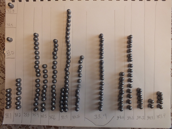

So, I just got a PelletGage. I had several piles of different weight pellets from a single tin before and now those several piles are sorted into even more piles by head size for all those different weights.
How do you guys manage, consolidate and store them?
I don't competition target shoot. Just paper, pests and plinking. I'm thinking, once I determine what head size my AA Pro Sport .22 likes best, those head sizes furthest away from ideal I could consolidate together, especially when there's not many of each.
For that ideal head size, depending on how many there are, I could consolidate with those of the next best shooting .01mm difference.

I have recently purchased some two ounce screw-top tins, and labelled them with the brand, caliber, and head diameter. I put them in the tins after sorting. I wish JSB would use a screw-on lid - but these are not expensive, and they are made of aluminum so they don't rust.
https://www.amazon.com/gp/product/B00YZ866CE/ref=oh_aui_detailpage_o01_s00?ie=UTF8&psc=1
During the sorting process, I have some plastic bin boxes that are handy to put the pellets into as you check them. There are a big variety of them at Harbor Freight stores. I put a little paper slip into the divider segments to keep the sizes straight.
