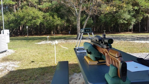

Every time I target shoot at home I use it. I use the Gen 2 Caldwell and just set it on the table in front of me. Easy to do, so I just bring it out. Once in a while I get a funny shot or fall off the regulator and I can see it immediately.
When I previously used my other chrono with a tripod it was a little bit more of a pain. I drove tent stakes into the ground as markers for the legs to try to speed up/repeat the setup. The Gen 2 works well with only1.5 foot in front of the muzzle.

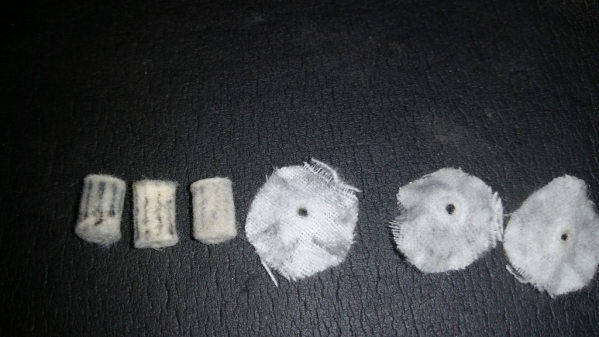

I was just talking to another forum member on how my RAW .25 was getting erratic with more flyers than I should have. After chasing MY tail...... I have always used a fiber rod with a nylon patch tip (no metal in barrel) with good results in all my guns. I decided to order a Patch Worm kit and do the really hard cleaning just like Steve did on the AEAC video.
The picture above is my plugs after a regular cleaning was done. The patch and felt plug pulled through a lot harder and showed the dark black line of the rifling. Within a few shots the gun just tightened up and shot perhaps as good or better than it ever has. I was actually shocked that it worked that well.

I have the Caldwell G2 as well. Man I love that Chronograph. I just plug it in to my electrical outlet with the handy adapter that comes with it, sit it on the end of the picnic table the long way and blast away. Don't have to worry about batteries ;-) Not geek savvy enough to use the smart phone app ;-)

"Dirte"Every time I target shoot at home I use it. I use the Gen 2 Caldwell and just set it on the table in front of me. Easy to do, so I just bring it out. Once in a while I get a funny shot or fall off the regulator and I can see it immediately.
Dirte
Exactly how I have mine setting.

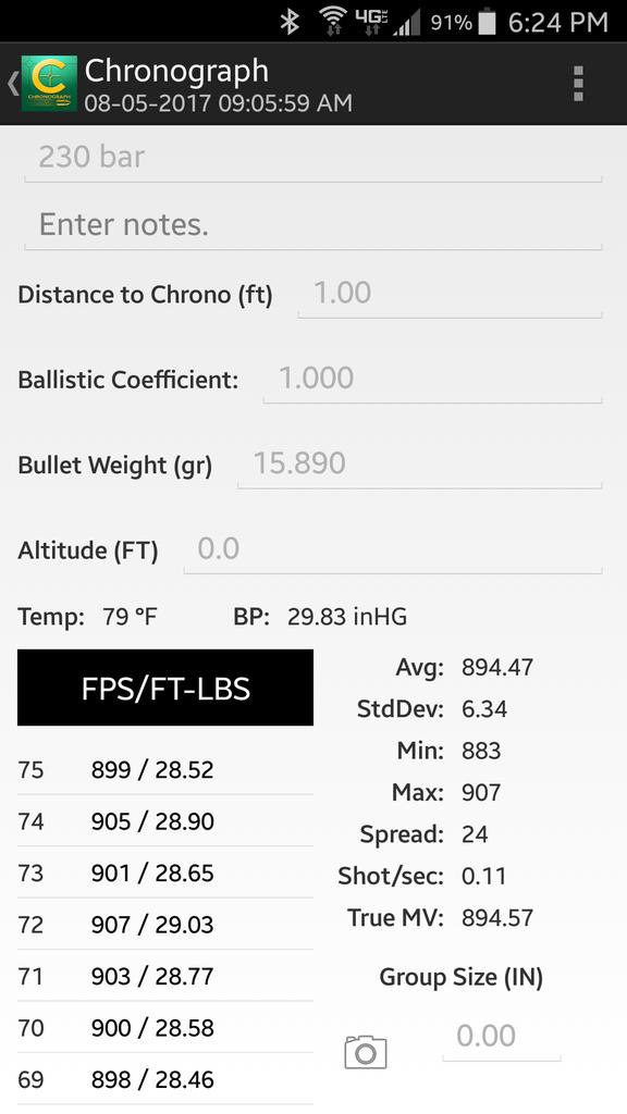

The app is really works well. I have had good success with it on an Android.
