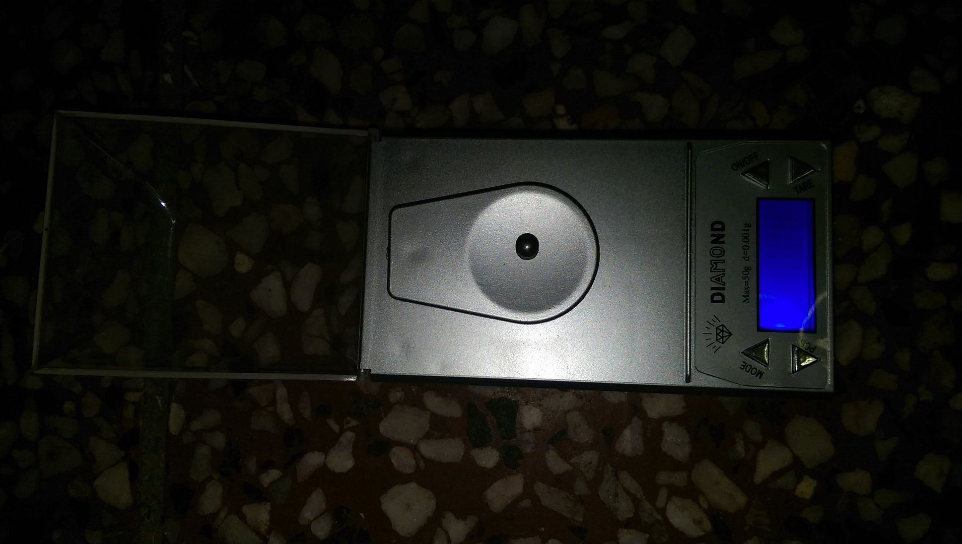

I finally got my scale which weighs precisely to 0,001 g and I was shocked when I started weighing .22 JSB Jumbo 15.89 gr pellets in 5.51 mm. I checked the scale vs. another one that weighs to 0.01 g and it checked out. This is what I got:
I don´t know if you guys can see what´s on the scale because of its stupid blue lighting but the extreme spread is 1.059 g - 1.008 g = 0.051 g or in grain 16.34 - 15.55 = 0.79 gr.
I wondered why my point of impact sometimes shifted vertically and the next pellet (my rifle is not regulated so it fires faster with every shot) sometimes even hits lower - now I´ve got the answer, The extreme spread in weight is about 5% - now that is REALLY significant...
