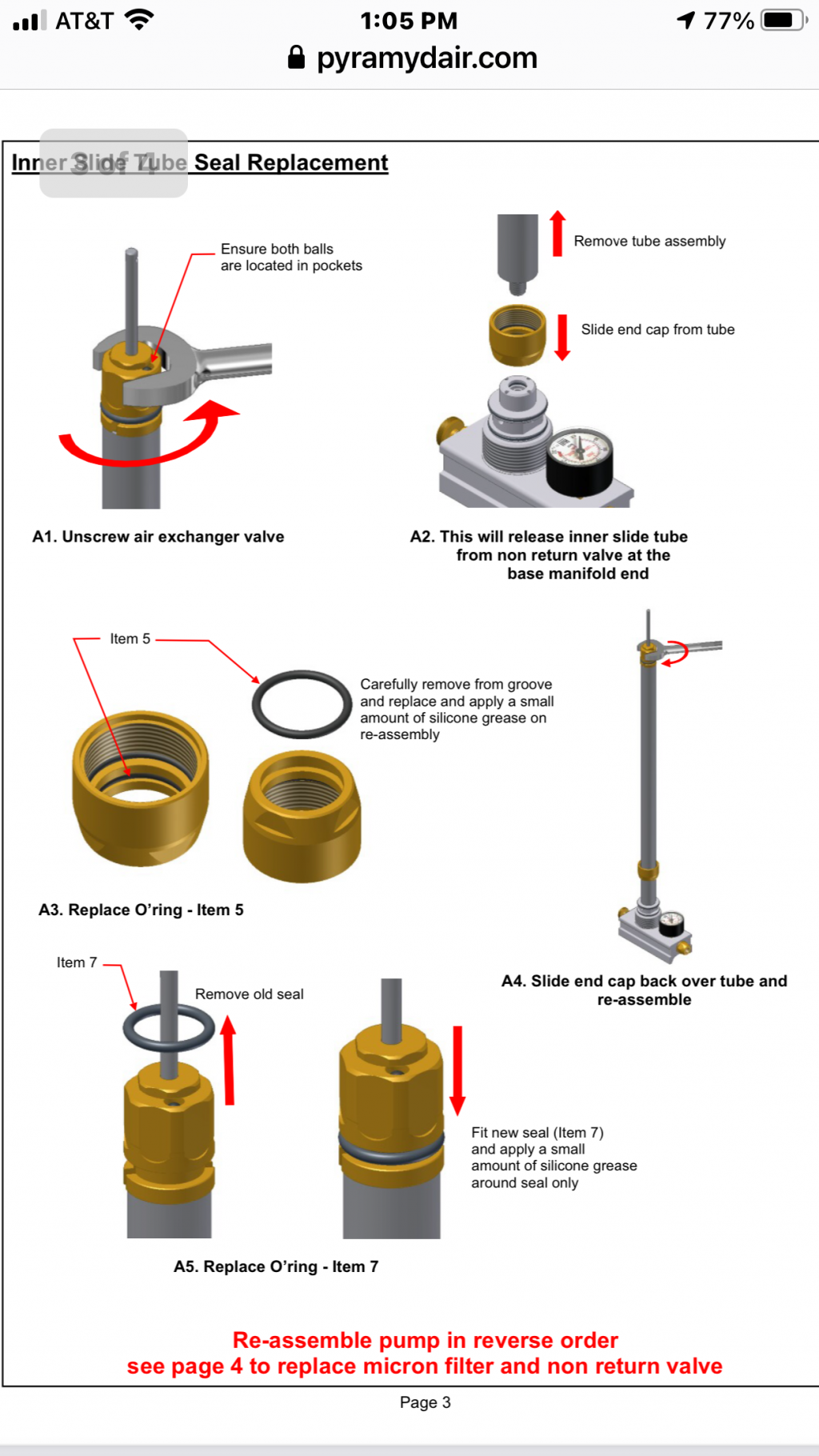

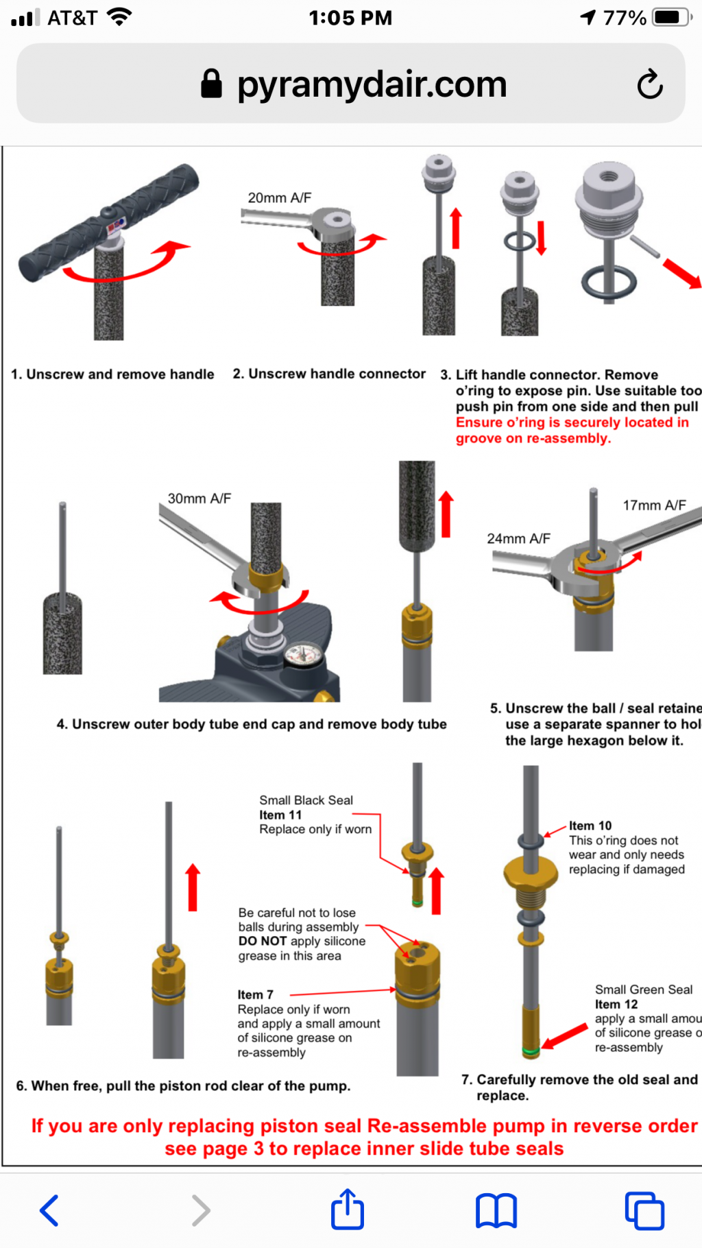

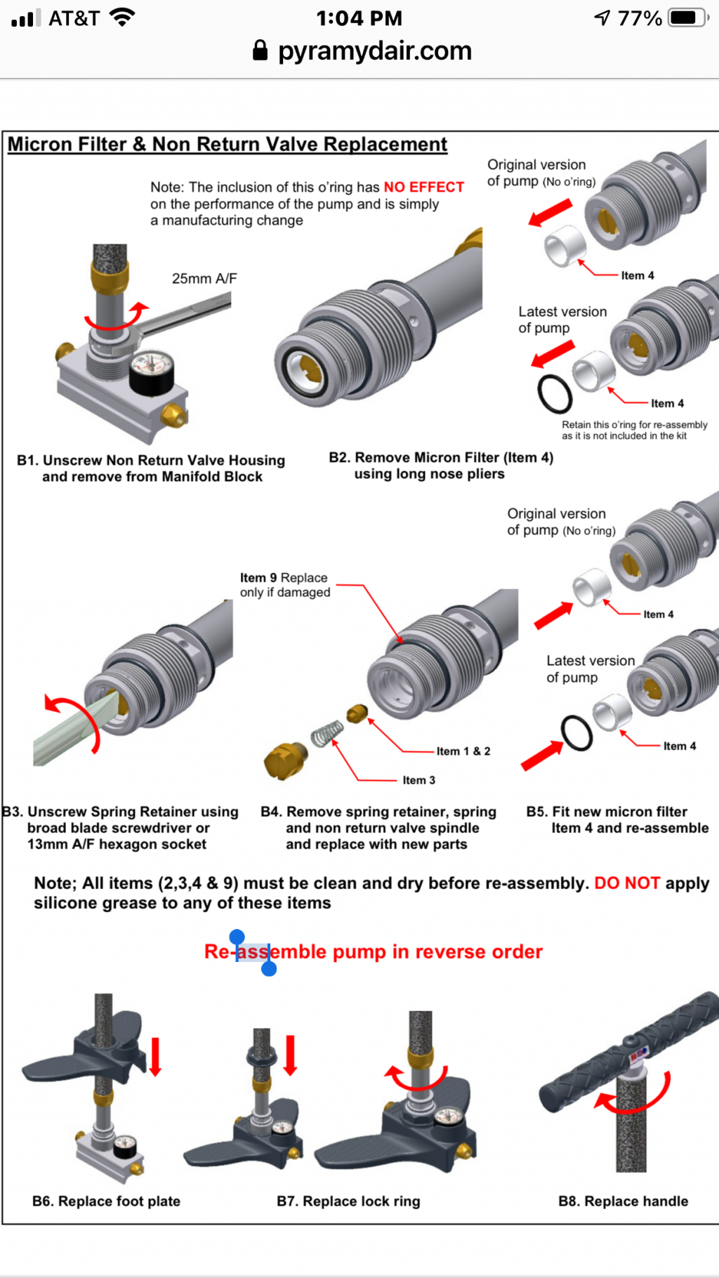

Anything that would remove the 100% silicone grease will most likely dissolve the micron filter also. Read below instructions on where silicone should go, and never go.
Those 2 ball check valves and O-ring by micron filter should be free of it upon installing. I don't really know the new IV, only my III

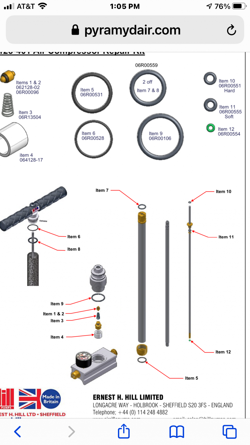

It shouldn't be all gunked up but they do get dirty eventually. Look on EBay for Hill kits. Cheaper than paying $35 + shipping for $2.00 of parts.

Do you have these instructions? I have a big AlkinW31E but still kept my Hill MKIII. They're a great pump.
