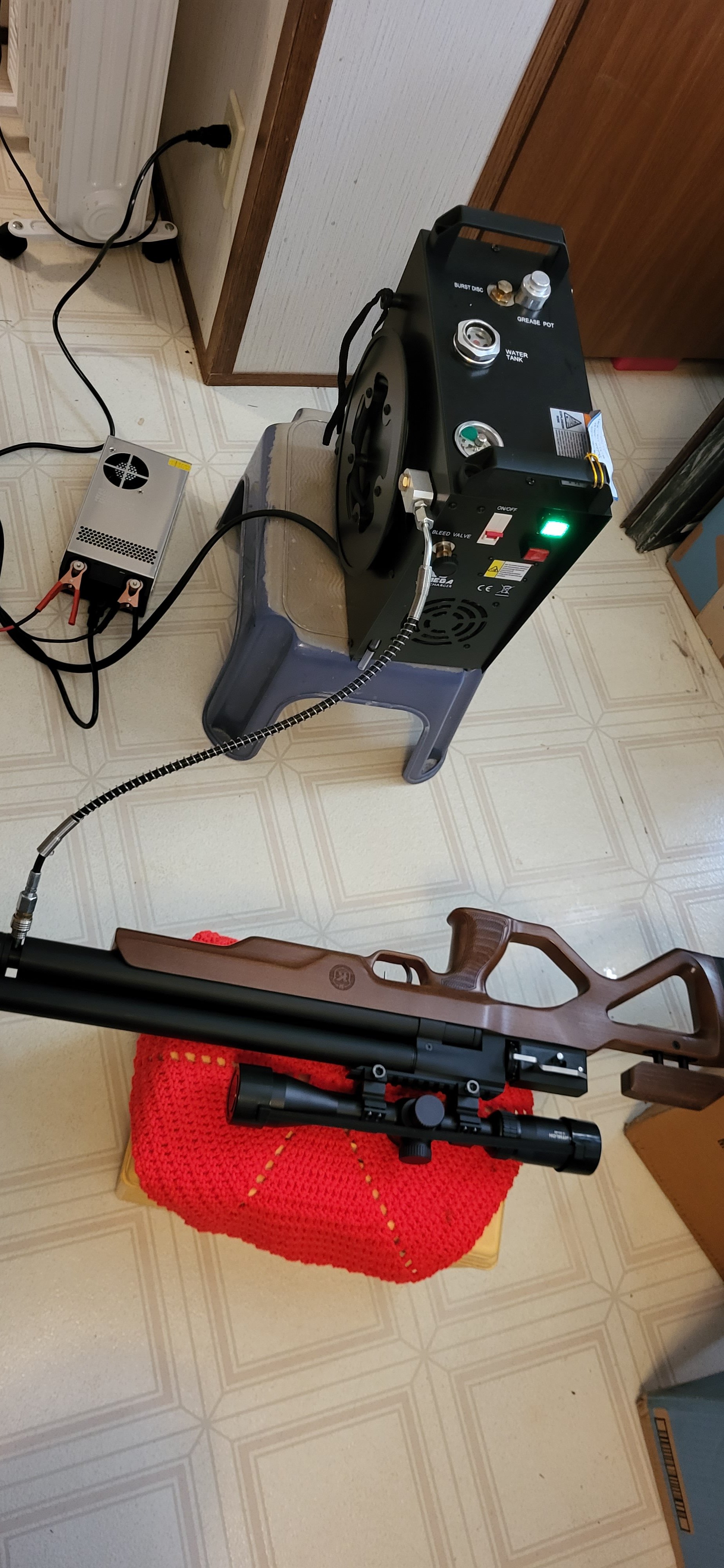

$460 for a gx cs4. I got it so I can top off the gk1 to 5K and have a portable unit to power with my car battery/generator. Quiet and drama free. I just read that it’s actually made by the same factory that makes Omega trail chargers, and it is the same rig in a different wrapper.
I have done no maintenance yet as the cs4 is new and the vevor is holding up. It will be a back-up air source going forward.

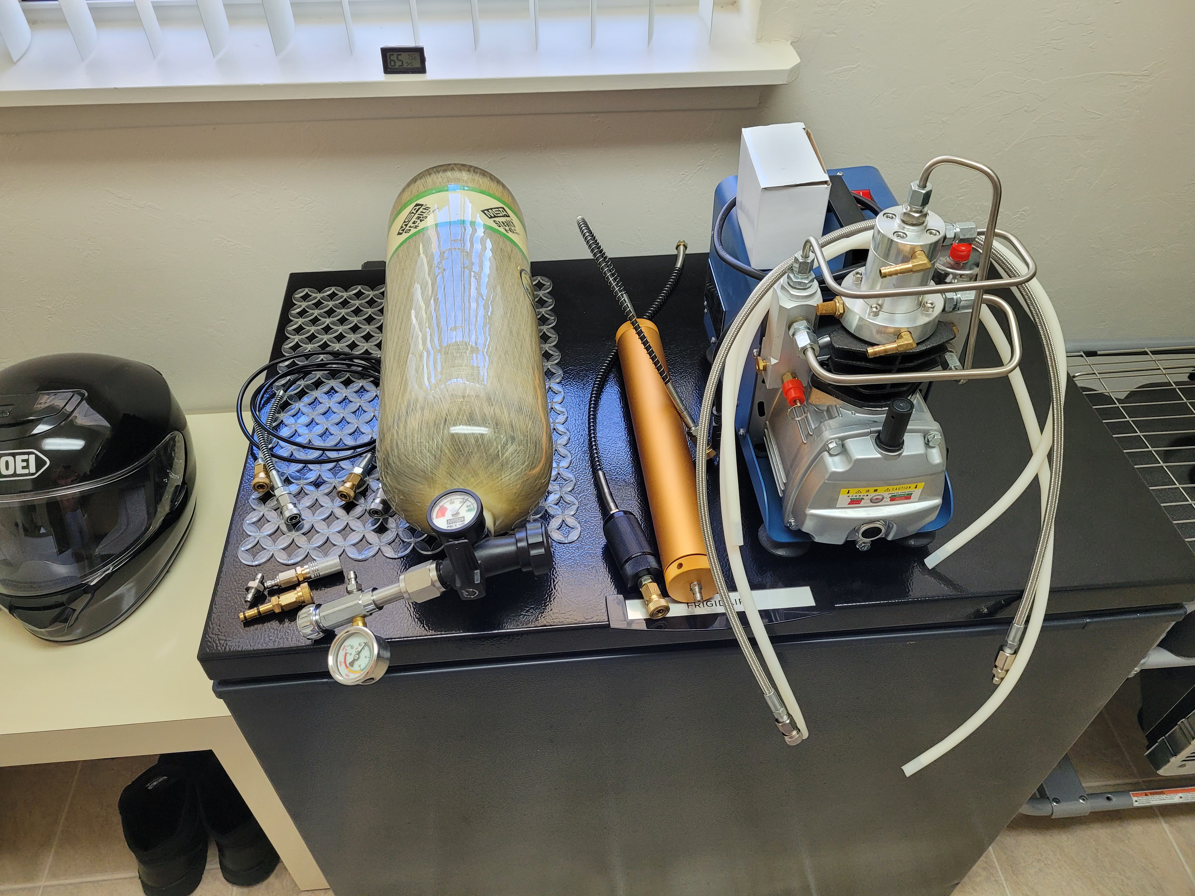

i have a basic yongheng setup with cheapo gold filter, an expired firemans tank and various hoses/fittings .. total cost involved - under 5 bills ... ive had it 3-4 years and have done nothing to it but lube things but my usage is lower than most id say .. my airgun use is all business, pesting, i dont 'bench' shoot other than to sight in and plink occassionally .. fill my 2 tanks every couple of months ..

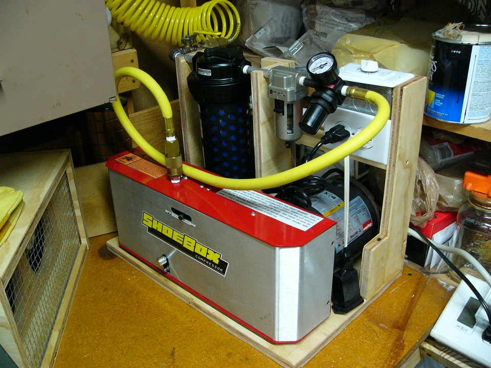

I've been running a Shoebox Max for the past ten years - which of course pre-dates the revolution in cheaper compressors. As such, I bought it new for about $700, as I did not want to spend the $1100 on the Shoebox F8 at the time. I also spent about $150 on my pre-filtration set up.
Based on my log book I have used it for ~380 tank refills, and it has pumped over 2100 cubic feet of air to 4500 psi through those fills over 305 hours of run time - it is on the slow side, but it is so rock solid and is a "set it and forget it" compressor (especially with a timer that I run so that it can't run longer than a calculated max fill).
I have only rebuilt the cylinders (meaning swap out the o-rings) once at ~140 hours of runtime, and I probably did not really need to do it then - I just thought I should. I now have over 160 hours on these o-rings and it shows no signs of needing another rebuild yet - I have o-rings for many more rebuilds on hand, plus lots of other spare parts I bought when Tom closed up shop.
I love this design so much that I bought a backup unit that is like new, in case this one dies - it is one of the last F-10s built and the original owner only used it for ~6 hours of run time before selling it to me. I put about 1 hour on it testing it out and slowing it down with an F8 pulley so it runs cooler with less load on the bearings, and I plan to run it once every six months until the Max eventually dies - which it shows no sign of doing. I should be set with these for the rest of my life, and then my kids can take over with them . . .
