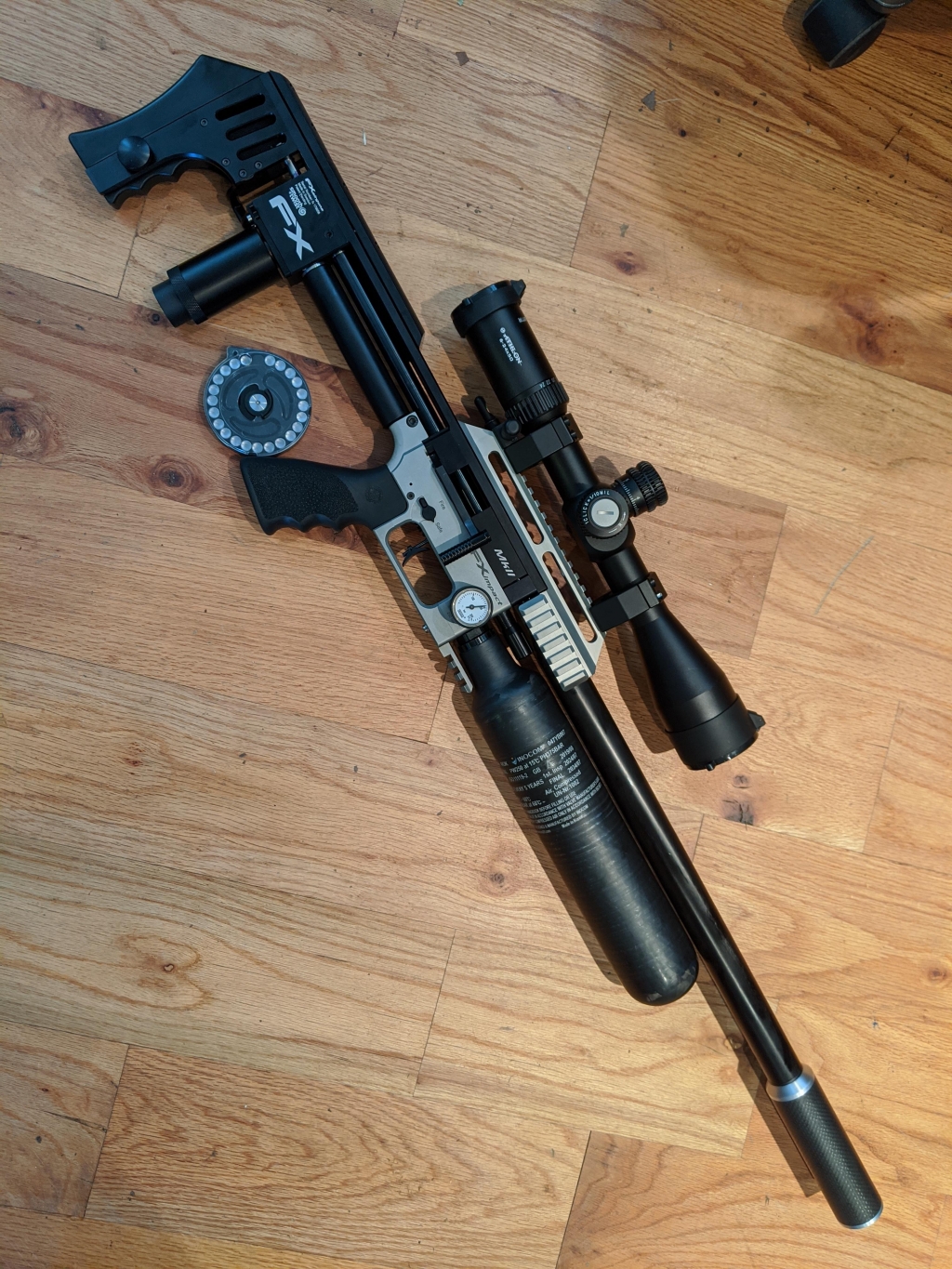

HOT Impact flinging slugs. What's your favorite .30 gr?
I've got this .30 Impact setup for flinging slugs now and it's doing a phenomenal job IMHO.
It's been worked over pretty good, but is just a humble gen 1. Ernest did the port work and as you can see it's got the big bottle and 700mm slug barrel. It will go into FX to get the new plenum upgrade when my turn comes, but in the meantime I need to choose a slug for it. I've also got Neil Clague working on a new 1 piece shroud/LDC.
I bought a pack of each of the 65.5gr, 61.5gr and 54.5gr from NSA. All fit the FX mag. The 65.5 won't fit the Sideshot mag. The 65.5 seems a little slow in the 880s, the 61.5 is in the 910s and the 54.5 is in the 930s. The 65.5 seems to fit the FX mag the best and feeds the best. The others are kind of loose in the mag, not horrible, but not as nice as the 65.5.
I shot them all and the 61.5 and 54.4 are grouping under a dime at 75-85 yds with the occasional flyer. Didn't put much time into the 65.5gr, but it doesn't seem to perform as well. This may be the nut behind the trigger problem tho. Most of the time I'm punching the center out of the bull.
I've got the reg around 150bar and everything else turned up too.
Going down to an event on the 22nd and need to settle on a slug to buy in qty as we shoot all day there. Looking for some feedback from those of you who are into this HOT setup territory and what you find works the best.
Thanks in advance.

Shot some more yesterday between the rain drops.
IDK which slug to choose. In the ideal world I'd be flinging the 65.5 at 950fps, but the power just isn't there. And oddly, the fps I'm flinging all them at is lower than what it was the previous outing. Doesn't seem to be leaking anywhere so I'm kinda mystified. My friend was here and he says he remembers them going faster.
Seems to max out w/ the reg at 150bar. I fiddled with the hammer spring tension too and can't get it to come up any by tightening it, so I put it back to where FX had it.
The 65.5 is in the 850-860 range.
The 61.5 is down in the 880s, I know for fact this was higher a couple weeks ago.
The 54.5 is at 930, solidly. Right where it was before.
At 75yds, the 65.5 needs 1.5 mil of holdover from a zero at 50yds. The 54.5 only needs 1 mil of holdover, similarly zeroed at 50yds.
I'm a little baffled by some of this.
Makes me wonder about my barrel assembly. I couldn't get the breach end of the barrel to unscrew like it says in the instructions so I slipped the whole assy in from the other end. Makes me wonder if I rolled the o-ring off where the liner seats into the breech piece. Doesn't seem to be leaking anywhere, but I don't think the leak path would allow me to notice something odd anyway.
Anyway, to bring this thread back on topic, I ordered 2x packs of each from NSA: 49.5, 54.5, 61.5 and 65.5. That should be enough to get me thru the day in Cross on the 22nd.
Not sure what to do on this Plenum topic. I was under the impression that FX's other internals would amp up the performance of the gun and the Plenum would help even more. I'm pretty sure FX will do a power tune on the gun if I request it. I'd send in w/ the 65.5gr and ask them to tune it for 950fps and see what they can do. Is that even possible w/ this setup?
edosan, what speed are you flinging the 65.5 at? Someone said I need to be in the 950s, I'm no where close to that.

@Monstermaxx did you get the speed difference worked out? With the sudden drop off in speed and no more power after 150 bar on the regulator I think it is something to do with the hammer, spring area. Usually when speed drops off like that it is because of the C3 o-ring going bad. But in your case, because of the mods by Ernest, I would think that it has been changed out to some type of solid delrin plastic washer instead of the rubber o-ring? The speed difference between the two weeks could be lead in the barrel too, but probably not the o-ring you mentioned. The MK1 should still increase speed with reg pressure increase, especially with the port mod. But this is still dependant on the size of the valve seat. That should be 6.3mm or bigger. 6.5-7mm showing the best gains out of the box with not mods.
I got 2 packs of each slug for the Impact and I am going down to the club tomorrow and will be putting it thru the paces. The Impact and a HW98 are going to get wrung out tomorrow. Hopefully get to the bottom of all of it, the '98 has never behaved well.
Supposed to be a sunny day, if a bit chilly. Should be a lot of fun. I'll report back what I find.
