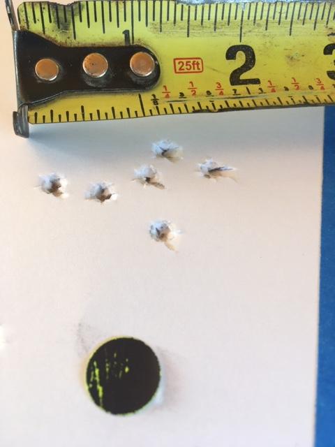

Unless it's a vintage rifle designed for 10yd/10M shooting. I don't have that distance in the house and it's illegal to shoot outside around here. No car to get to the 16 bucks a pop indoor range either. Wish I did. My Striker 1000x did this with CPHP .22's @ 25 yards freehand sighting in the scope;
The lower left group fits inside a dime.
