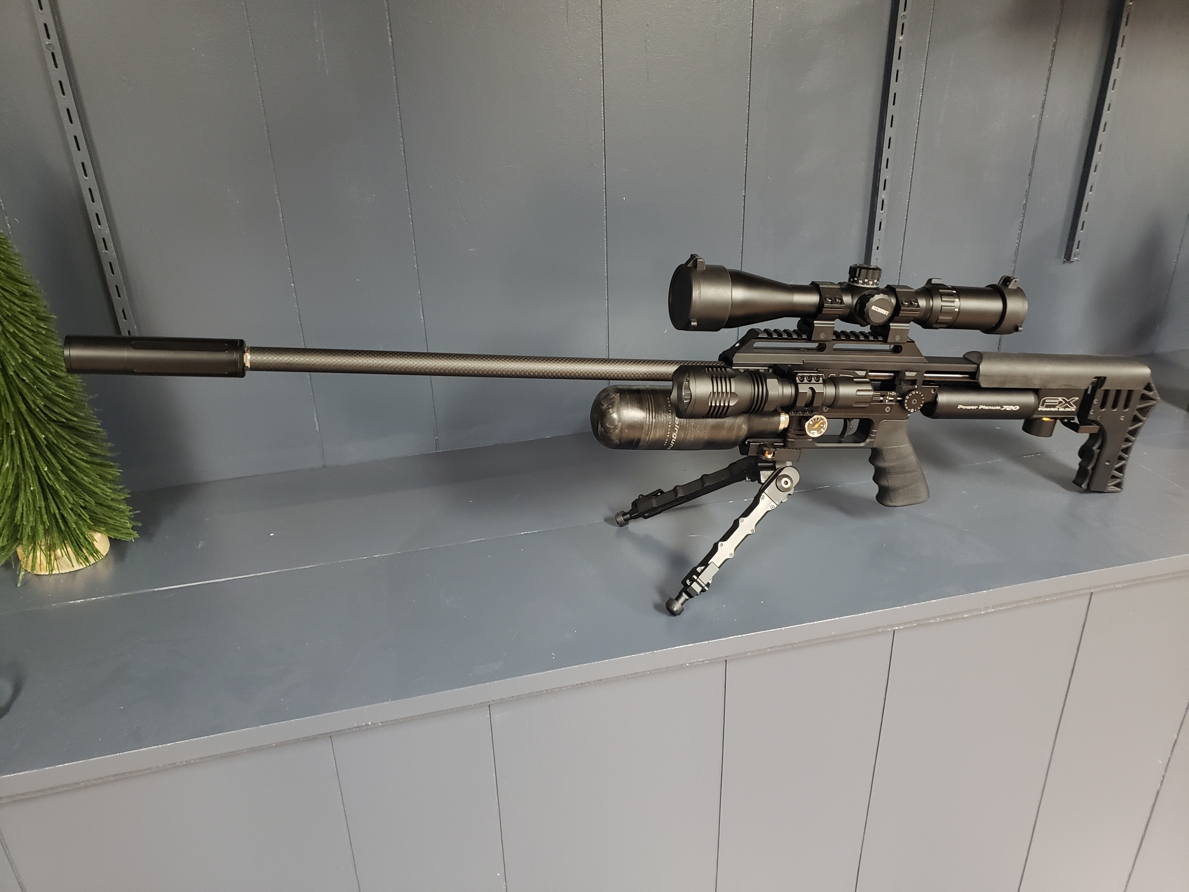

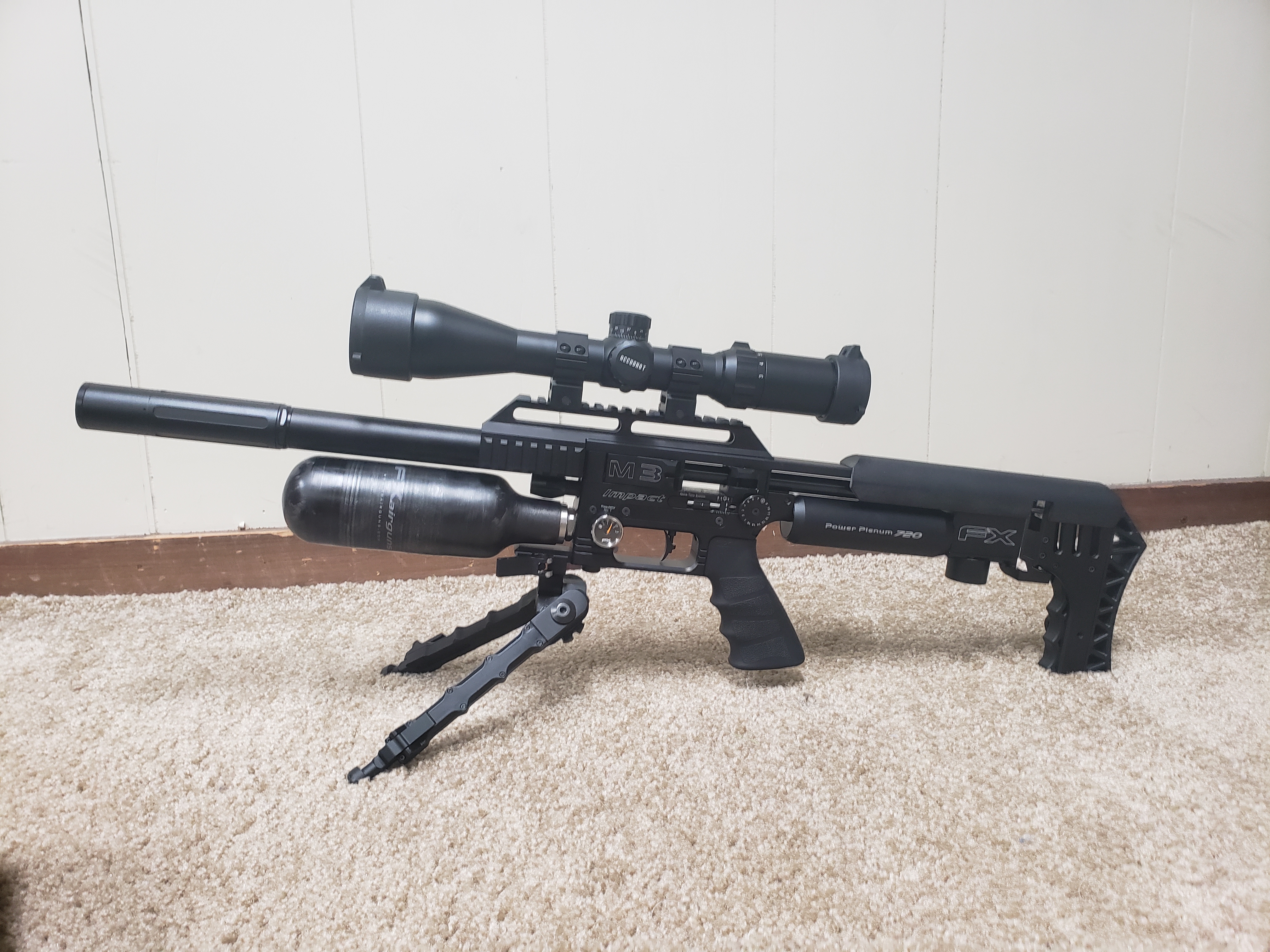

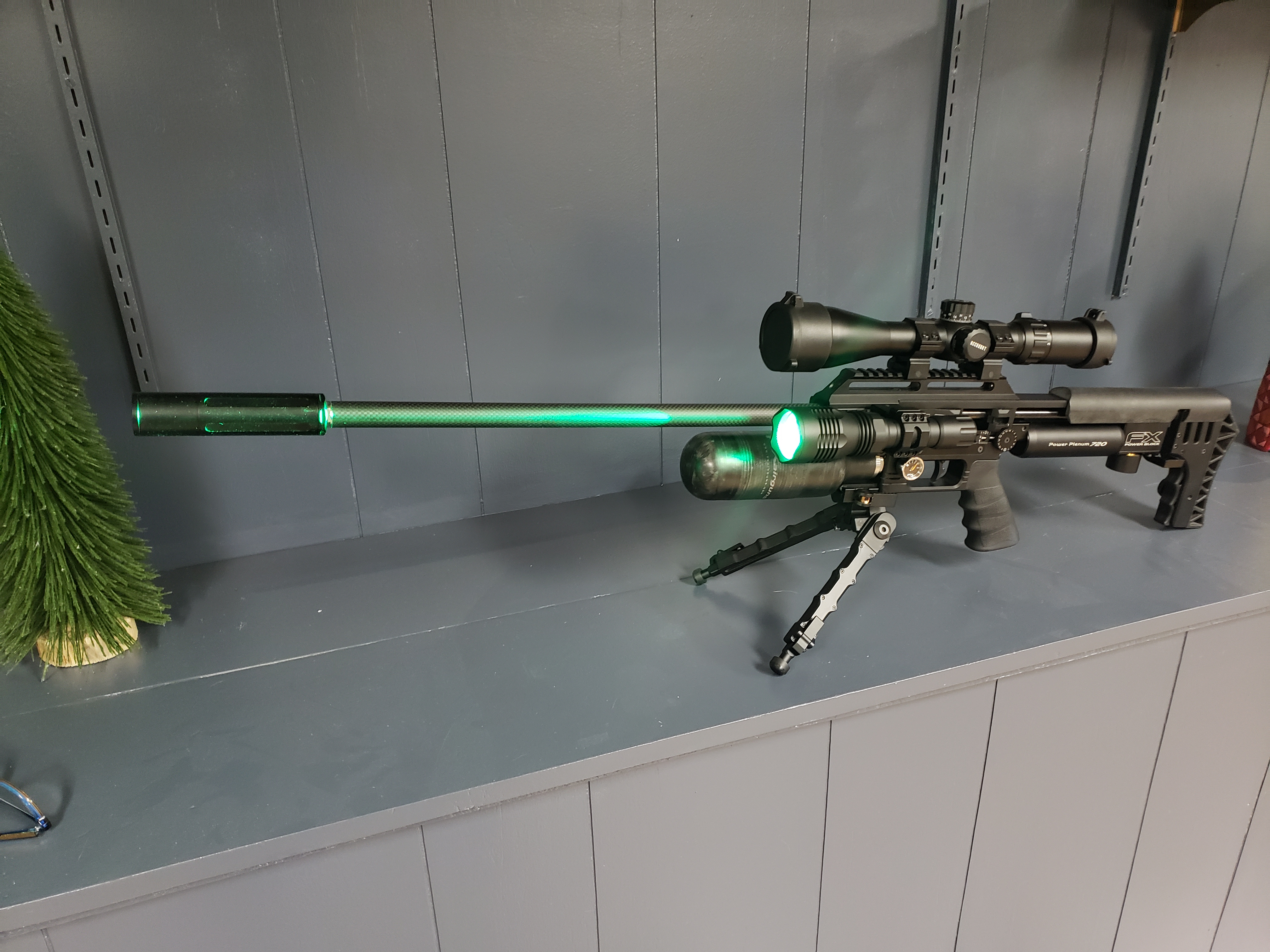

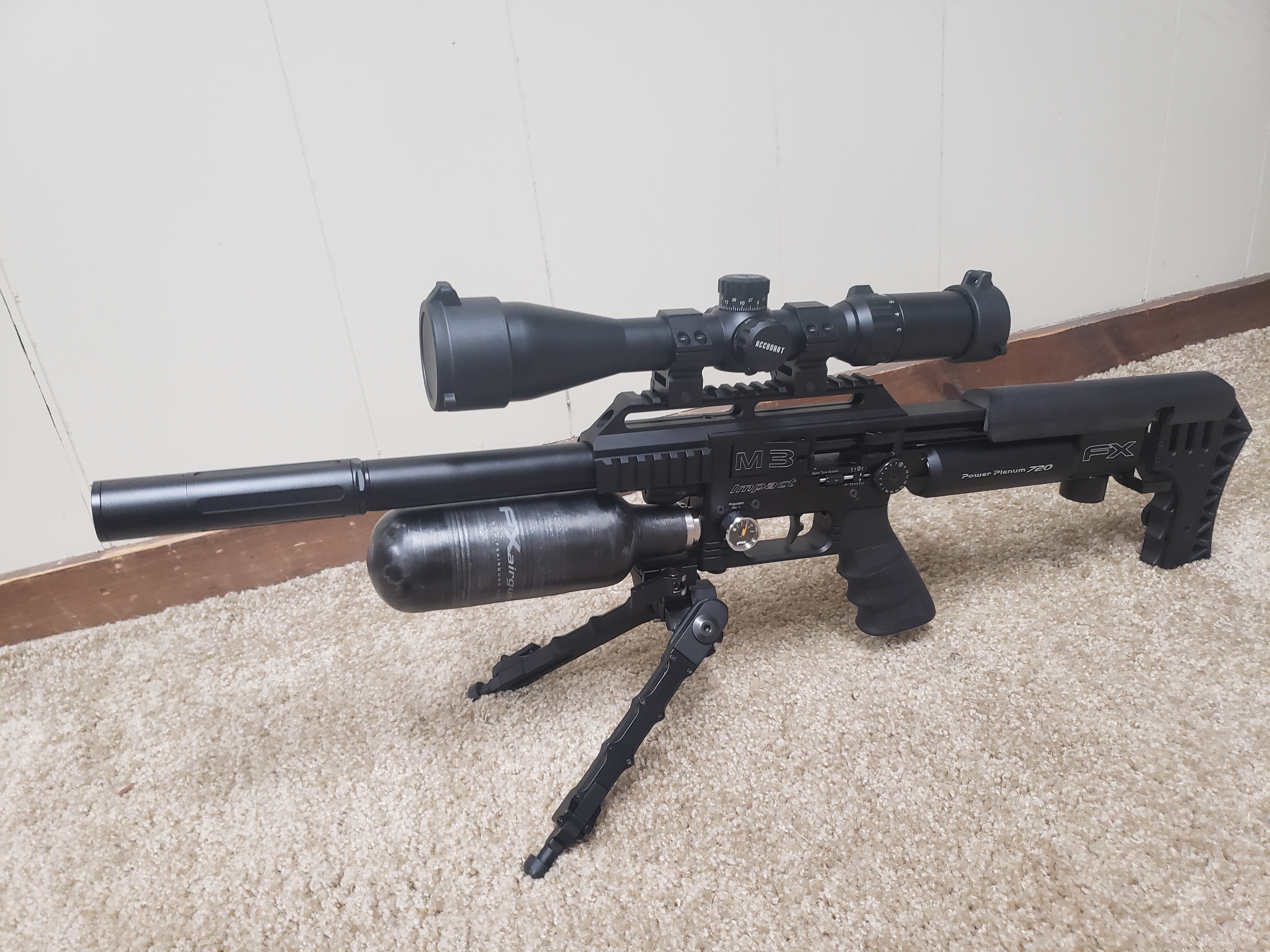

I've been posting problems I've been having with my gun since I bought it. Thanks to everybody that helped me I think I got everything all set it started off as a non-power block compact M3 in 22 cal with a 500 mm Barrel now it has the 800 mm tensioned

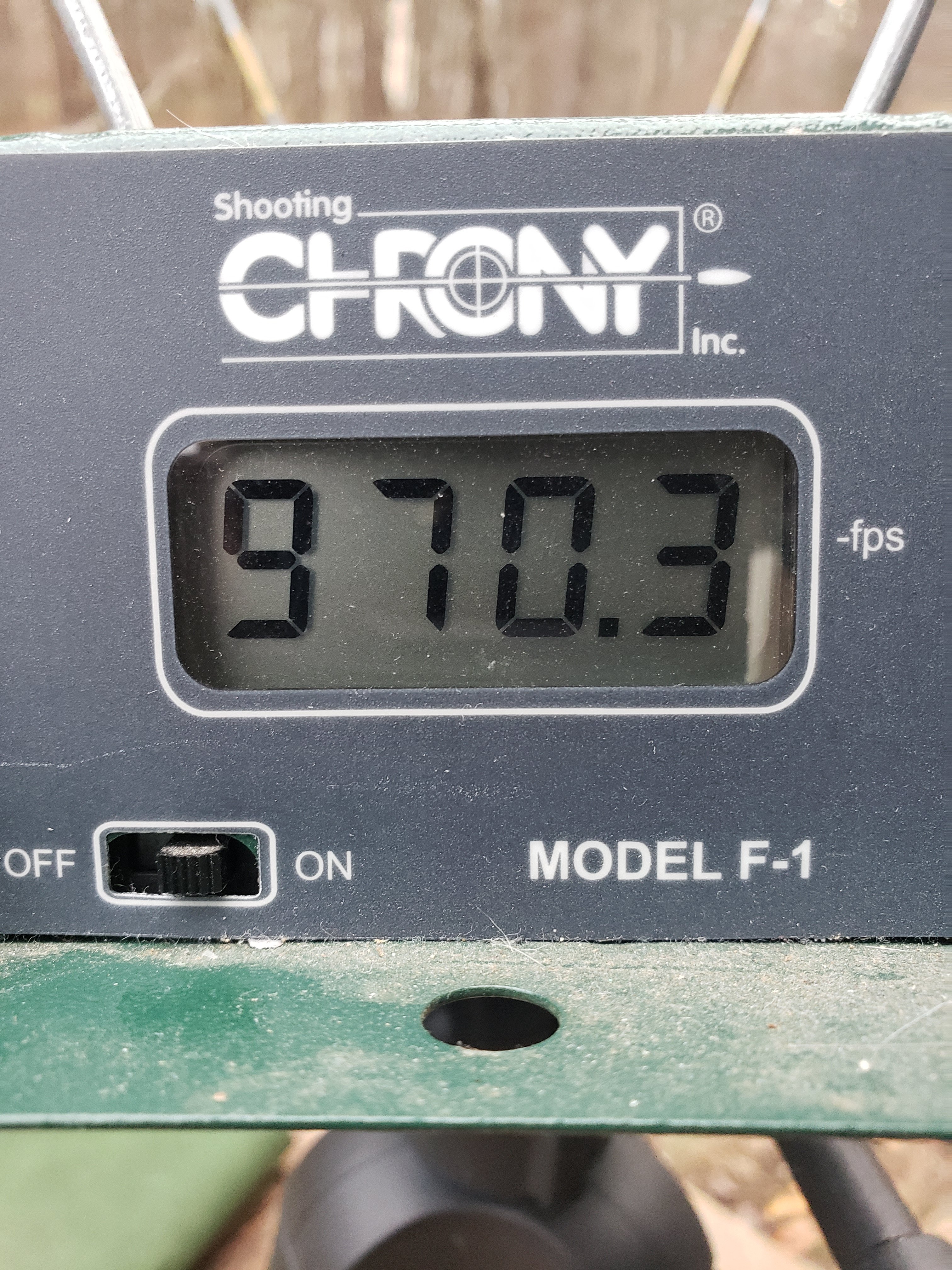

30cal Barrel with a power block. I think the only thing I have left to do is the tungsten Hammer weight and go to a heavier slug to achieve what I'm looking for right now it is shooting 47.2 grain Nielsen slugs at 970.3 ft per second which is 98 ft pounds of energy hopefully I can break into 130fpe with the 62gr slug and the tungsten Hammer weight. Here are some before and after pics!
I really want this thing set up to take down a 90 lb coyote that I have in my neighborhood that's taking out people's pets and I don't want it taking out my dog! So I'm trying to get this thing to be a one shot one kill slug Slinger!
