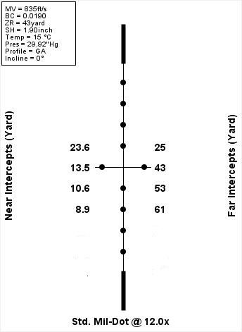

Got the mom pod. Off to practice tomorrow. I will order some pellets tonight. I have jsb exact diabolo at 7.9 I believe and some beenan kodiack 10.3 grains from back in the 90s when I bought the gun and also some Walmart premieres also at 7.9 and one tin of RWS super points 8.4 I think. I am off to the range to see what is what. Where do zero your gun 25 or 35 yards ?
If you zero at 30 yards you will be essentially dead on from16-34 yards. Then you only have to worry about holding over if the shots are closer or further, no holding under. If you zero further out there will be a point somewhere between about 40-45 yard zero that will keep you within 1 mil of holdover at 50 yards and the pellet will hit a max height of 1 mil above zero at 24-25
yards.
