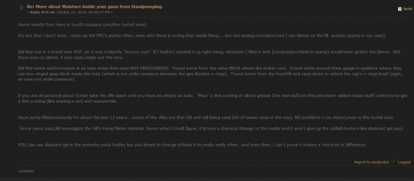

Do these pumps have any kind of desiccant system to remove moisture from the air? Or any way to add one? I live in South Louisiana. Our air is a little moist to say the least.
Thanks,
Kevin
Robert's from your place and dedicated pumper, he got very informative post over at GTA.
