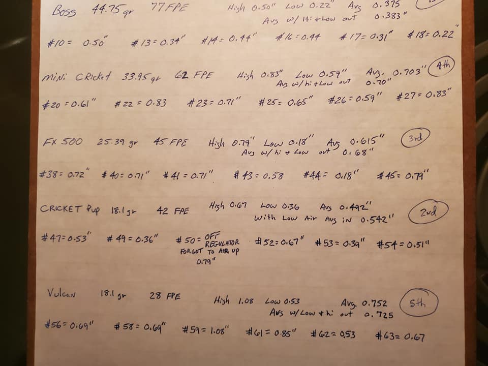

So, lets recap Winner and 1st place at 46 yards in wind. FX Boss shooting 44.75 gr at 77fpe avg 0.375 inches for six (5 shot) groups.
2nd place .22 cal Cricket pup shooting 18.1 gr at 38 fpe avg 0.492" for 5 groups and 0.542" for six groups if I include the one with low air.
Edited in the Cricket pup power at 38 fpe with the 18 grain. It does shoot the 25 grain at around 865 fps for 42 fpe, but the 18's are flying at 970 fps.
3rd place FX 500 shooting 25.39 gr at 45 fpe avg 0.615 inches for six (5 shot) groups.
4th place Cricket mini shooting 33.95 MK2's at 62 fpe avg 0.703 inches for six (5 shot) groups.
5th place .22 Vulcan shooting 18.1 gr at 28 fpe , avg 0.752 inches for six (5 shot) groups.
Sighters top left of page. Boss top row, Mini 2nd row, FX500 3rd row, Cricket pup 4th row, Vulcan bottom row
