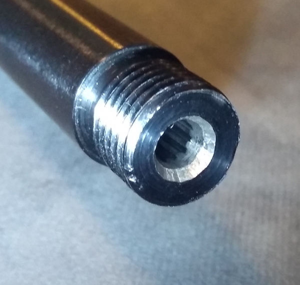

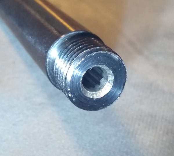

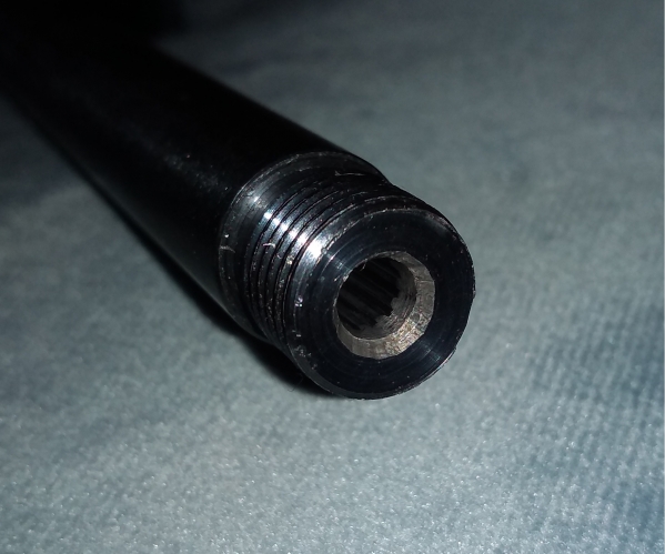

good or bad crown ?
i received a new pcp rifle today but the precision at ~27yards was terrible.
would you say the crown could be the problem ?
it looks handmade to me and there is no force needed to push a pellet through whole barrel and no choke.
i will not tell you the brand because im waiting for a response from my dealer.
Sounds like you have multiple problems. Does the pellet have grooves in it after you push it thru?
If the pellet is not engaging into the land grooves, then the barrel is not rotating the pellet. If the pellet is not rotating, then it can not over come turbulence around the skirt in the first few feet of travel.
If the crown is not cut square to the bore, one side of the pellet will exit prematurely, and it will be slightly askew.
Just by looking at the pics, nothing about that barrel looks good.
Yeah the bevel on the end looks rough and would be at least cause for concern in most cases, however in this case it is irrelevant because the rifling is removed for some distance down into the bore. That’s the real problem. The cutter has removed the rifling at a shallow angle which makes it pretty well impossible to make the rifling terminate at a distinct location. The rifling should be sharp and fully formed up until it suddenly discontinues at the muzzle. In the photo, the rifling gradually tapers away.

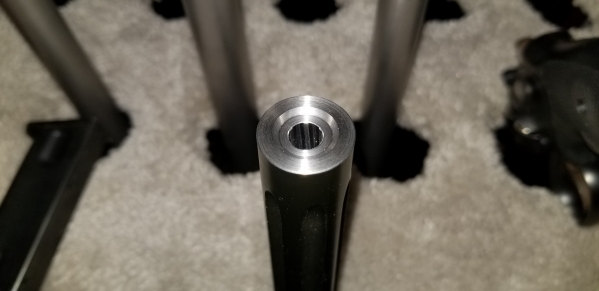

FWIW, the only crown I’ve seen that was that bad was one from a fledgling company, never on a legit production gun. Granted I’ve seen a few from Crosman and one from SPA that had damaged rifling at the muzzle that apparently were from using a crowning tool with a non-floating pilot. Just atrocious to see an otherwise decent barrel ruined by such carelessness. I can deal with touching up a rough crown, that’s easy enough, but it’s a pain to have to chop off the end of a brand new barrel to fix that mess.
