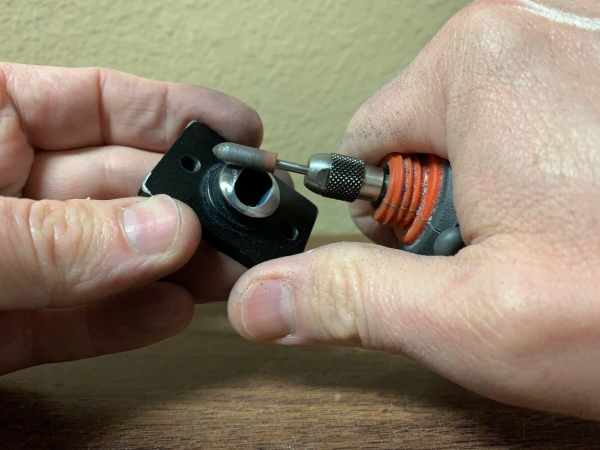

Always polish the part in the direction the part is used - like in the example of the hammer - you would polish so that the scratches would be longitudinal - or long ways down the long axis of the cylinder.

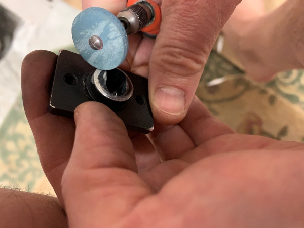

Start with the most abrasive rubber impregnated wheel or cylinder you have at a slow speed working toward the least abrasive – spend the most time with this tool getting all of the deeper scratches out – but you have to be careful, the more abrasive the polisher and the harder you push, the more metal it cuts away. Take care not to change the shape of the part you are working on, only remove the scratches. This is where the Kit from Harbor freight/Amazon comes in. The rubber impregnated polishers work great for this. Also - here's a trick to avoid changing the shape of the part - notice how I'm holding the Dremel with a thumb rest on the part - that gives you the most stable base possible rather than holding the Dremel like a pencil.
PS: You'll want to wear safety glasses with these things - the can fly apart and hit you right in the eye... ask me how I know.

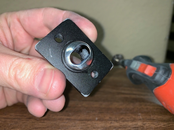

I polished half of this steel slip ring from my bipod to show how the abrasive rubber wheel can cut away metal and smooth out the ridges left over from the milling process. If you need to completely remove manufacturing ridges like this, start with an abrasive stone to level and then move to the rubber impregnated polishers.

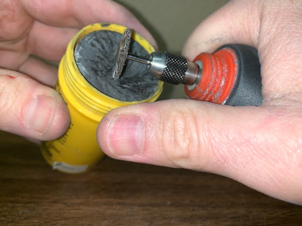

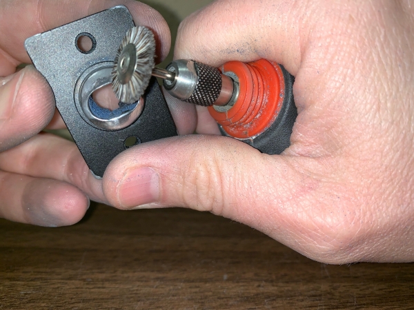

Once the part is somewhat smoothed, you can move to the bar buffing compound or Tripoli. This works best on a horsehair brush on either a Dremel for small parts or a lathe for large parts. This is what I used - you might be able to find the Jelenko brand BBC - it works the best on all metals from aluminum to steel, even gold and brass. One container will last you a lifetime - this one is 15 years old and has been used a ton.
Pick up the BBC on your brush by running the wheel and spinning it into the compound.
It will start our by coating the part in a black haze, then as you continue to polish, it will break down and the particles in the compound will become progressively smaller and polish away, leaving a pretty high shine.
Take your time with this stuff - the slower you go the better as the compound breaks down. This is what will give you the best smoothness and shine.

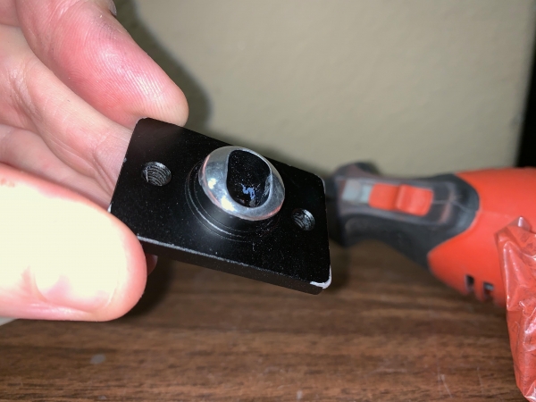

This is what aluminum looks like after the BBC step:

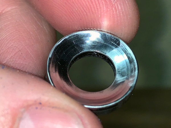

Here is steel, notice it's still scratched, but you have to look close to see it:

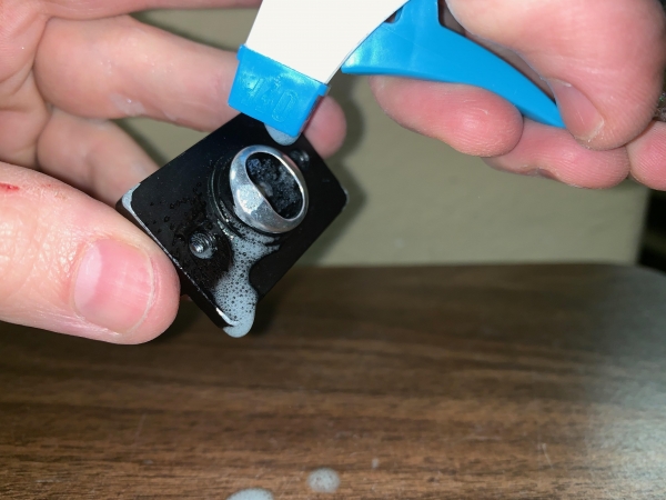

To clean the excess caked on polishing compound between abrasives Windex works perfectly.

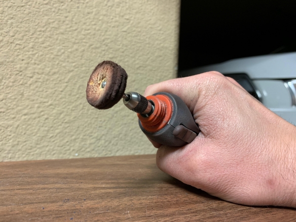

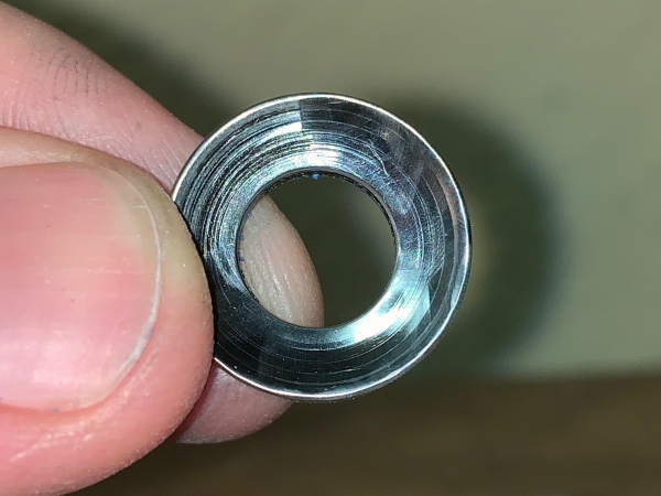

The last step is Red Rouge – this can be applied with either a brush or a rag wheel. This is done quickly. Charge the brush or rag wheel with the rouge, you don't need a ton, just touch the bar quickly.
Then buff quickly and lightly and you will see the high shine develop.

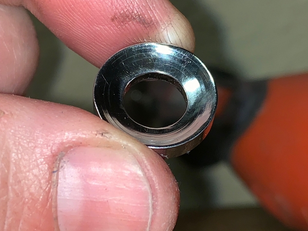

I tried to take as close a photo as possible so show the very fine scratches still visible if you look closely - you can get rid of these by going back through the BBC step and the Rouge again... it this was a hammer or a trigger sear, that's what I'd do. But in this case, it's for a bipod and good enough.
