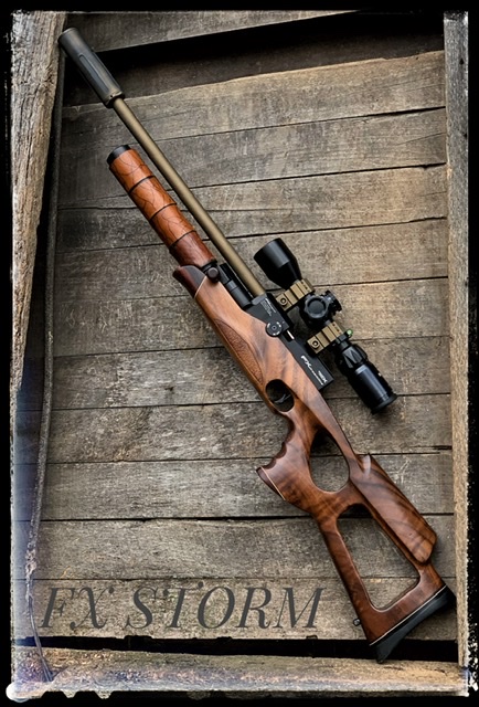

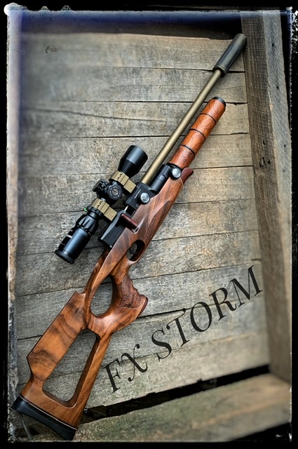

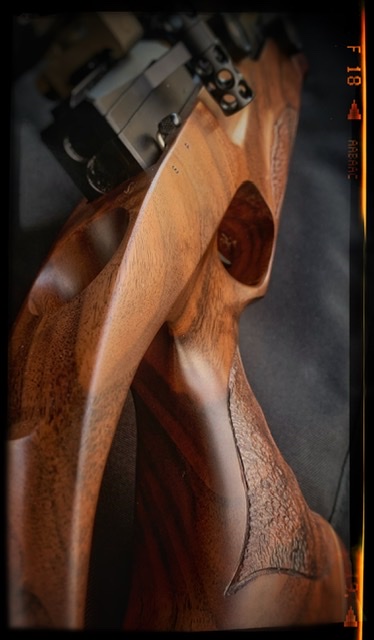

The FX Storm is my 4th Skelton stock build to come out of Steve Corcoran’s custom shop at Steve Corcoran Stocks And Grips out of Gainsville TX. It’s been a nine month project.
Steve is a Master Craftsmen !

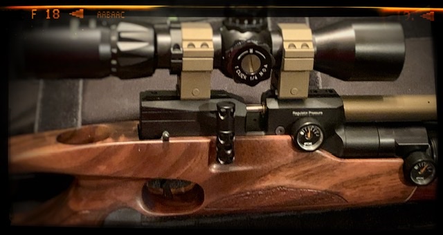

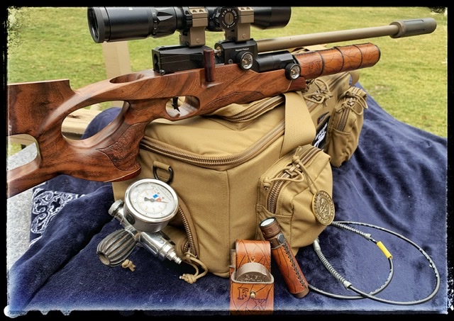

The Storm is carved for the now ever popular FX Dreamline Compact series. Because of the reasons mentioned above. I NEED WOOD! This .25 cal little powerhouse now sits as the first in its class , fine wood stock for the FX Compact in fine wood. I’m sure you all know the specs on the action so I skip that. The Storm comes in at 5lb 2. 3/4 oz bare.

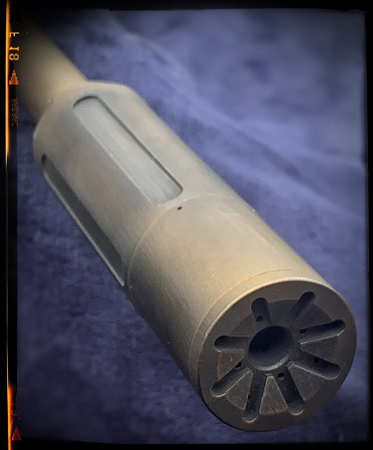

with no suppressor. With the Monstrum Tactical 3x9x40 FFP
and Donny FL suppressor it’s 7.1 lb ready to hunt. Length is 34 in long bare. 38.5 inches with the Donny FL mounted.

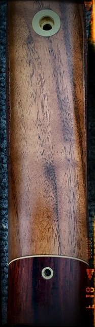

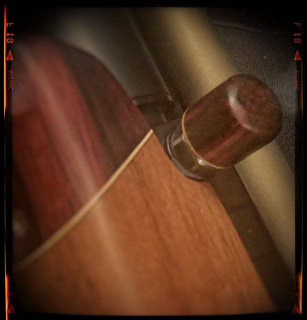

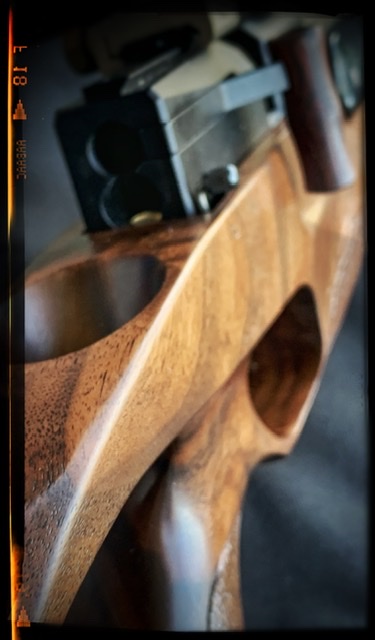

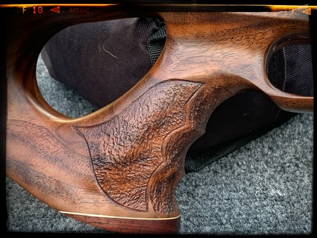

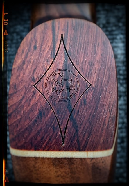

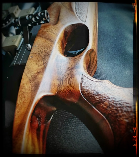

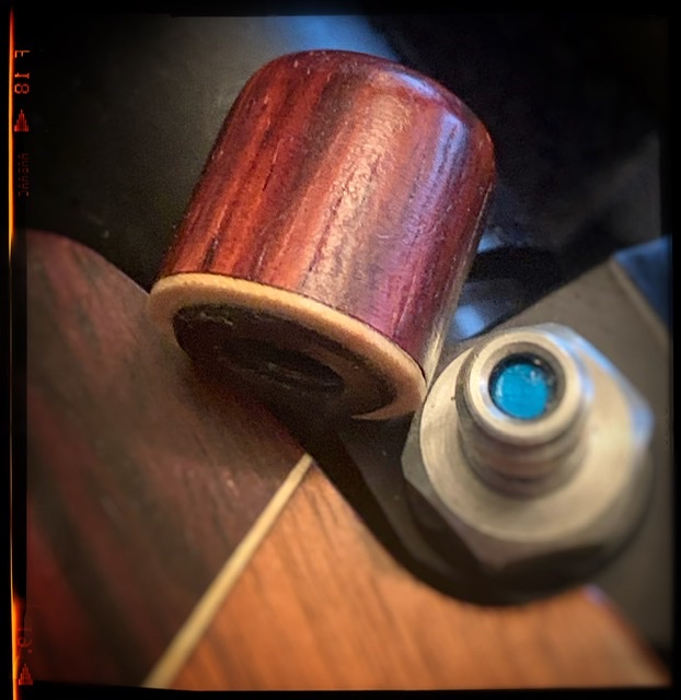

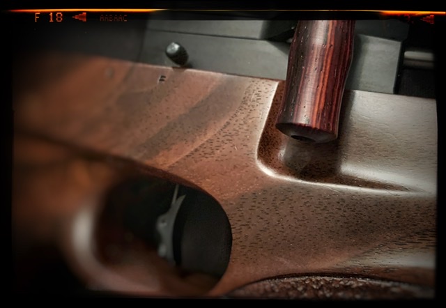

The stock is carved from select Walnut with Cocobolo caps front to back. Stippling in all the proper locations. LOP is 14 inches.
With its light, compact and handiness and awesome 43 fpe.

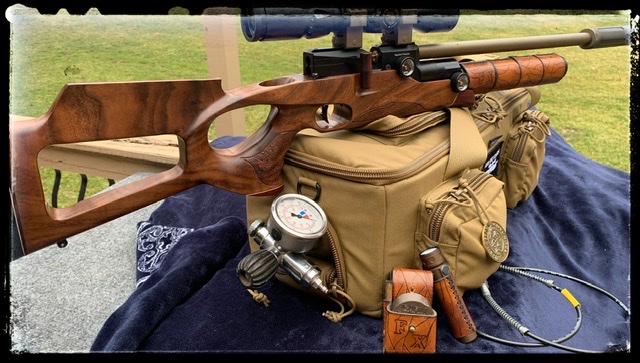

Filling the Storm from a fireman’s thank nestled in the soon to be released RANGE BAG from ARMAGEDDON GEAR
The Storm is spitting out 36 good useable shots on a 3600 psi fill.28 shots on the reg and another 8 off reg with less than a inch drop @50. Close enough for head shots on tree rats and plenty of shots for a morning afield.

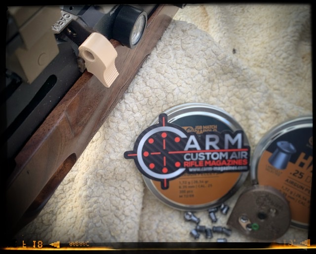

Huge props to Darko at https://www.carm-magazines.com/mini-magazine-for-fx-crown-dreamline-air-rifle.aspx for some brilliant 3D printed mags.
So easy, so nice.

Very excited about the FX Storm. It swings tight, hits hard and fits well everywhere your hands touch.
And soooo much more fun snuggling with a fine piece of wood when enjoying the outdoors.

I would be terrified to even hold that gun for fear of dinging or smudging it. Nice to look at, but definitely not for me.
I like rugged simple guns that get used. A lot. In wind, rain, cold, heat.
In my truck. In the woods. In the grass. On the farm. On the front porch.
I guess that's why I'm such an edgun fan. Lol.
Very very nice by the way! Just not for me.
