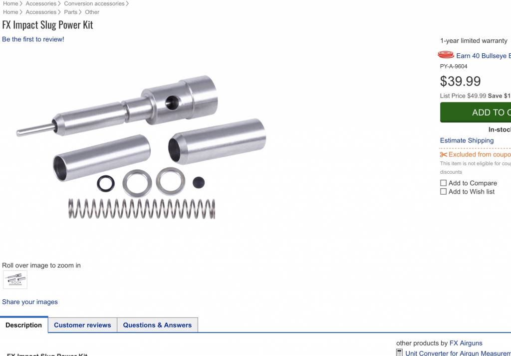

FX Slug Power Kit
Uh, I guess this is all that’s needed.
https://www.pyramydair.com/s/a/FX_Impact_Slug_Power_Kit/9604

Why dose impact need valve return spring at all?
Without a valve return spring the valve would not close consistently after every shot if it closed at all.
Thats weird I would say. All guns Iv owned havent needed them. Generally they only make guns run more inconsistently and lose power. Only purpose Iv ever found for them is to make filling up easier when gun is totally empty and even then you only need to cock it when you fill it from empty I would like to know whats different with impact? My both current guns are running without them and are far more consistent and make heck alot more power like that. But who knows maybe Impact is actually needing it for something but I highly doubt it. Unless Impact regulators are so freaking slow filling up chamber that it becomes impossible to have it pressure seal without spring.
