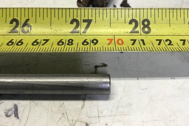

Got the barrels today and went straight to work on fitting one to the FX impact. The barrels were both received in good condition ( thanks Knife) the unfinished length at 27 1/2” and an OD of .311” . First was to cut to length at 600mm , next was to cut a crown and last was to work the leade .

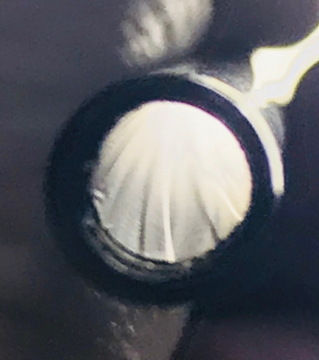

The FX having a thimble makes fitting this barrel a real breeze and could be done with nothing more than basic hand tools . I polished the bore with a couple hundred strokes of both fine and ultra fine JB bore paste .I don’t think the barrel even needed it as the riffling appeared to be really well cut with no chatter marks ,smearing or rough lands . Not what I was expecting from a 40$ barrel liner .
The barrel liner slid right in the outer barrel sleeve with a couple orings just like the OEM barrel liner . In the pics , you can see a step in the rifling but that was cut off as I suspect that was to show which end was to be the breech end .
