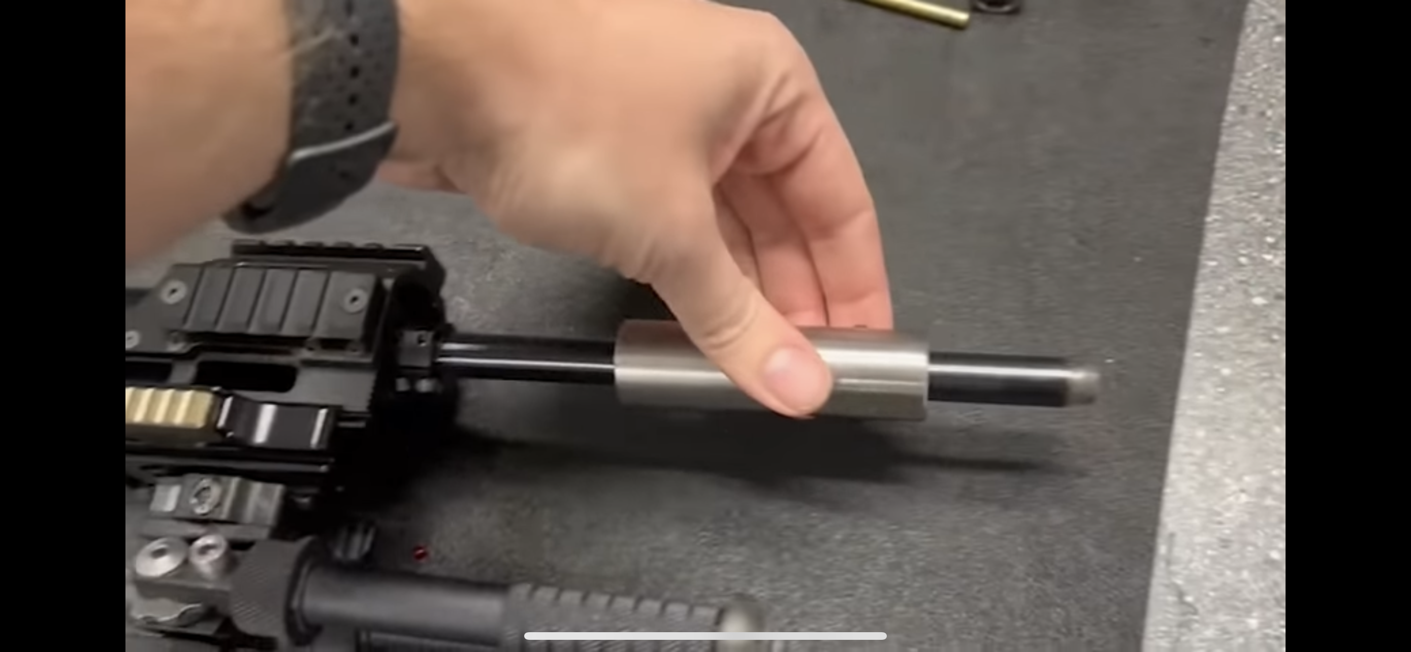

I’ve seen few pics like that:

Did they actually say this or is another gossip from the unknown?View attachment 320802
From that picture it looks like STX system/barrel with a clamp just like the M3 at the end of plenum. This is interesting because thought FX said after plenum is filled the expansion will compress the barrel so why put a clamp there?
