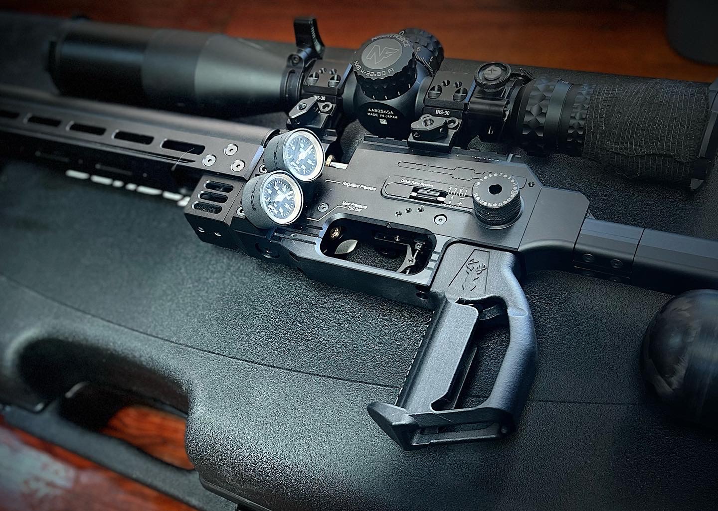

The first thing that I noticed after unboxing the rifle was the reg pressure. It was sitting at 172bar. I thought this looked weird and sure enough it had crept up from the factory set point. I filled the rifle and didn't touch the power wheel for the first mag, but it clearly had a bunch of valve lock. It took 4-5 shots to get it down to the set point, which appeared to be 132bar.
After verifying the reg set point, I turned up the power wheel to see where it maxed out at 132bar and found that it could shoot the 40gr at 925FPS. I zeroed my optic and and changed my POA (50m) and put (5) shots through the same .22' hole. Not bad!!!
I filled the rifle a second time and saw that regulator jumped up to the low mid-140's. I paused for a bit and ~20 minutes later the regular was sitting at 148bar. I'm thinking at this point that the odds were probably 50/50 that the reg either needs to break in or has a creep issue. A few mags later, the regulator stabilized at 132bar and remained there through Saturday morning. This relieved my concerns and confirmed that the creep issue was transient.

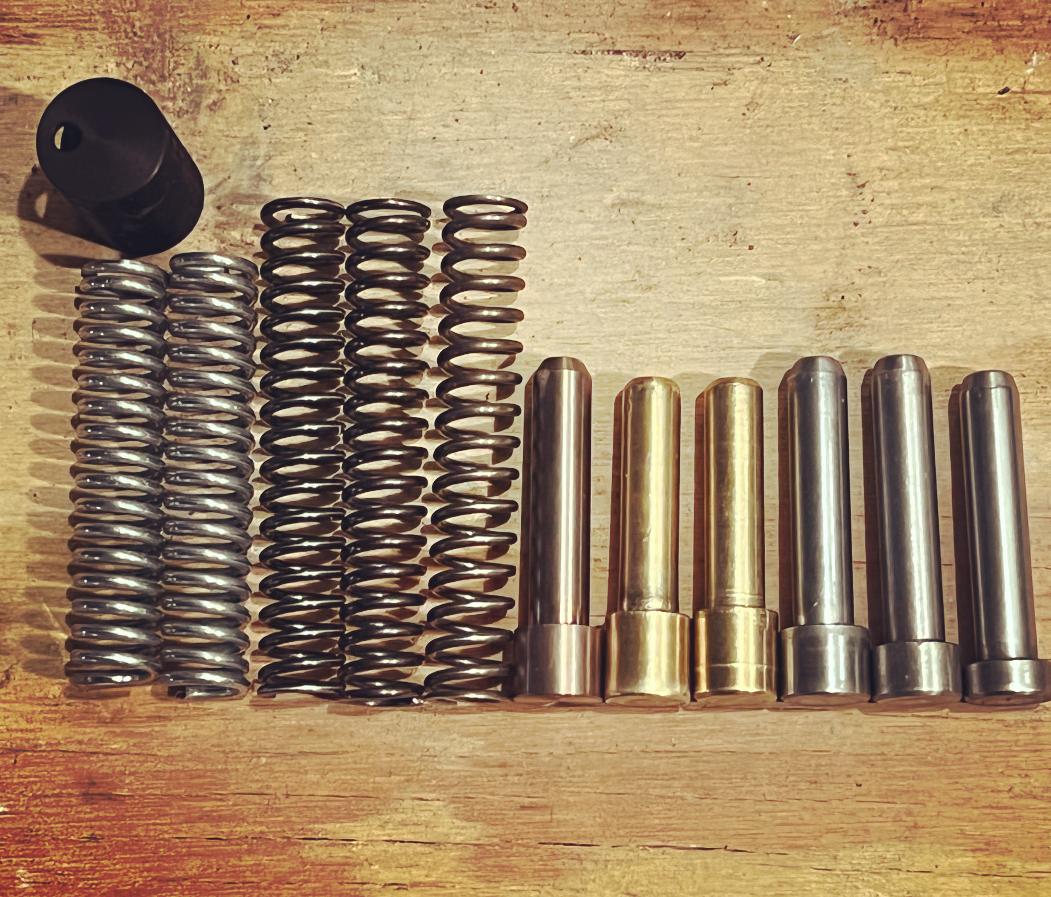

I tried several combinations of springs and hammer weights (up to 14.2 grams) and the maximum velocity that I was able to achieve with what I had on hand was 1007FPS. I DO believe that it could be possible to squeeze more out of the rifle at the cost of shot count (i.e., not enough air capacity for an NRL22 course unless you have a 300bar bottle and multiple air tanks on hand).
There was not much of a difference in velocity when I ran a heavy spring + heavier weight compared to heavier springs and lighter weights. I think the best configuration for max power would be a 16-18 gram weight with a heavier 52mm spring, but I screwed up the heavy 52mm compression spring that I made a few weeks ago and didn't have one to test with over the weekend, so during my testing I used the factory 56mm spring, a heavier 56mm, and a 53mm spring that's in between the two.
Therefore, I was not able to exercise the full capabilities of the vale over ~172.5bar. I was also warned to not use the 26.5 gram tungsten weight with the Panthera, but I suspect that could be due to some early reports of bent valve pins that were being caused by an interference issue when the valve was bottoming out against the Arca rail retaining piece that covers the two brass threaded plugs on the muzzle side of the block.

- Is it NRL22 worthy? -Yes, definitely. Although the Arca rail has way too much play!!! So much so that it interferes with the shroud, but I already knew this going into this purchase

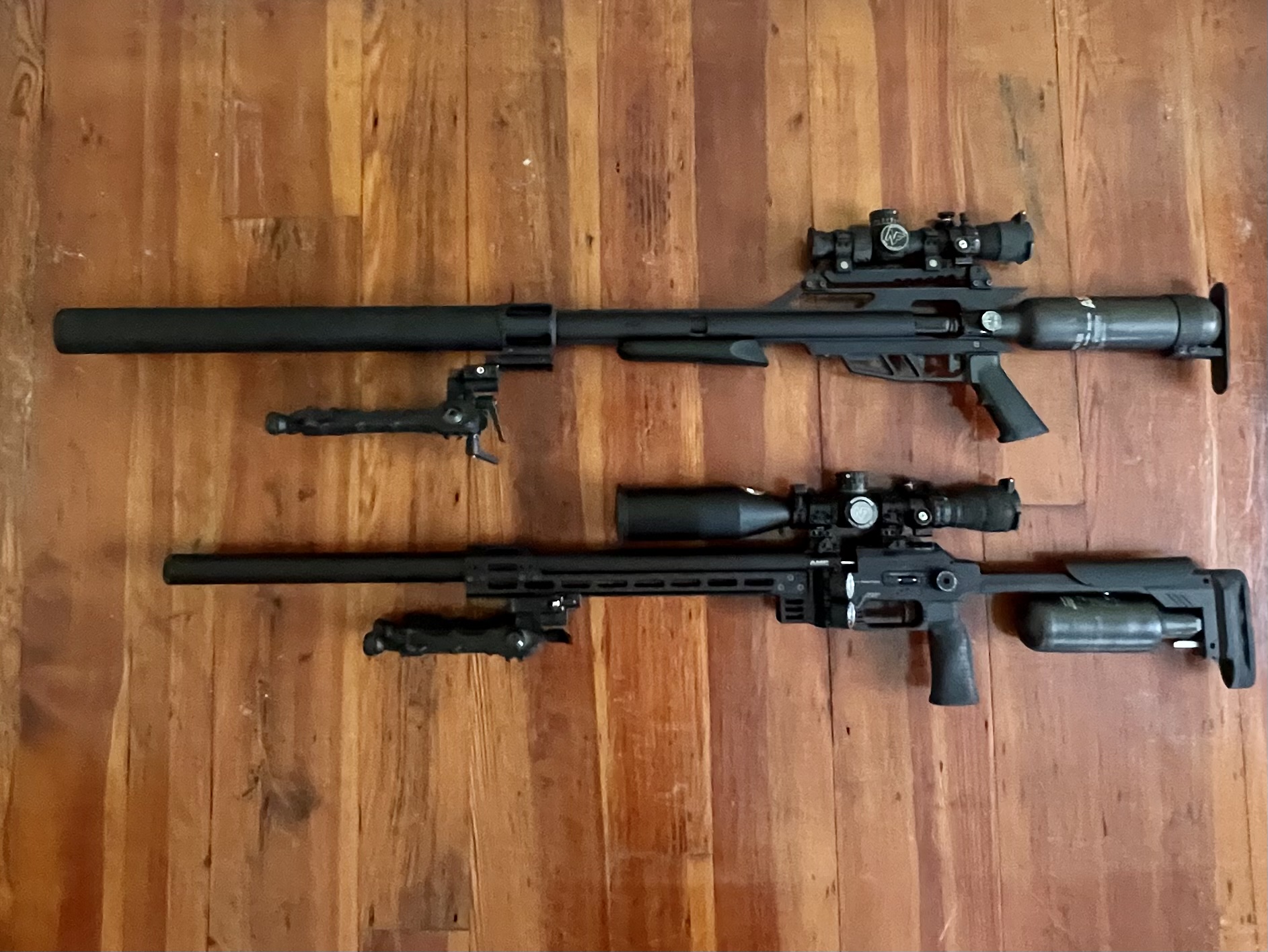

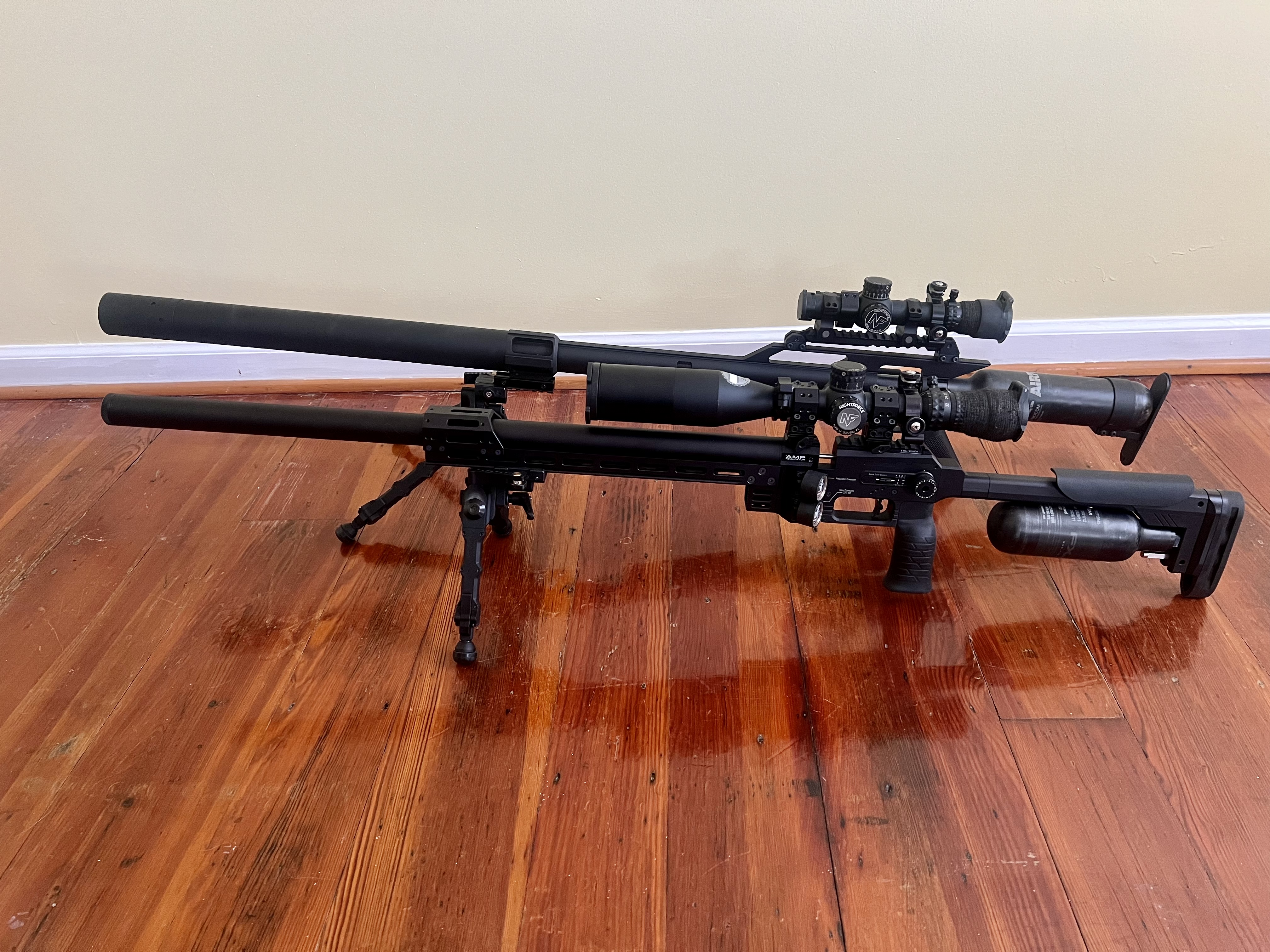

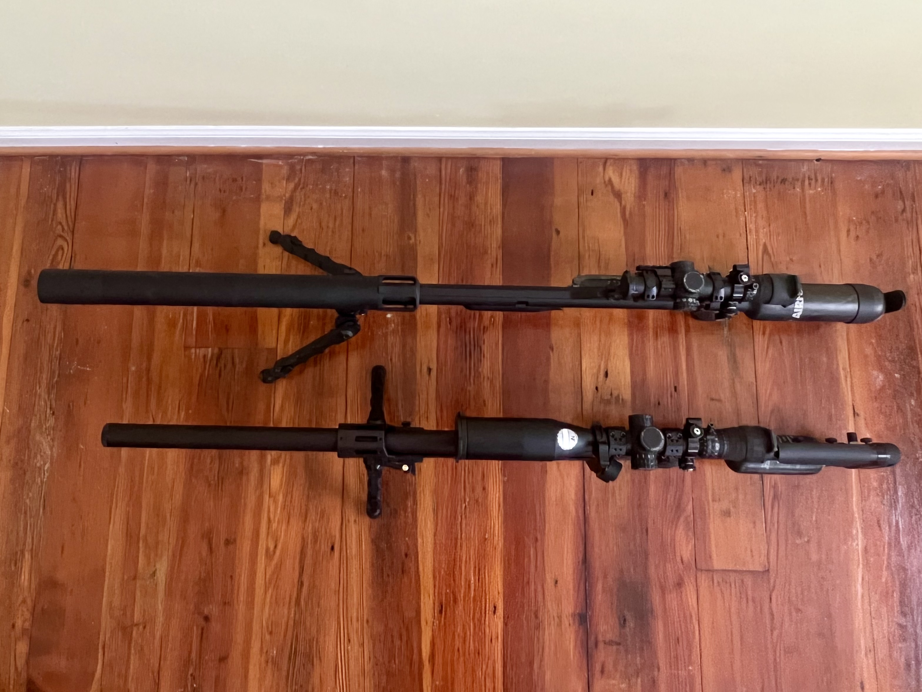

- FX Panthera vs. AirForce Texan LSS:
