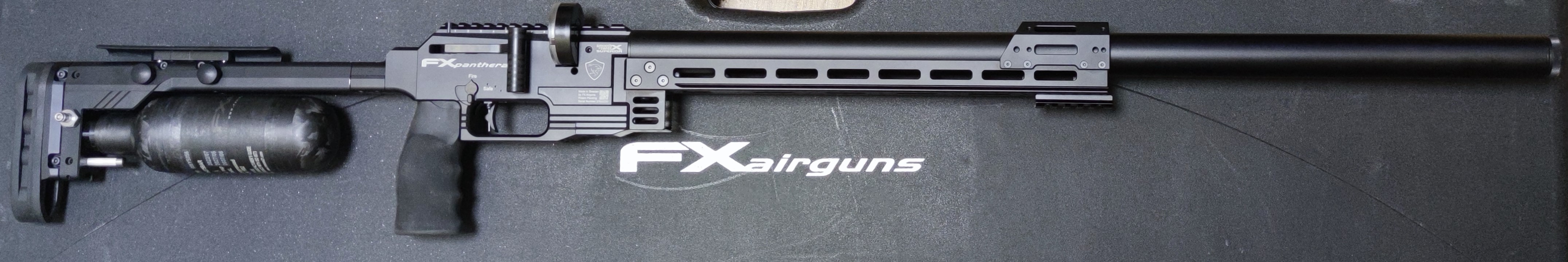

FX Panther no-hype review and tests
Hi, everybody! Let me introduce myself: Nikolay Boldov from Russia. Moscow, won Extreme Benchrest and American Field Target in 2019 (AZ, Extreme Benchrest) and 50 Yard Benchrest, One Gun Challenge in 2022 (AZ, Extreme Benchrest).
A few days ago, I’ve got my FX Panthera in .22 caliber. I consider this gun as a long range benchrest (150 yards) competition heavy slug (.22 40gr) shooter for my purposes.
My experience of slug shooting starts from 2017 when I began my experiments with 40gr slugs in .22 caliber, so I have a bit of experience in this topic.
I will try to describe my experiments, results, observations on this airgun in no-hype style with undoubtable (as much as possible) video proves here .
Technical details on FX Panthera can be found here: https://fxairguns.com/rifles/the-panthera/
Part 1. First acquaintance with Panthera out of the box
I will not describe Panthera’s appearance and it's main features here (yet) as you can find it in other youtuber’s videos. I will share my tests and results here.

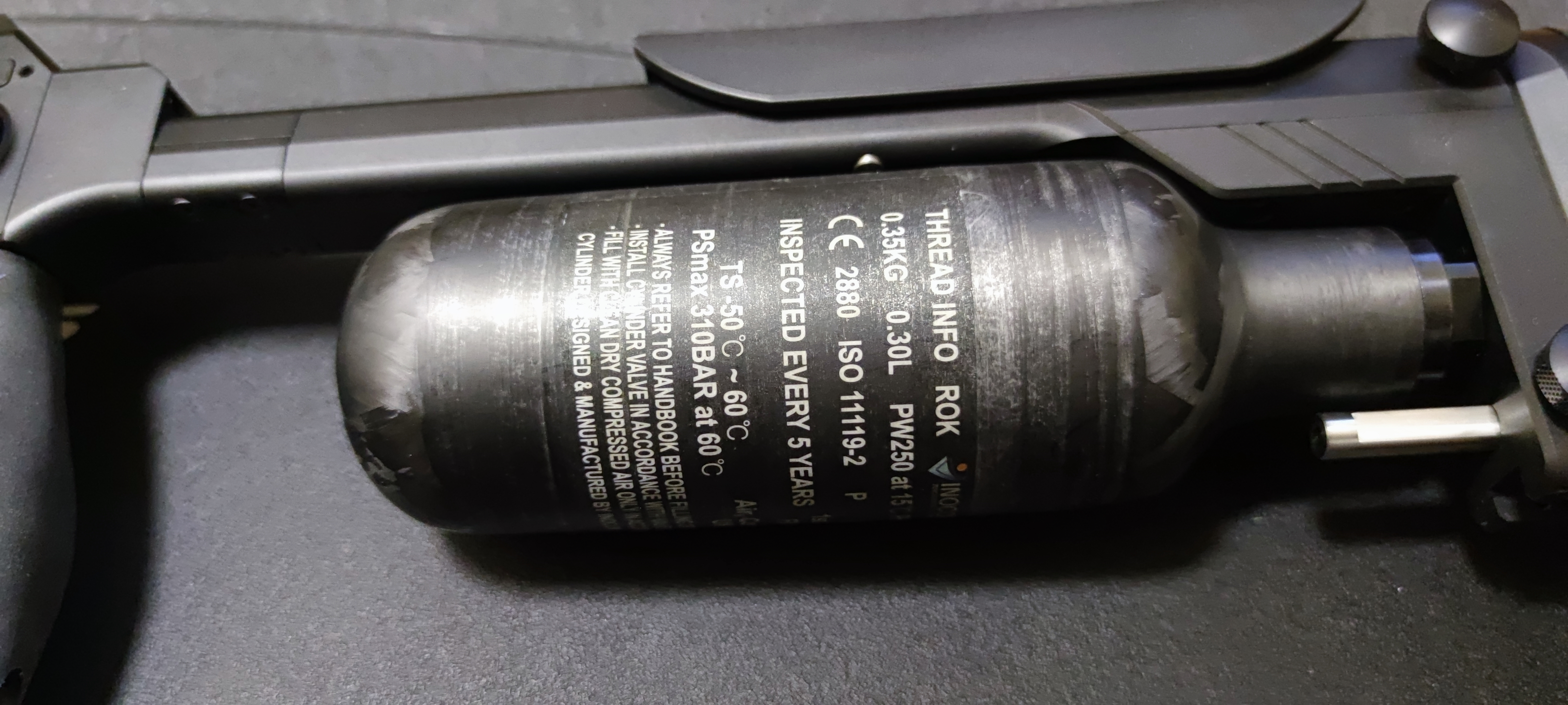

So, the very first thing I wanted to test is what speed and how many shots can this gun give me with it’s 300cc bottle and huge (156cc) plenum.
The result is 25 shots in 250-142 bar with 40gr slugs at the speed of 273 meters per second (896 fps). Average air consumption is 11,3 cubic centimeters of air per joule, that is a very good result as for me taking into account barrel length and projectile weight.
Here is the video prove and the table of calculations:
My first impression.
  • I didn’t expect FX Panthera to be able to shoot those heavy slugs at that velocity (it should be rather accurate according to my experience) out of the box.
  • I really didn’t think that it would be possible to make 25 rather consistent shots from 300cc bottle
  • Really happy to have opportunity to shoot 40gr long (12,5mm / 0,5 inch) .22 slugs out of the box with usual magazine
  • I didn’t think that it would be possible to shoot those speeds with usual tube-like probe. I had to use pin probe for that needs in all my previous airguns.

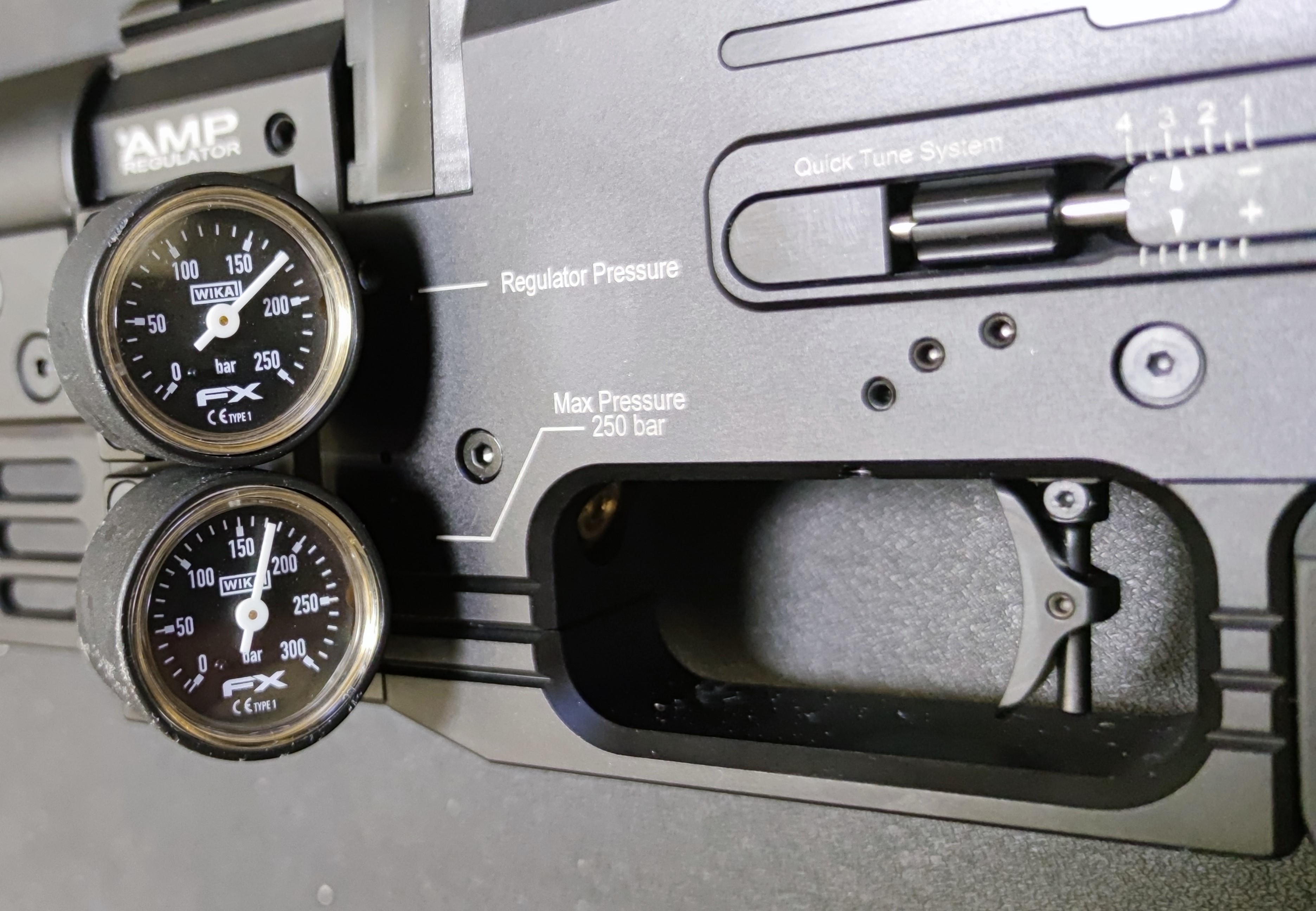

Question: you reg is 170 bars? That seems high without the tungsten hammer, does your speed increase if you lower the reg? Someone said that the 700m version can shoot 35 grain at 1000fps with reg at 135 or 145 bars.
Yeah my 700 is sending a .22 34g at 996-1000 at 135bar iirc. But that is with the hammer adjustment getting close to being tapped.
I thought he lost 142b as his get setting? Maybe I'm misheard/read. Edit: Oh I see in the picture it's that high.
Reactions: qball
Thanks for sharing!
No, my Reg was at 145 at the moment I made the test, described in the first post. The photo was made later, when I continued my studies.
