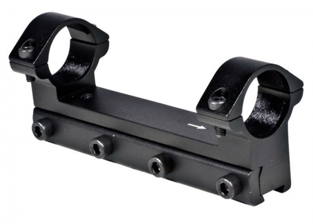

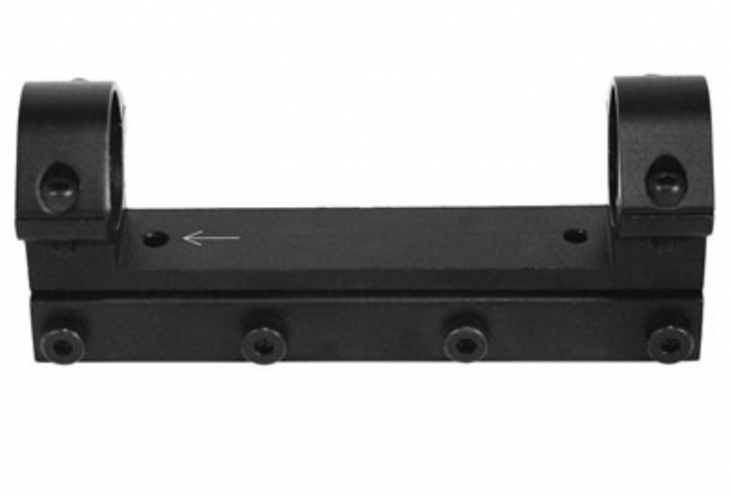

I have FX No Limit mounts on all of my PCP’s, adjusted for optical center on my scopes to my 20 yard zero and love them best PCP scope mounts available in my opinion. But, on my top springers I use the RWS lockdown one piece mount it has a built-in slope for barrel droop, or for allowing more elevation adjustment. They are rock solid awesome on springers with a lock pin! Available in 1” or 30mm. They’re worth more than they cost, very affordable as well.
https://www.pyramydair.com/s/a/RWS_Lock_Down_1_Pc_Mount_w_1_Rings_11mm_Dovetail_Barrel_Droop_Compensation/2406
https://www.pyramydair.com/s/a/RWS_Lock_Down_1_Pc_Mount_w_30mm_Rings_11mm_Dovetail_Barrel_Droop_Compensation/3155

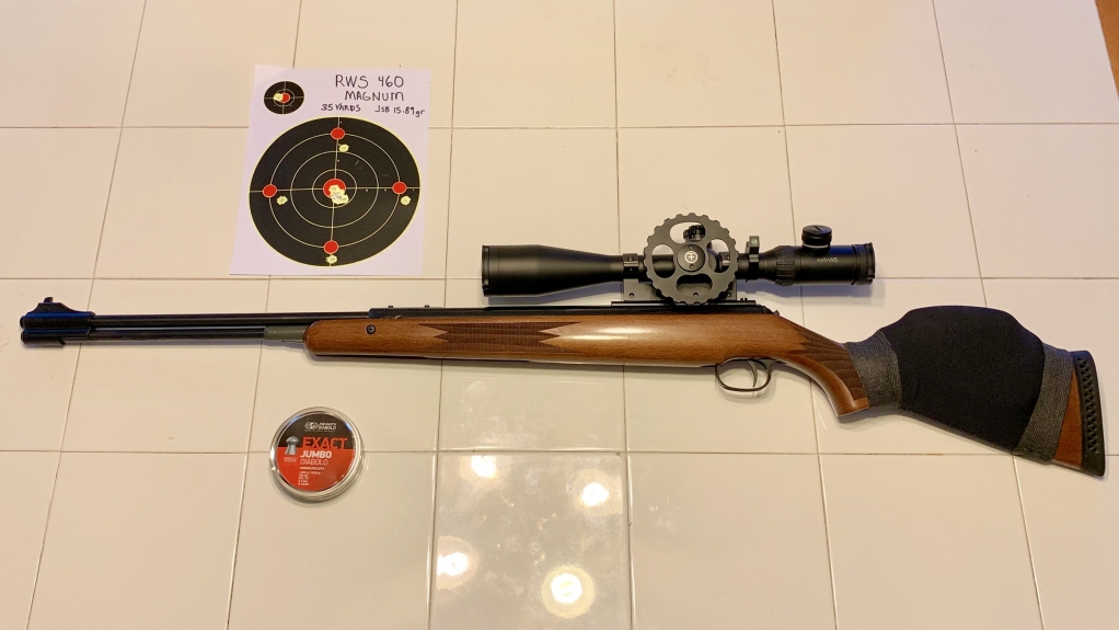

My FX no-limit doesnt work on my FWB 300s with a Hawke Sidewinder 8-32x56..
