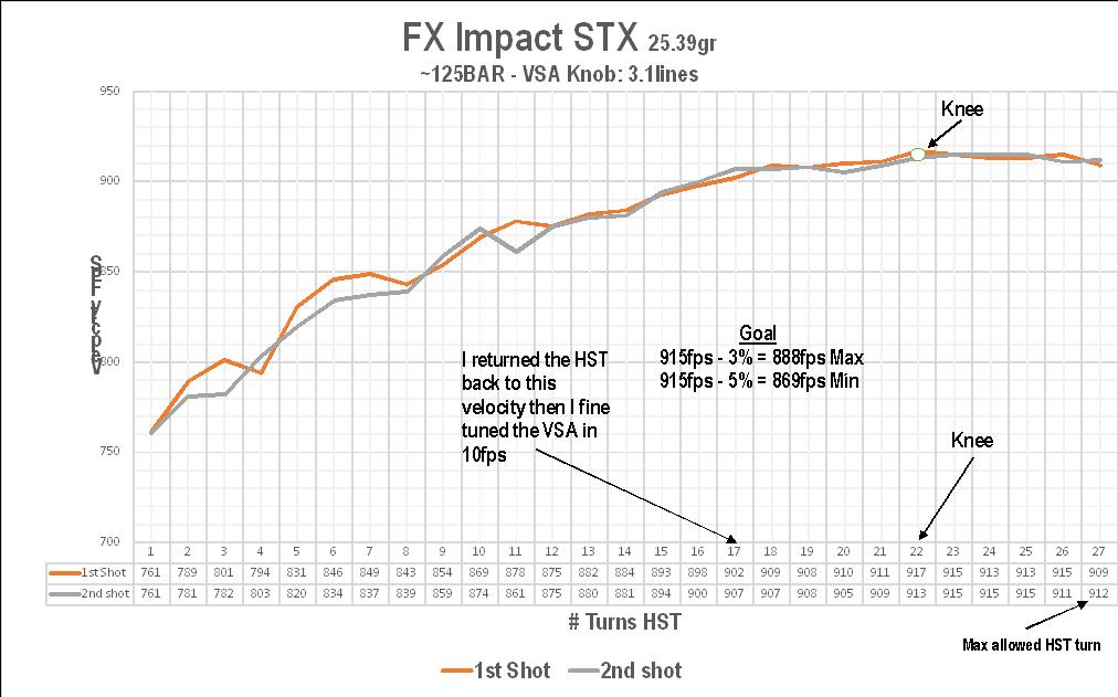

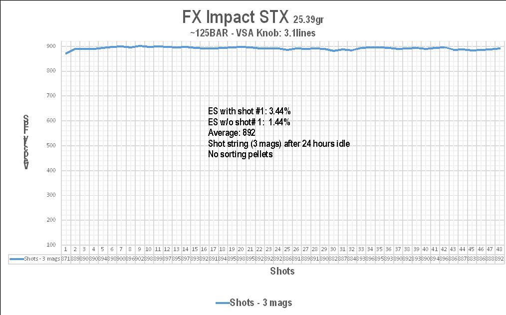

Well, this is a quick update on my recent tuning with your instructions above. First shot still low after 24 hours but not as low as before. However, within a 3 hours idle 1st shot is within ES of 1.44% which for hunting is acceptable. Pellets are unsorted and I think I can reduce ES later on. I am attaching two graphs. 1st is how I tuned. 2nd is my shot string after 24 hours. I am happy with the results and I am not sure if I can improve it since I am using stock FX reg. I kept reg at 125BAR (using FX stock gauges).
Please take a look on it. Also, to others please feel to jump here and add your considerations.

I am not an expert, but I am not sure the term "knee" is where you have marked it, in your diagram.
If the gun is shooting fine, you have probably not found a bad tune. But it looks to me if you go lower on speed with same regpressure, the gun will probably be more efficient with air, and give more shots.
I personally would test some of the lower speed settings also with same reg pressure, just to see how accuracy compares, while shooting on target.

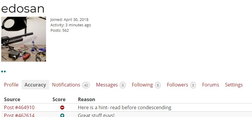

you know what is funny? I just got a negative comment on my profile (accuracy) just for trying to help you... looks like some people care more about egos than solutions.
I am not even English speaking native! , and this guy (the one with the negative comment) is interpreting what I am saying! I really do not care much about it, is just funny. That was very recently.

I am not an expert either and I am learning all these great airguning stuff. So, answering your points:
The knee, as I think, is where I see the max velocity. After that I don't see too much spread and we call that the plateau. If I continue to increase the HST I would see a downslope curve and then I could see clearly he knee curve. However I reached the max HST in my Impact. Please let me know where you think where the knee is. Please take a look on https://hardairmagazine.com/ham-columns/tuning-regulated-pcp-airguns/ by Bob Sterne. That is where I got my rationale behind my graph.
I agree that reducing the speed I could see better air efficiency and more shots. I think -5% is the best tuning according to the tuning guys. However I want my Impact for hunting. That's why I kept it with a higher velocity.
I still need to to check accuracy and see with that tuning the gun is accurate.
