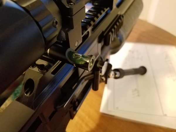

"Menttaliist"Rail's bubble levels may not be perfectly centered and if you don't check them with another bubble level on the gun itself it may produce cant errors rather than solve them.
And check for wind between the target and you, maybe there is no wind where you are but in the field it may be different
So that means it was a human error then? What do you think?
"Menttaliist"If it's one of those cases then yes, nothing to worry about. Have you got what i was saying about the bubble level not being correctly calibrated?
I did check it with one more, but there is always a chanchance I was canting my rifle in the 70 yards test, or some wind I didn't notice.
I did 20 yards test and the group is dead center as the group at 50 yards, that sounds to me that apparently my rifle it's just fine.
I like to use a level that is attached to the scope tube because you set it to read level when the gun/scope IS level so the quality doesn't come into play so much. With a rail mounted level you have to rely on the guns rail being perfectly level AND hope the bubble level was made well enough to sit level.
I had this same problem and a scope level cured it for me... I would zero at 25 yards and my poi was always left at longer distances because I was unknowingly canting the gun by mistake. Very hard to not cant without an anti-cant device. :)
