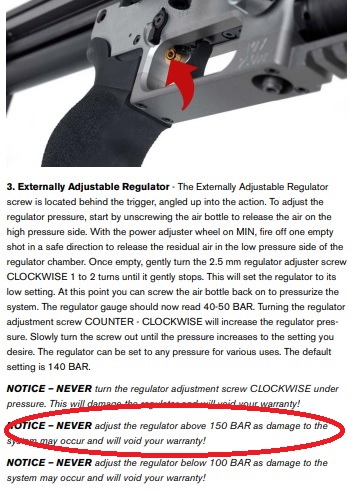

Sorry to read that, but is known that over 150-160 bar is a big NO on the old impact regulators even in impact X (actually is in the manual), you need a high pressure Huma reg for that, or tinker the belleville washers or get the new Mk2, and even with the mk2 and the AMP reg, the recommendation is not going over 170 bar
https://fxairguns.com/wp-content/uploads/2019/02/Fx_impact_manual_ok.pdf
Hi, yes I know it says going over 150 is bad , but I haven't fire it when it went up , I degassed it properly. My gun is serial number fx 178823 and I don't know paying about a hundred pounds weather that would work or not.is the huma reg stronger than the fx one.
