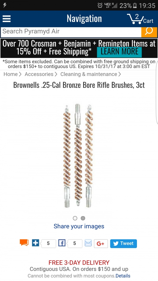

Stay away from those bronze brushes or for that matter any brushes. For many years I shot competitive 22LR rifle and pistol pistol and the only cleaning ever required was a patch pulled from the breech end. In the old days I used nylon monofilament lone but now use a pull through from a British firm (forget their name but they are stocked by AOA) . A manufacturer of custom target pistol barrels once told me that more 22LR barrels were ruined by bronze brushes and cleaning rods than anything else.
Ask 50 people, get 50 answers. I use two methods. Gotta be carful with Bronze because you've got O-rings inside and it'll scratch or score the O-rings.
