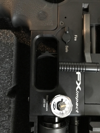

I'm new here and to air gunning. I have read quite a few threads here and need a bit of help please.
I just got my 25 cal fx impact in the mail today, and was super excited. I noticed right away that the pressure was 100 bar for both the reservoir and regulator. The dealer said he filled it to 250 bar before shipping it.
I got a mk4 hill pump as well, so I tried filling it for about 10 minutes. Couldn't get past 125 bar. There was this loud hissing noise coming from the small hole right to the left of the safety switch.
Does anyone one have any ideas why the air is leaking from this hole and how to stop it? I have tried removing the air bottle and dry firing the rifle when it was 125 bar. No dice.

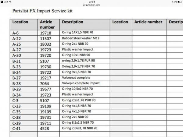

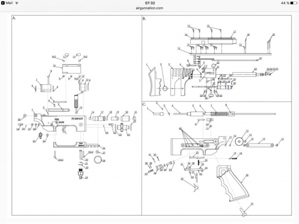

https://drive.google.com/file/d/0B0Ph4Q8M-S89dkNXSFI2VG8xYTA/view
Thanks for the document.
I called the retailer, and he is shipping me a new gun and I will return the damaged one in the same box that the new one comes in. No charge to me. Should be here next Friday. Super excited.
Question: I want to purchase top durability o-rings that I would need for a repair from the "orings and more" website for down the road when the warranty runs out. Is there a complete list with sizes that I can search the site for and order them?
Also, what would be the best lube to use to prevent the o rings from tearing when the gun is reassembled?
Thanks again!

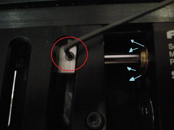

Thanks gixxer ! I will make an order ! Viton should be better yes but this size is not really common unfortunately :S
My actual problem is when i tight too much the grub screw, i have some leak around as you can see on the picture
The only way to fix it in my case is to not tight very much this grub screw but the pellet probe is not fixed it move a little
"Astroxyn"Thanks gixxer ! I will make an order ! Viton should be better yes but this size is not really common unfortunately :S
The only way to fix it in my case is to not tight very much this grub screw but the pellet probe is not fixed it move a little because grub screw is 3mm & hole on pellet probe is probably
Nothing to do with your so called grug screw..
