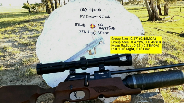

FX Crown showing off at 100 yards.

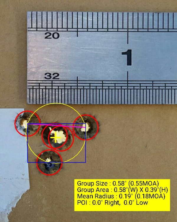

Yesterday after a frost the air was calm for just long enough for this group at 100 yards.

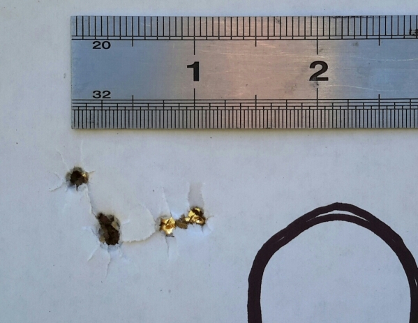

Then the wind drifted in to spoil the next but OK I GUESS.
This is still its best to date.
JSB King Heavies Mk1 33.9 gr.
Skirts sized to .2515 and lubed with bike chain wax.
The replacement barrel (for the one our OZ Post bent) is shooting very well. STX barrel as with all Crowns 1:28" twist.
I clean the barrel with a pull through regularly but with the wax it seems to clean with just one pull. A second comes through just very light grey.
No need for more and takes all of a minute.
Velocity was 850 fps on Max and tp 3, but today I began using 5 and 3 for 840 fps, a little less noise and better efficiency.
Regulator at 130 bar . Gun and pellet fliers conspicuous by their absence.
All good, a great gun, light to carry and rabbit count at something over 230 now. I haven't found anything I don't like yet.
Regards to all, Harry.
