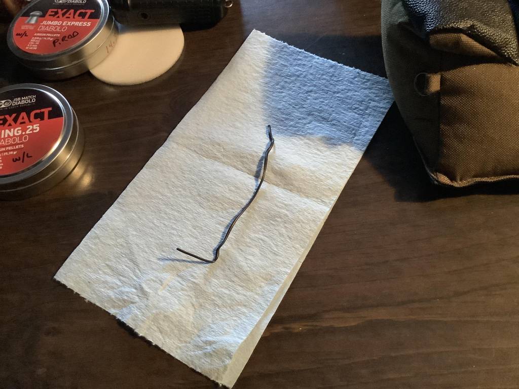

Every place I shoot from I have one of these laying there. Bend it so you can feel if there is one in the chamber.
