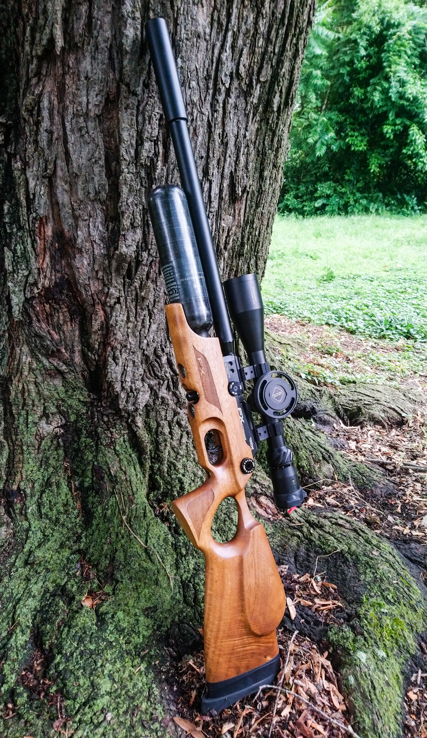

So, tomorrow my stubby barrel arrives for my 1st gen Crown. It's currently a .25 and the barrel kit I'm getting is a .22
So the question is what is the best pellet to use with the stubby barrel. I have a bunch of the 18gn JSB but im not entirely sure those are the best in the new configuration.
The Continuum has the 380mm so I'm hoping someone has experience
