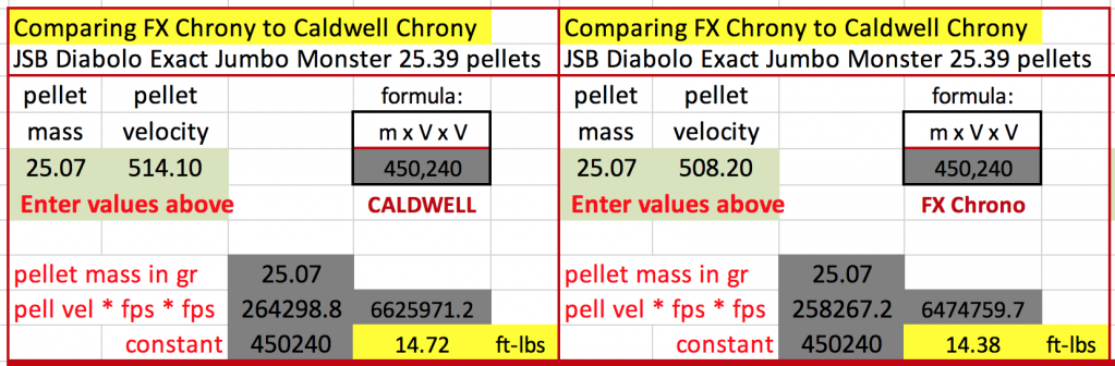

The first table is when I shot JSB Diabolo Exact Jumbo Monster 25.39 pellets. When I weighed 10 of them, they averaged 25.07 gr, not 25.39.
The numbers for the Caldwell are on the left and those for the FX are on the right.

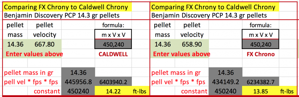

The second table is when I shot Benjamin Discovery PCP 14.3 gr pellets. When I weighed 10 of them, they averaged 14.36 gr, not 14.3.
I don't have a clue as to which one on my chronographs is the more accurate one, I guess I'll go with the Caldwell. because the numbers make me happier.

Exactly. Changes/consistency seem more important than absolute values in this case. And what is the absolute difference? About 1.5%?
For the 14.36 gr pellets the absolute difference in velocity is 1.33% more from the Caldwell chrony. (0.01332734).
For the 25.07 gr pellets the absolute difference in velocity is 1.15% more from the Caldwell chrony. (0.011476366).
