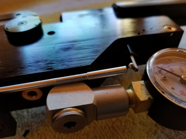

Anywho. While I had them one the phone I also told them about the safety not working. Ernest told me how to fix it. And I did. I know know that I did fix it so it at least engages, but like my first post in this thread explains, it does not function they way it is supposed to. Well, now the safety was working, but the trigger was not!? I took the gun apart again and saw that the push rod from the trigger is not attached to that little piece of rod that triggers the shot. Not sure how to explain it. The little rod with the ball-end was bend out of the way so the push-rod from the trigger would not stay in it. I had bend it back and now it works. The trigger that is.

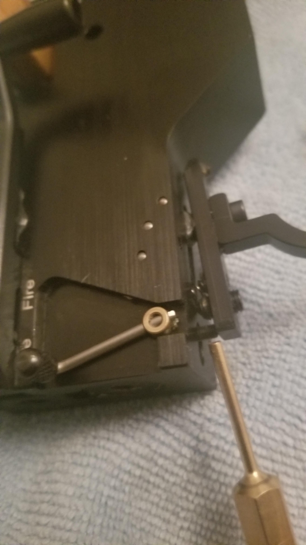

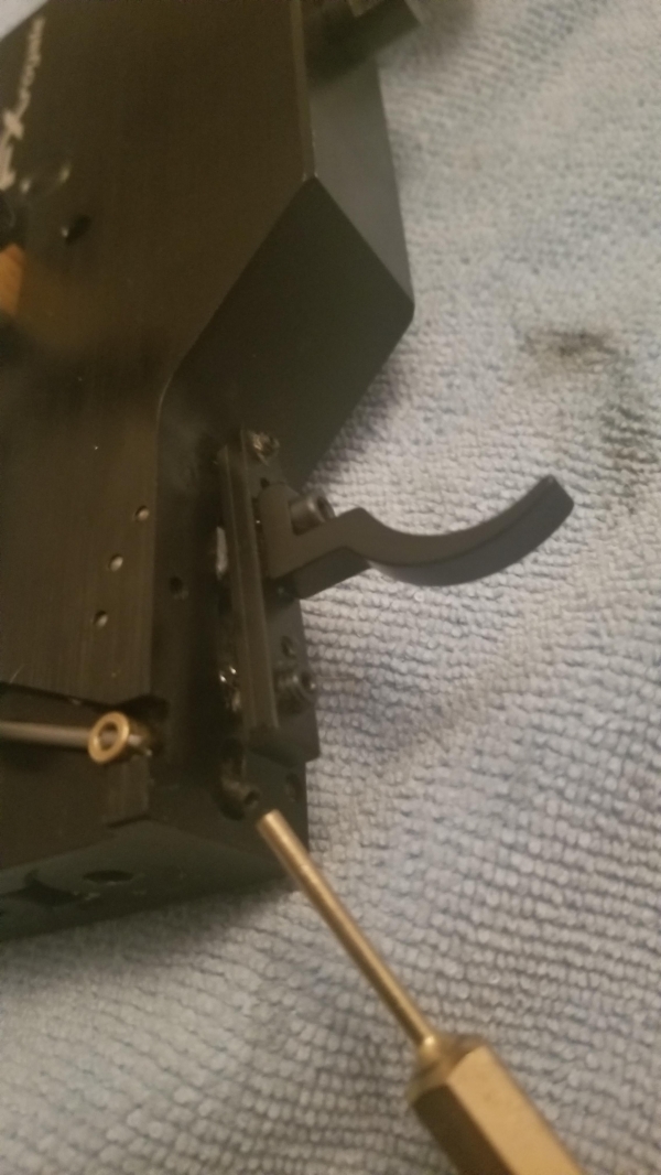

Did you get your safety working the way you wanted? Usually its a turn or two on the long set set screw. If you remove the stock you'll see the set screw I mean. Yes the safety doesn't set if the guns not cocked. I personally prefer to use the open bolt as the safety. All knowing you have to remove the clip if you've closed the bolt once so you dont double load the breach.

Yeah mine was set too long originally too, it wouldn't clear the trigger plate. Turned it in a bit and all is good. I rarely use the safety, only cock before i shoot and if the shot isnt happening i just uncock it.
Pointing at it, maybe its a bit different on bobcat.

No one is talking about other screws, were talking about the same screw. Yeah see what you can do with it lol.
If you adjust the screw I took pictures of earlier, you can adjust the safety to your liking, if I unscrew mine a little bit it will no longer go under the trigger plate with it being uncocked. It's seriously a 1 minute job, its not difficult.
You last had it so it would go into safe both cocked and uncocked, so just a little bit more counter-clockwise and it will only go into safe when it's cocked.
