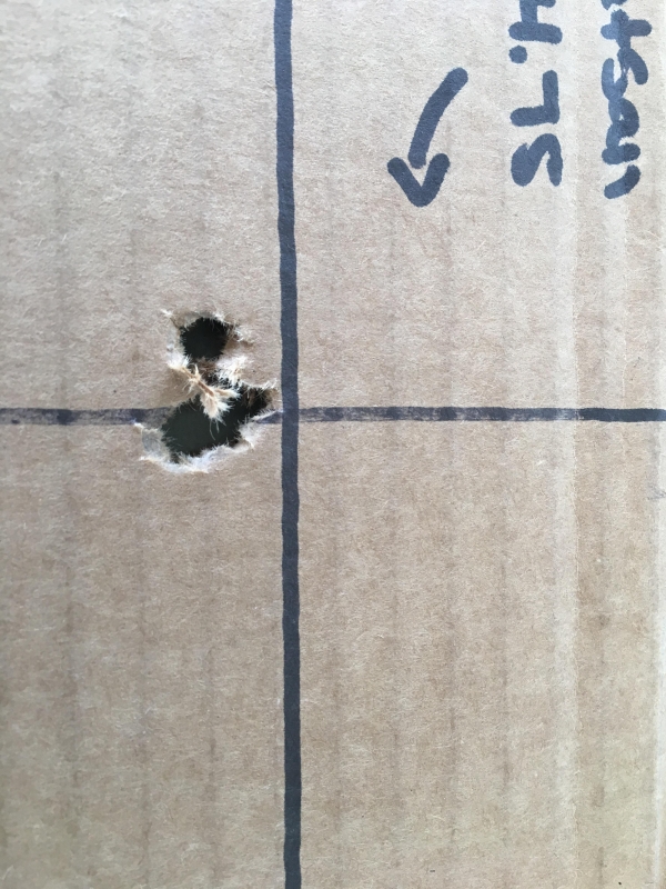

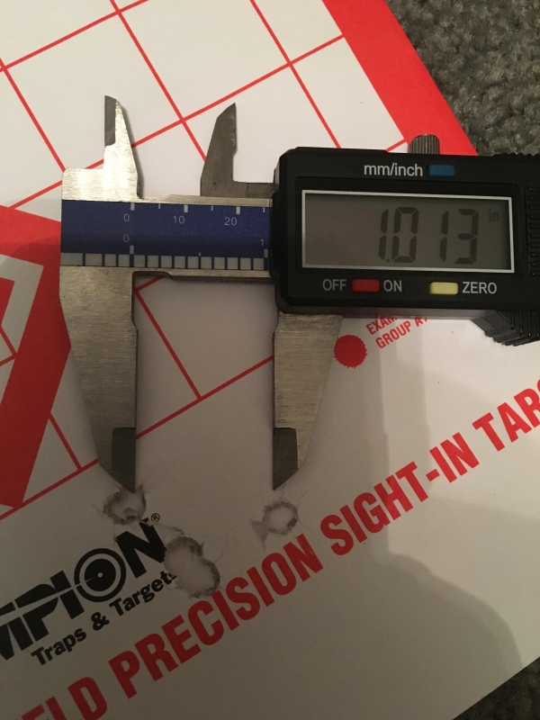

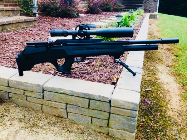

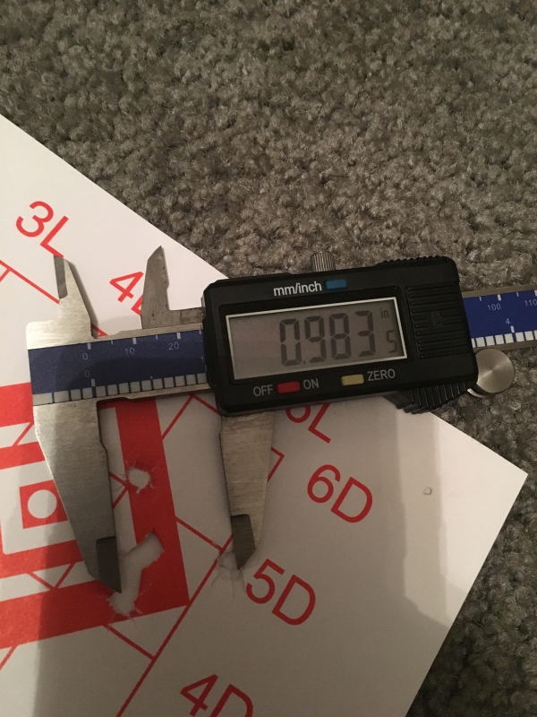

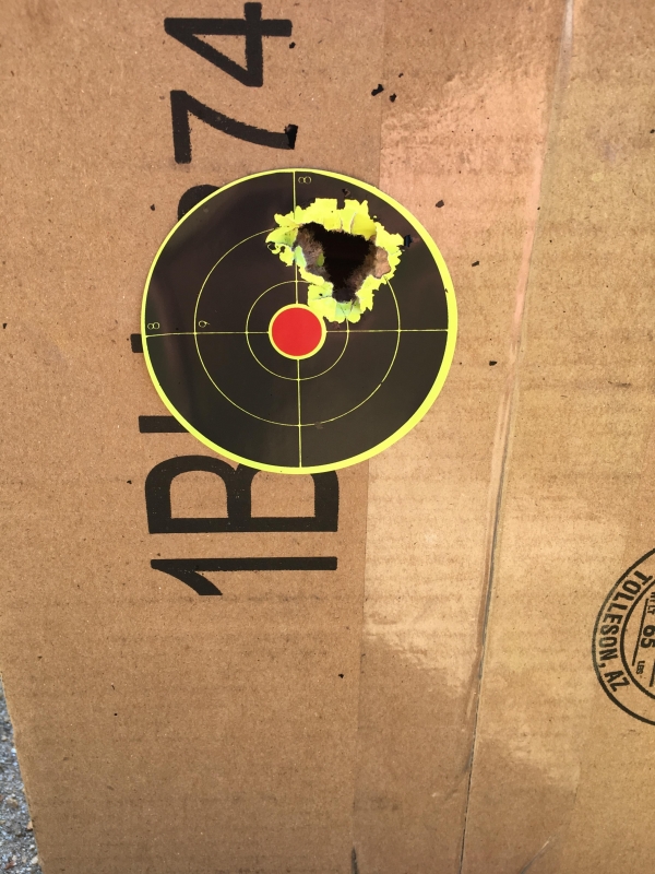

 I was able to finish the shroud on the bobcat, it turned out quiet nicely I think. I was also able to do a few more groups. I think the 700mm on the bobcat is a real winner and as of now I’m very pleased with the results. The 1st picture is the gun with the completed shroud. 2nd picture is a full magazine at 50yds with jsb 44.75 with one shot that I know I pulled. The 3rd picture is with the jsb 50’s 6 shot group at 100yds. And last but not least the 44.75’s at 100yds 6 shot group.
