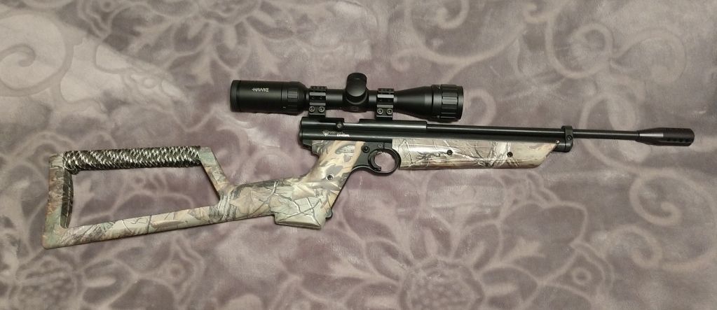

Additional pumps after #12 did not get much harder, and the FPS gain per each 4 pumps up to 20 was so minimal that it made the effort not even worth it. I thought at first that I had over-lubed it, so I tore it down, replaced O-rings, cleaned and lightly re-lubed. That didn't help at all.....and after about 50 shots I blew another piston O-ring.
At that point I said screw it and went back to the original piston with cup seal, and swapped the flat face end of the modified valve out for the cone nosed end of the original valve. Also got rid of the BOSS TP and went back with the original TP that I enlarged a bit to correspond with the modified valve exhaust port and sealed it on both ends.
She shoots really good now at 525-530 with 15.89 Hades and 16 pumps. Could probably get 600 with 20 pumps but I don't wanna push it. I'd love to see 600fps with CPHP's but I don't see any reasonable way to get there and still keep it dependable. I plan to take this gun on canoe/camping trips and on lengthy bike rides......so I don't wanna be blowing O-rings or seals.
