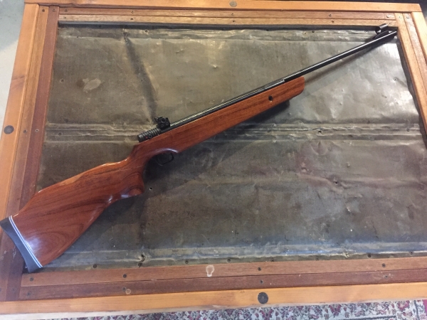

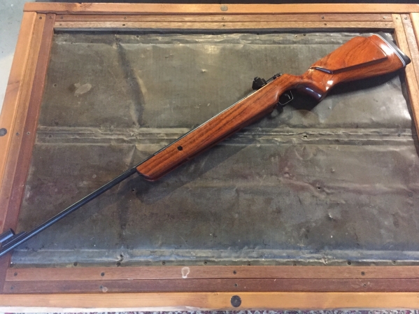

i decided to endeavor in fixing the stock just yesterday. Began the process and it’s going well. Seams are still visible but I believe it will hold as I placed three sections of 3/8” all-thread into the stock in direction of grain, and glued pieces together (pita). I’ll post pics of the work when complete. Pretty happy thusfar
It was broken in two pieces at the wrist. Repair job is solid. It’s grouping about where I’d expect at 35yds coupled with my poor eyesight. Overall,
