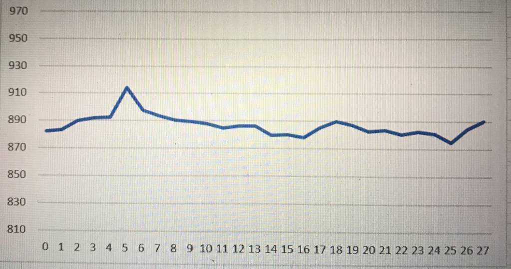

However, unlike in the video, my average velocity did not jump up and down initially before leveling out and then dropping off.
I included a picture of what my velocities did. I started off with the hammer spring adjustment screw maxed out and backed off a quarter turn each shot.
The video recommends setting the hammer spring where the velocity is someone consistent. I didn’t have much to chose from so I set it around shot 23.
Afterwards, I took a 15 shot string with an average velocity of 878, an extreme spread of 11.5 fps, and a standard deviation of 2.85.

Is a spread of 11.5 acceptable and a standard deviation of 2.85 acceptable?
Did I possibly do something wrong while adjusting the hammer spring since the velocity did not level out like in the video?

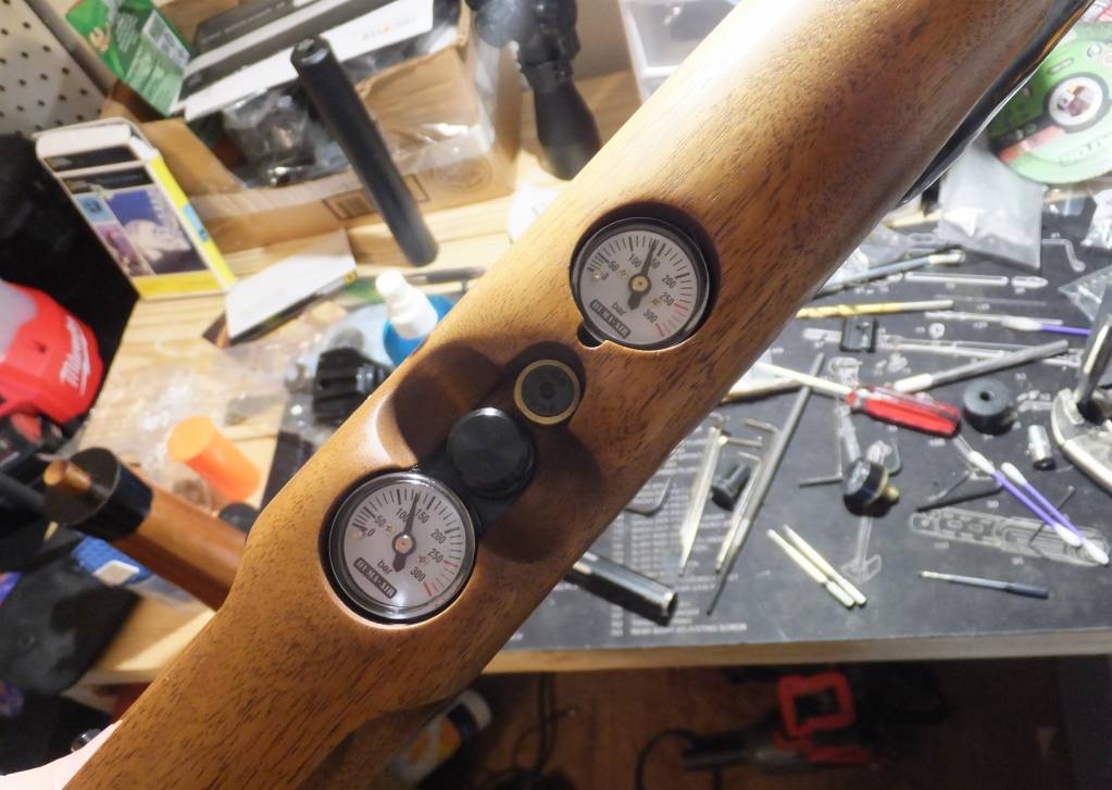

Ok, so, on my regulated guns I often settle in around 135 bar. I had thought I was in the 135 bar range on the Crown. But I recently knocked my gauge out of whack. Leading me to suspect it was never right in the first place.
Well, I've been shooting blind. I did get some huma gauges in (after trying a new fx gauge and it being bunk)... took the time to install them just now.... It actually is at 135 bar that I'm right in where I'd like to be. But I can also get the same power output around 125 bar. (of course with longer dwell time) 130 bar is pushing 18.13grs at 950fps thru the ported 380mm barrel 😲 this is not a mkii Crown. 135 bar is seeing 915-920fps
