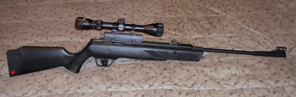

I have exactly shot 300 rounds through my Elite II since I got it over a week ago.
It is zeroed in and shoots pellet hole into pellet hole 99% of the time.
Pros: Price, design, and accuracy.
Cons: The factory scope was junk. And the stock screws kept
coming loose after about every 30-40 shots. I removed all the screws
and put blue Lock Tight on them and put them back in.
Also: the trigger is kind of lame until you break it in and and adjust it.
Adding the Bushnell 3x9x40 scope made a major difference
with accuracy. I also added a see-through Picatinny riser mount so I can
use the iron sights at close range if needed.
I tried many different brands and weights of pellets. The Crosman Premier
7.4gr. Pointed Pellets beat them all.
Merry Christmas to everyone here..!!
AK.
Just got this gun myself. It shoots for sure but the scope is utter junk. In fact when I turned the turret for windage it just turned super easy without any clicks like the elevation turret did. I knew right away it wouldn’t hold zero. It didn’t. That part is trash but the gun itself is worth the 100 bucks. How many stock screws are there? I know the two on the sides of the forearm work loose are there others to worry about ?
