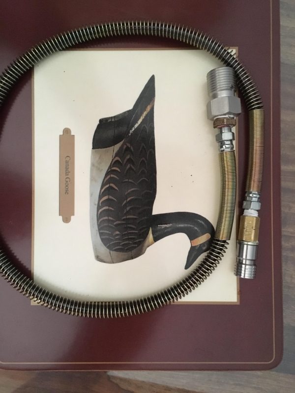

Here is my setup for filling at the fire station from a scott fill station at the fire station. The most expensive was the adapter purchased from Airgas CGA 347.
it cost me 35.00. Probably could have got it cheaper if I looked around. The hose I bought off e-bay and the rest of the fittings were from Home Depot. I think I had 55.00 in th whole setup. Special thanks to the fire department for allowing me to fill. They wouldn’t take any money.
Be carful the Home Depot fittings are made for low pressure there is a chance you can have a blow out and hurt yourself.

Question for Ashes5 how are you bleeding air from your system? Like others said you should never get any fittings from home depot because they are normally rated for 800 psi. Instead, always get them from a hydraulic fittings place. They will have a minimum pressure rating of 5000 psi and normally they are 10000 psi rated. I have built several systems with bleed valves and 6000 psi gauges and the parts cost around $70-75. But I am sure they are safe.
"blackdiesel"Question for Ashes5 how are you bleeding air from your system? Like others said you should never get any fittings from home depot because they are normally rated for 800 psi. Instead, always get them from a hydraulic fittings place. They will have a minimum pressure rating of 5000 psi and normally they are 10000 psi rated. I have built several systems with bleed valves and 6000 psi gauges and the parts cost around $70-75. But I am sure they are safe.
BlackDiesel thats right I should of noticed . If you replace that brass coupling with this bleed valve you should be OK
https://www.breathingair.com/Product/Fittings-Accessories/Valves-and-Quick-Connects/Valve,-Bleeder.aspx?ProductID=5491
