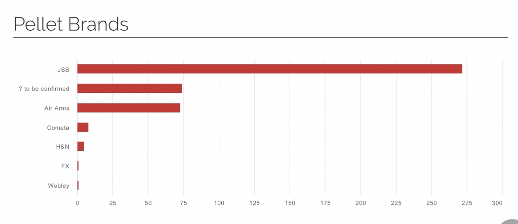

field target pellet selection at major competitions
It certainly seems that competitive field target shooters like JSB/Air Arms. The WFTC 2019 site shows the selections of those who have registered, and apart from "TBD", the Czech pellets are dominant, as they seem to be in all the similar reports from major competitions.
https://wftc2019.com/shooters-and-equipment/

Id think you d get a better "view" if you included say, the last 3 years of data from all the matches (at least that posted this data) in the US. Jsut relying on 1 international match is going to skew the results toward pellets readily availabe "over there"
Hello, Dan, see link below my earlier post about the WFTC 2017, I tabulated those online reports, and found JSB to be used overwhelmingly. Field Target is much more popular in UK (and in many other European countries) than in USA, the best shooters these past few years are Welch. And they have ready access to a big variety of pellet brands. Most all of my acquaintances in FT competition in Texas and NC shoot JSB or Air Arms.
https://www.airgunnation.com/topic/pellets-used-in-field-target-competition/#post-274666
And I have seen similar reports with JSB dominating in US competitive shoots for benchrest.
Tom - I do agree that JSB still has issues with consistency lot to lot. And I hope that H&N will indeed step up the competition. I believe they are the most likely major manufacturer to implement the process controls we'd like to see.
Dan, this recent FT match is not a major, but note that several of these competitors are quite experienced, and can easily obtain any pellet they might wish.
27 competitors, 26 shooting Air Arms or JSB. I stand by the original post comment. AA/JSB currently enjoys a predominant position with competitive airgun shooters. The other pellet manufacturers are nearly shut out.
https://ohioft.wixsite.com/noa-twinoaks/post/winds-torment-shooters-at-n-o-a-second-match
!st of all,,Thx Pelletgage for the info. Are'nt a couple of those brands made by the same manufacturer, I know JSB makes the pellets for AirArms and probably FX. The difference being slightly altered percentages of ingredients used to mix in with the batch of lead. And availability may affect what gets used more. PA does'nt carry FX pellets,AoA does[which I'd like to try by the way] but I buy exclusively from PA. I just don't like the idea of the shipping hazards for the distance. AZ to OH
