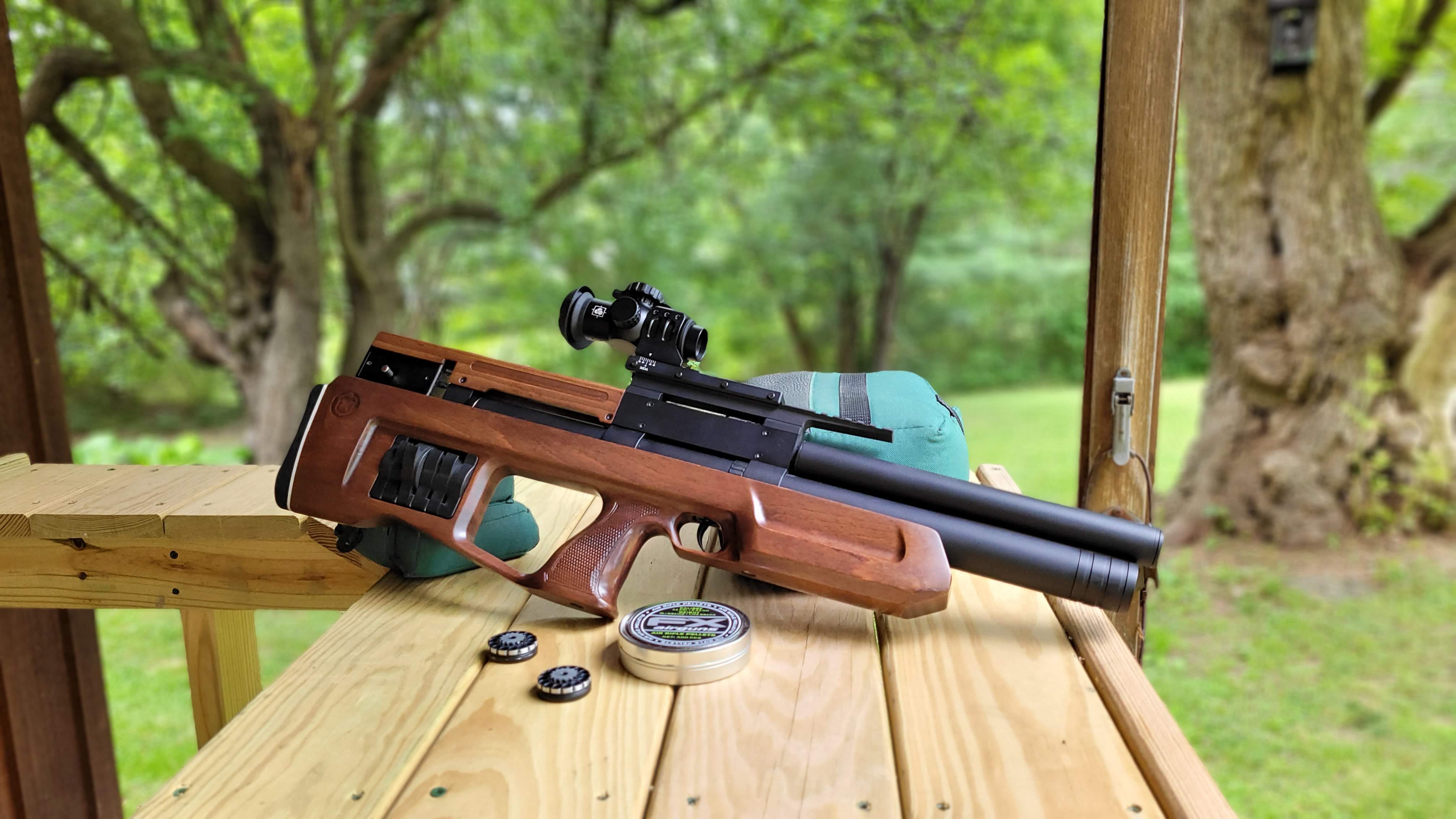

This is a .22 Cricket II with a 450mm barrel. I also am fortunate enough to have a .22 Cricket II Tactical (600mm barrel) and a .25 original Cricket (600mm barrel).

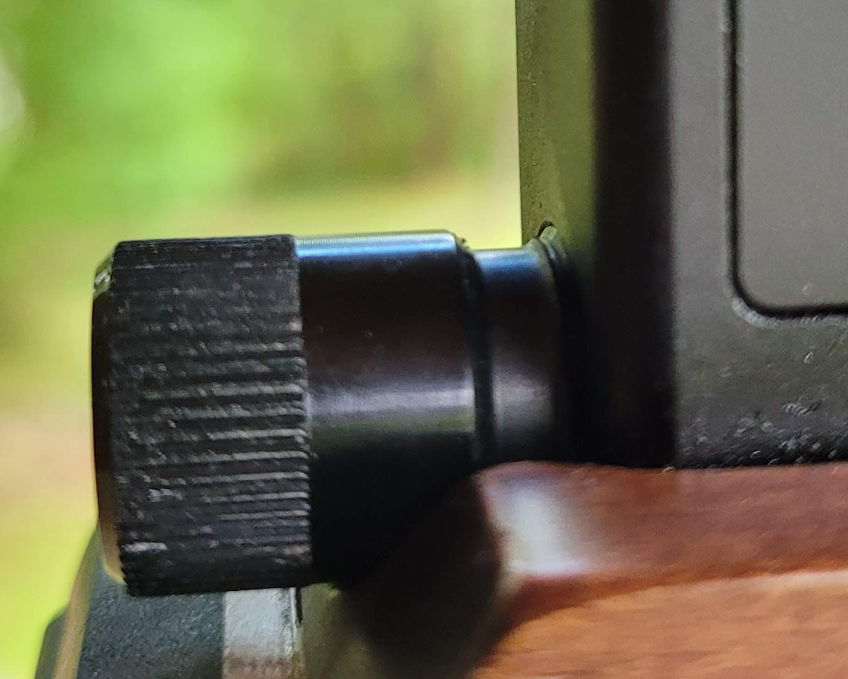

By today's crazy standards, this Cricket II at about 37 fpe with 18 grain pellets, is not a huge powerhouse. This tune is running the factory reg pressure (presumably about 125 bar or 1813 psi) and I just brought up the hammer spring tension to max it out and then back down a bit and it settled on a speedy 960 - 970 fps with FX 18s. It's hard to know where you are in the HS adjustment range, so here's a pic:

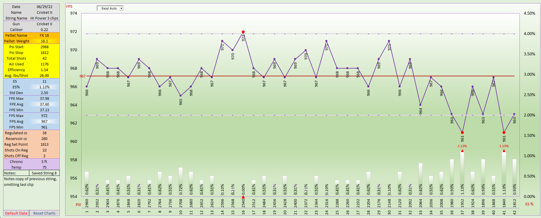

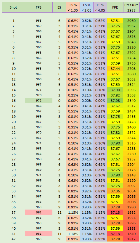

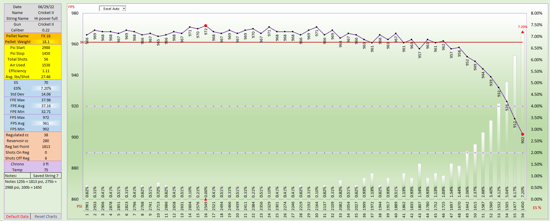

Yeah, this is a bit "hotter" than what's best for accuracy - I think that's more like 930 - 940 fps with this gun, but I was getting really excellent consistency with this stout hammer spring hit. Check this 3-mag (42 shot) string out. I was pretty surprised by the efficiency number here at this power.
You can see it drop off the reg shooting the 4th mag (56 shots):
