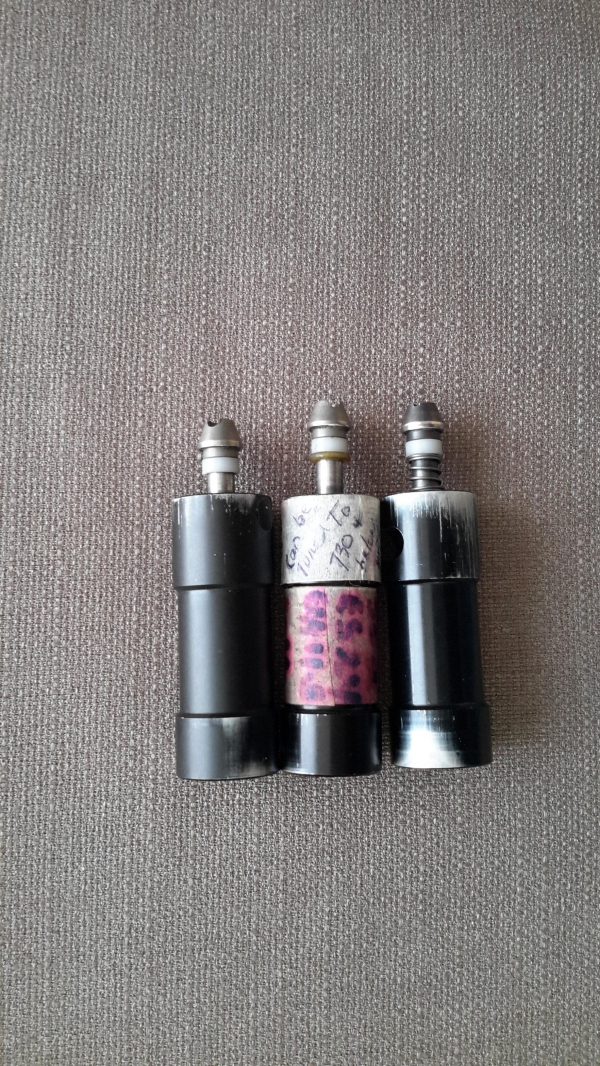

Here are some "short spring" hammer modulesI modified in 2005 for my RWS Excalibre/FX 2000.
The first pic #1 shows three hammer modules with hammer stems protruding with three different free flight gaps and one with an external light spring also designed to counteract any secondary positive hammer return " bounce". I made and tried many springs before getting the free flight gaps somewhat correlated to different power levels to give efficiencies down to 9+ bar-cc/fpe which is still a solid benchmark today.
Pic #2 shows the relationships between the module shells, the hammer rods and heads (the rod screws into the head as seen in pic #3), and in some units I incorporated an inner weak spring and external "o"ring as an auxiliary buffer to further cancel hammer bounce.

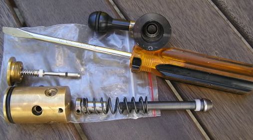

Pic #3 shows the rest of the valve, valve stem in relation to the hammer; and the adjustable hammer stem which screws into the hammer head. In the background , past the screwdriver, you see the module shell end- on with the hammer bolt projecting to our left.

Of interest here is that the hammer cocks on bolt closure, forcing the module forward after trigger engagement to compress the internal spring. The shorter springs enabled the system to operate just as the OP has described above and to eliminate hammer bounce or repetitive valve openings that waste air.
Fredrik Axelsson marketed these rifles under various names, as Tarantulas in USA. It was his vision in incorporating the adjustable hammer stem to allow for adjustment of spring preload, with the original full length springs, that allowed my short hammer springs a further fine adjustment of the free flight gap.

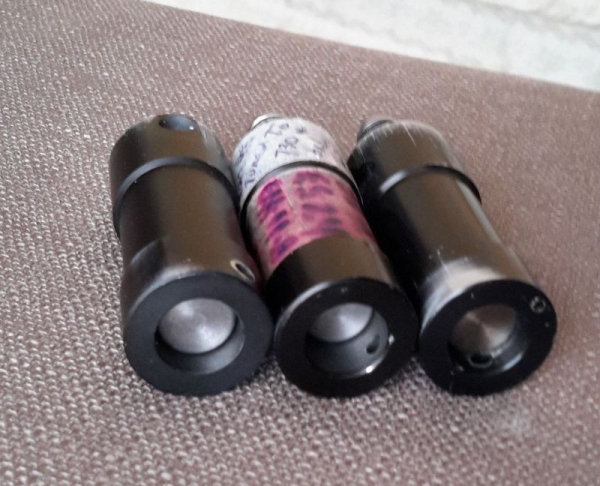

Pic #4 shows a range of free flight hammer gaps from the front end of the modules

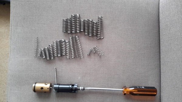

Below: some of the experimental springs made from various gauges of piano wire; and the whole unit aligned.
It was all trial and error but the results were quite spectacular at the time.

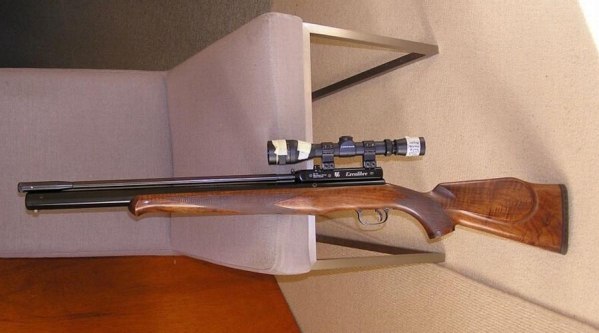

The rifles are pretty. They were the first to shoot sub inch 100 yd groups from 2002 forwards. This one has shot over 70 such groups. It is unregulated .
Note that all Fredrik's FX rifles since this one have free flight - a more recent descriptive term - hammers including the present Crown etc.
With thanks to the OP for your indulgence of this little bit of relevant history.
Please expand the rifle pic to show what was being made back in 2000. Is't it pretty. .... . Kind regards, Harry inOZ.

Another note re-the Excalibre/Tarantula: In the pic with the screwdriver one can see how the HS preload was enabled from outside the rifle. The nail, shown protruding from the module, goes in through the rifle casing and inserts into the hammer head to hold it located while the screwdriver is inserted through the back of the action. Thus, with the hammer head located, the hammer rod can be screwed in or out to either (1): vary the preload on a full length spring, or (2): vary the free flight gap, which is more relevant to the OP.
Again, in relation to your explanation of the use of lighter rating springs, one pic shows a very long weak spring, which without the short heavy spring, was an attempt to exploit the valid point you make above. I did conclude that the shorter reverse-wound inner spring matched to the strong short outer spring seemed to have an advantage in slightly reducing velocity spread. But the biggest factor in that regard was the facility on the rifle to also externally vary the transfer port cross-sectional area with an adjustable interference screw. Not only does that allow for another velocity/power tuning interaction with hammer preload adjustments, but it can slightly reduce the difference in velocity between the shots of highest velocity and those of lower velocity thus reducing the spread.

Ha ha, those were only a few of the bucket of springs I wound!
