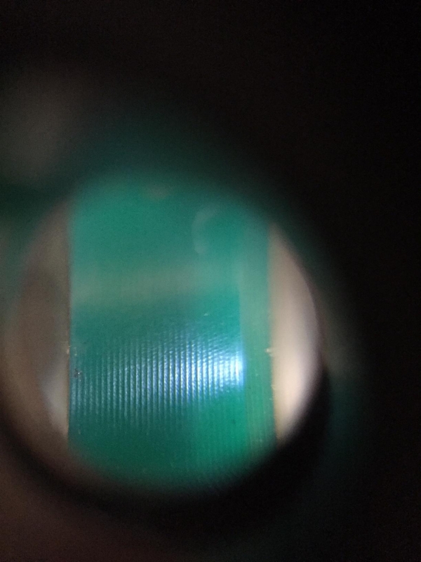

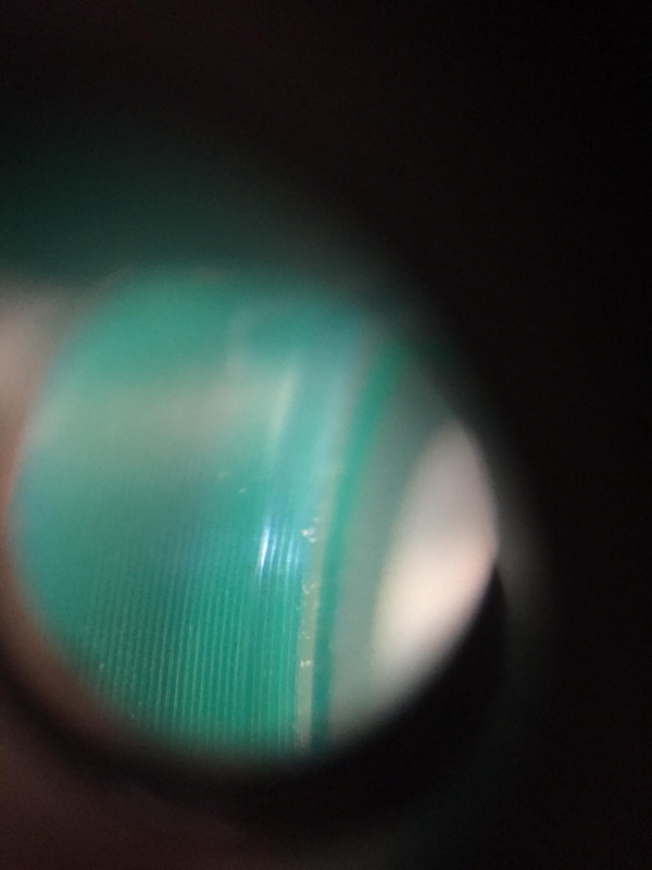

So I just dropped in an ARH Apex piston seal, shot 100 rounds and getting an average of 70 FPS less than what my old dinged up OEM seal is doing.
I'm wondering if it has anything to do with the way the seal is manufactured. The OEM seal looks like it's cast and has a smooth surface. The ARH and others look like they're turned on a lathe and have a ribbed surface.
I read somewhere that when standing the piston cylinder on end with the piston installed and extending out, it should not fall into the cylinder under its own weight.
I looked on YT on sizing a seal and didn't find anything. How are you doing it?
Actually, the old OEM seal takes more force to push in than the ARH and Vortek seals and it's the best performer.
"Butch"I put the seal on the piston and chuck the stem of the piston in my drill and slowly turn it on some 400 grit sand paper. Test often because you can not add it back on after taking it off.
I'm kinda doing the same thing with the ARH seal. Except I'm using 1500 grit and just trying to knock down the ribs at very top of the seal edge where it breaks over into a 45* angle toward the face of the seal, to make that edge butter smooth, without compromising that crisp angle. As that's the sealing edge of the seal with the cylinder wall isn't it?
